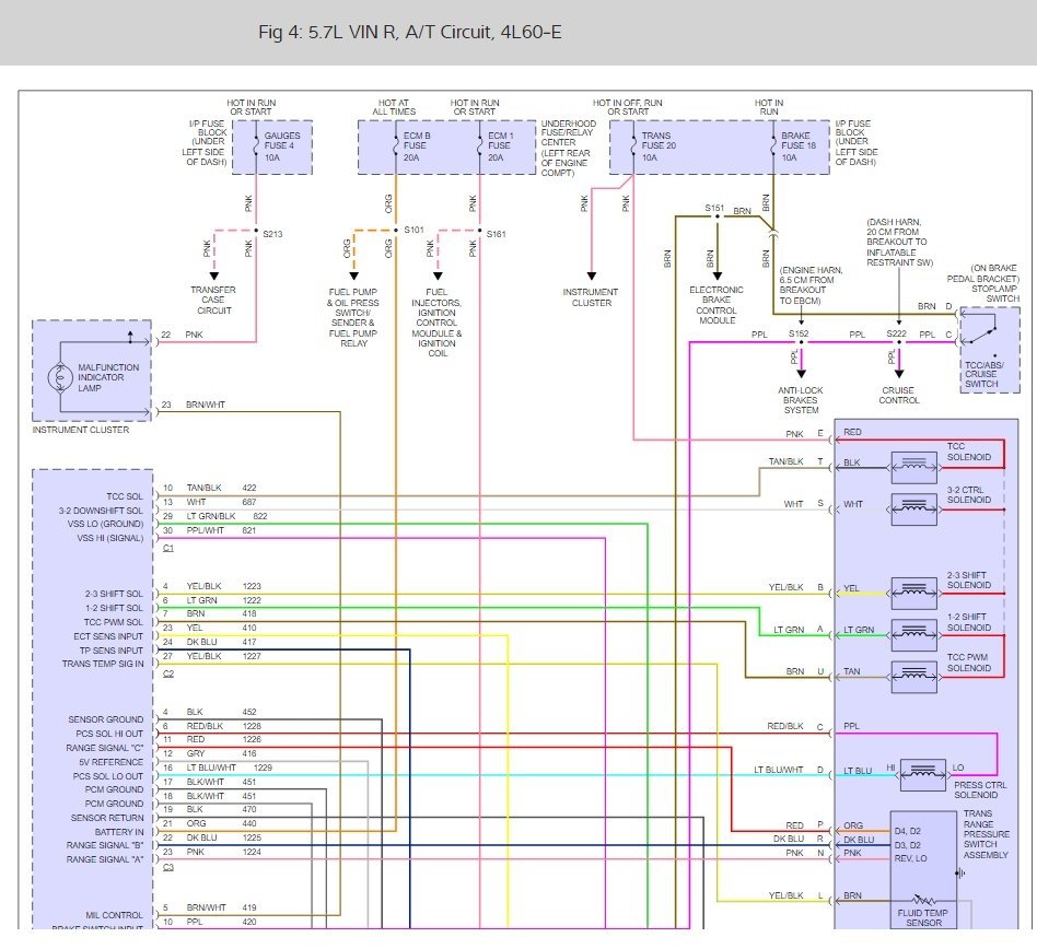

Transmission will not shift into reverse
ROB357
I changed the fluid and strainer still same thing

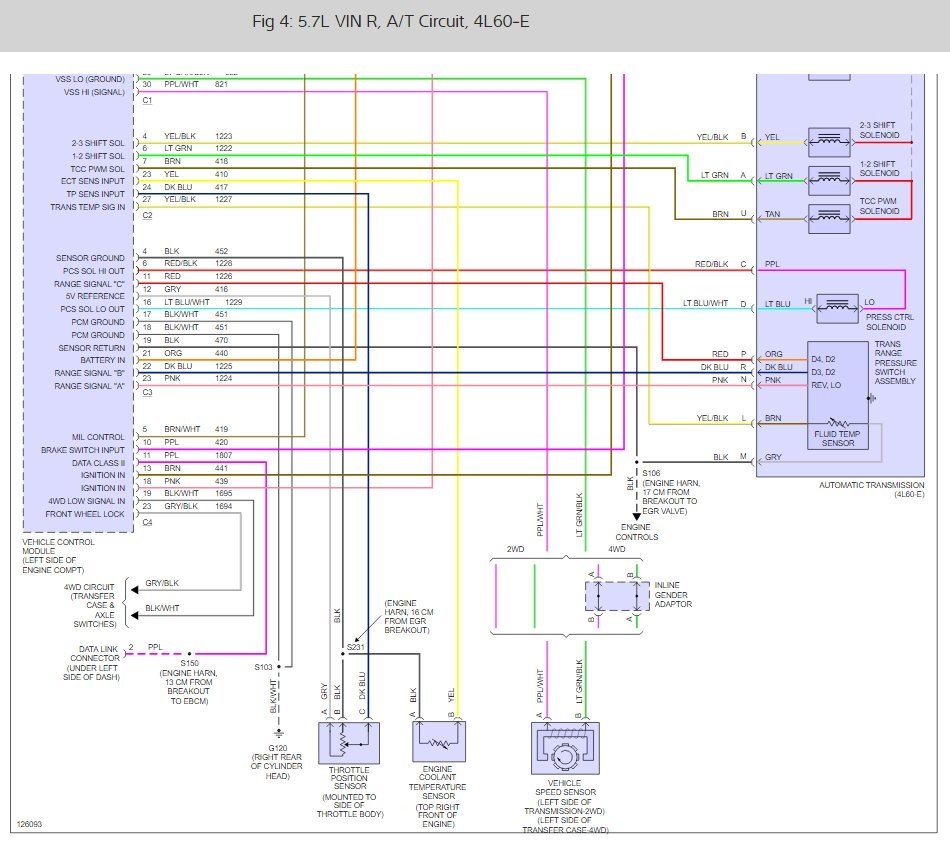

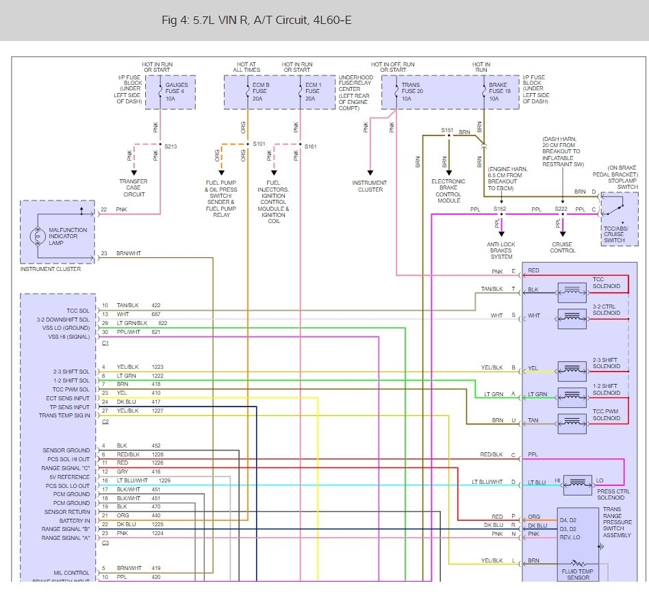

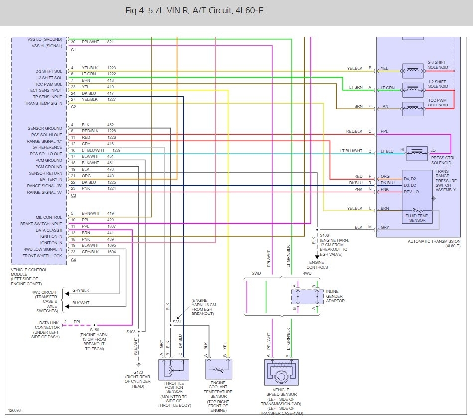

ROB357
How many shift silenoid are they in there
Tuesday, June 6th, 2017 AT 11:34 AM (Merged)
KEN L
  • MASTER CERTIFIED MECHANIC
  • 55,291 POSTS
Here is a wiring diagram so you can see all of the solenoids and be able to test them.
Please run some tests and get back to us so we can continue helping you.
