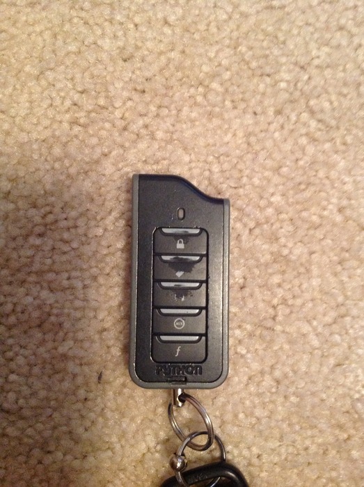

  • 2007 GMC YUKON
  • 100,000 MILES
My car starter quit working. It was installed after we purchased the vehicle ( which was about 4 years ago). The brand is Python. I checked to make sure the switch by my knees on the drivers side is "on" and it is. I also changed the battery in the remote and it still doesn't work. Any ideas what else it could be?
Monday, May 1st, 2017 AT 10:12 PM (Merged)
WRENCHTECH
  • 20,761 POSTS
You will have to contact the aftermarket manufacturer on that issue.
