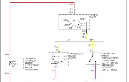

My 95 Gmc Yukon Wont start when I turn the key to the on position I have power throughout the car exept the instrument panel and it will not start the car. I can jump the starter to get the engine to crank I just havr no power when I turn the key to start. Any help is appreciated thank you in advance.
Monday, November 1st, 2010 AT 2:46 PM
7 Replies
JDL
  • 16,098 POSTS
I'd have to check feed to and from the ignition switch. Battery has a full charge, all battery connections coming and going, clean and tight? The diagram is part of starter circuit, the purple wire, lower, goes to starter solenoid S terminal.
https://www.2carpros.com/forum/automotive_pictures/170934_yukon_starter_circuit_1_1.jpg

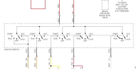

JDL
  • 16,098 POSTS
The red wires on top of switch should be feed to the switch. The wires off bottom of switch are feed from the switch, goes hot with key on, or crank, could be both.
https://www.2carpros.com/forum/automotive_pictures/170934_yukon_ignition_switch_1.jpg
Monday, November 1st, 2010 AT 4:25 PM
AMEZ
Thank you for the info. One of the incoming feeds was dead and I realized its was just a blown fuse. At first glance I could not tell the fuse was blown until I tested it. Problem solved thank you for the quick reply.
