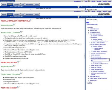

Ok now I have had this happen a custumer comes in has no check engine lite but when scaning I retreve codes I recomend going to autozone and have hem scan for codes anyway here are some of the couses for your hard start and rough idle if you can't read clear e-mail me and I'll send to you
https://www.2carpros.com/forum/automotive_pictures/52960_123_1.jpg
https://www.2carpros.com/forum/automotive_pictures/52960_123_2.jpg
