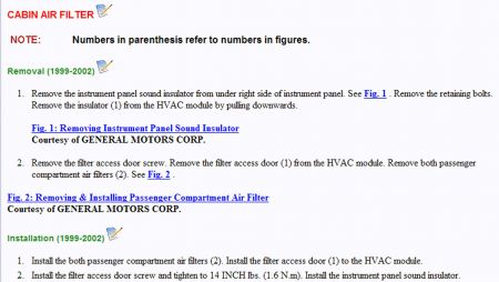

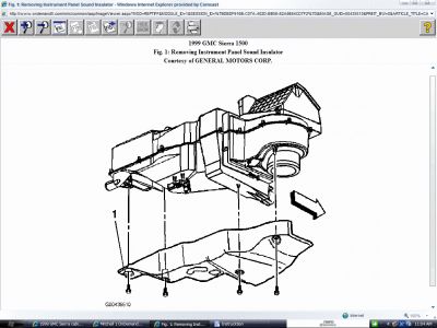

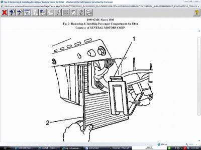

Where is it? I know that it's under the glove compartment but can't figure how the guy at Jiffy Lube got to it so easy.
Thursday, December 20th, 2007 AT 8:33 AM
MERLIN2021
MECHANIC
17,250 POSTS
Maybe he's either fast or fraudulent...Heres how anyway...
