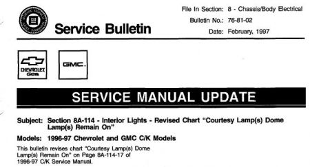

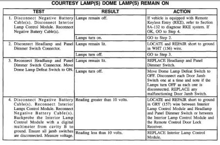

Interior light turns on by itself in the middle of the night only when it's very cold
Saturday, January 17th, 2009 AT 9:59 AM
JDL
MECHANIC
16,098 POSTS
I ran across that bulletin, it doesn't mention cold weather.
