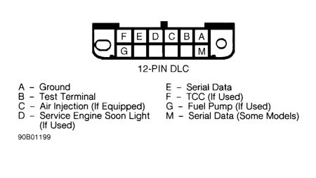

1994 GMC Sierra engine won't start
BELLHEADBOB
  • 1994 GMC SIERRA
  • V8
  • 4WD
  • 11,100 MILES
TRUCK WAS RUNNING GREAT. THEN YESTERDAY, WOULD NOT START. I POURED GAS IN THE CARB. THE ENGINE TRIED TO START THEN DIED.
Monday, June 14th, 2010 AT 10:24 AM
INTERNETMECHANIC
  • 700 POSTS
I'd use a fuel pressure gage on it, go from there. Some of the national brand autostores used to loan out a fuel pressure gage. Check for possible mil codes. When you first turn the key on, can you hear the pump run a bit? You could check voltage and ground at the proper terminals, fuel pump connector. How long since a tune-up? If you use a jumper wire with inline fuse from battery voltage to terminal G of datalink connector, the pump should run, just for testing. The info I looked at 5.7L engine.
https://www.2carpros.com/forum/automotive_pictures/512072_terminal_G_datalink_connector_1.jpg
