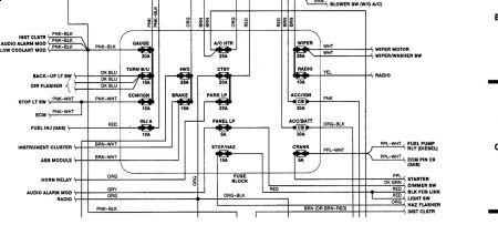

I have a simiar problem. I got a 90 1500 305 and we changed the injectors and still nothing coming out. We tested if any volts and nothing. Could it be the ignition module? The fuel pump works the filter is fine gas comes all the way up but not spitting out the injectors. Could it be something else? I need to know because alot of us are working and we are now on one car so I need to fix the truck. Pease help me out
Wednesday, March 10th, 2010 AT 8:16 PM
JDL
  • 16,098 POSTS
Are you talking about 90 GMC? Injector A fuse in your fuse box is voltage for the injector, goes hot when you turn on the key.
https://www.2carpros.com/forum/automotive_pictures/170934_injector_A_fuse_1.jpg
