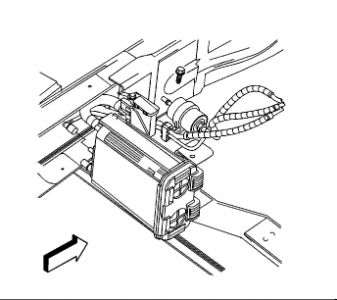

Where is the evap canister?
Friday, October 2nd, 2009 AT 7:31 PM
BRIAN 1
  • 1,030 POSTS
https://www.2carpros.com/forum/automotive_pictures/147643_canister_1.jpg
+5
Friday, October 2nd, 2009 AT 7:45 PM
GWHARTON
  • 5 POSTS
Thanks very much for your help. I'm having a little trouble with the orientation of the diagram you sent. Can you give me a little more help such as in what area to look?
+1
Friday, October 2nd, 2009 AT 9:47 PM
BRIAN 1
  • 1,030 POSTS
The arrow on the diagram shows that is the front of the vehicle and its located on the frame under the drivers seat in front of the gas tank.
+2
Saturday, October 3rd, 2009 AT 1:38 PM
GWHARTON
  • 5 POSTS
Here's what I've done so far.
Rechecked the fill tube and made sure there were no kniks. Removed and inspected the vent tube, but could not determine if there was any obstruction down in the tube. Did not appear to be any kinks in the vent tube. Talked to a certified GMC service technician who thought the problem was a blockage in the vent tube. He did not indicate that there was a great problem if there was gasoline in the canister; said if there was I should just"pour it out". I couldn't get the canister off so am not sure about that either. Still have a problem
