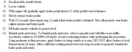

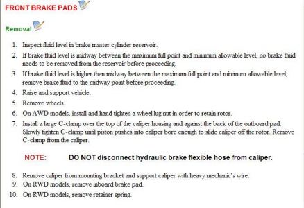

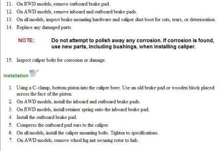

On 2002 GMC Safari Van - is the front disk brake caliper actually a piece of the entire wheel assembly and not independently removable? In other words, does it need to be replaced by a professional shop vs. Me at home?
