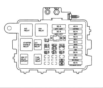

Engine will not shut off when key is turned. Only the accessories go off. Been having to pull fuel pump relay then the battery for the rest of the system.
: is it the key and lock or an electrical item.? Thanks
Nov 1, 2008 at 11:40 AM
IMPALASS
  • CAR REPAIR CONTRIBUTOR
  • 3,112 POSTS
Hello Based off what you are saying it may be a defective ignition switch or the relay is stuck. I attached where the relay is, I would replace that first and then check the ignition switch.
