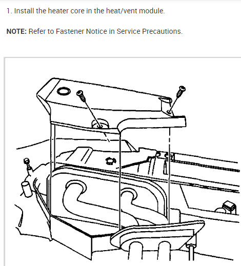

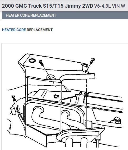

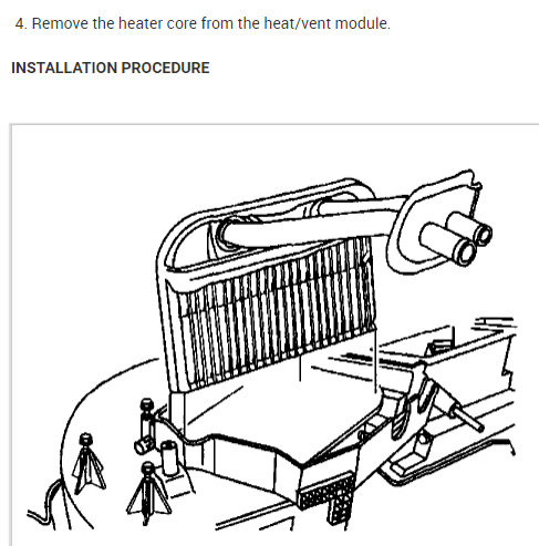

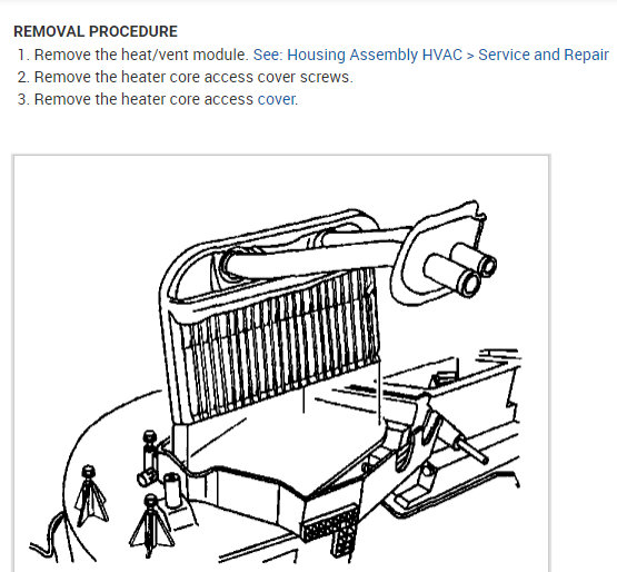

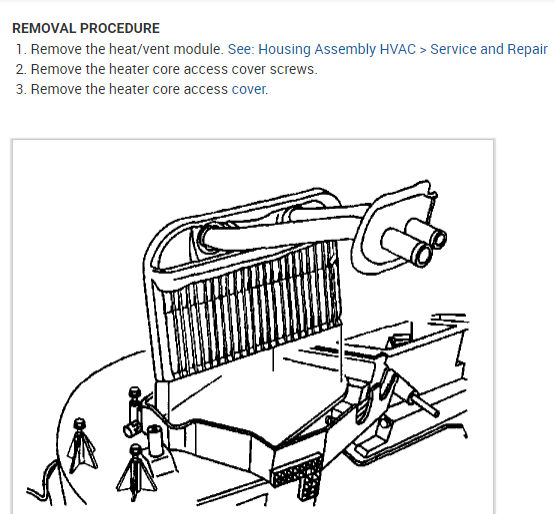

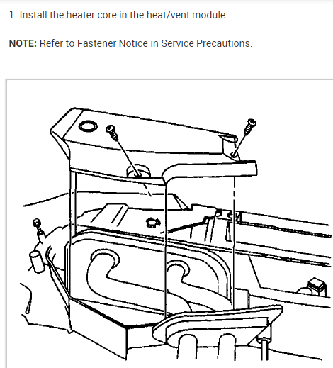

Here is the information you requested. Here is a tutorial to get you started on heater core replacement:
https://www.2carpros.com/articles/replace-heater-core
I've attached picture steps below on heater core replacement for your vehicle. Hope this helps and thanks for using 2CarPros.

Removal
Remove the HVAC module-auxiliary.
Remove the screws from heater core cover-auxiliary from the HVAC module-auxiliary.
Remove the heater core cover-auxiliary.
Remove the HVAC module pass thru seal-auxiliary.
Remove the heater core-auxiliary from the HVAC module-auxiliary.

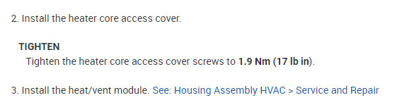

Installation
Install the heater core-auxiliary to the HVAC module-auxiliary.
Install the HVAC module pass thru seal-auxiliary.
Install the heater core access cover-auxiliary to the HVAC module-auxiliary.
Install the screws to the heater core access cover-auxiliary and tighten to 18 inch lbs. (2 Nm).
Install the HVAC module-auxiliary.

I am in the middle of a heater core replacement. This is my first time attempting the job on my own. I have taken the entire dashboard apart and am able to see the top portion of the heater core behind the black plastic encasement. My question is, is it necessary for me to remove the bolt from under hood where the back of the dash is located? Another question is, do I have remove the tire in order to get to the other bolts?

You need to pull the entire dash panel all the way out. Not just the parts attached to it. You will find bolts behind the A/C vents, The speaker grilles, the defrost grill, and one on each end under the dash. Plus a couple in the middle as well. You also need to unbolt the steering column from the dash on the drivers side. Then pull the entire thing toward the drivers side. Now you will see the heater case attached to the firewall. Remove the screws holding it (including the two that come through from the engine side) and you will find the core. Remove the core and clean out the mounting area. Install the new core and then test the doors and controls for operation before you button it all back together. Nothing like replacing the core and finding out you disconnected the heat bypass door!!!

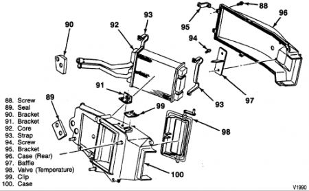

Figure 41: Heater Assembly Component View
https://images.2carpros.com/forum/automotive_pictures/12900_hc_11.jpg
HEATER CORE REPLACEMENT Remove Or Disconnect 1.Engine coolant. 2.Heater hoses. *Refer to "Heater Hose". See: Heater Hose Replacement 3.Instrument panel. *Refer to "Dash Board" under Body and Frame / Interior Trim. See: Body and FrameInterior Moulding / TrimDashboard / Instrument Panel 4.Rear case screws. (88) 5.Rear case. (96) 6.Screws. (94) 7.Straps. (93) 8.Heater core. (92) 9.Seals. (89 & 90) Install Or Connect 1.Seals. (89 & 90) 2.Heater core. (92) 3.Straps. (93) 4.Screws. (94) 5.Rear case. (96) 6.Rear case screws. (88) 7.Instrument panel. 8.Heater hoses. 9.Engine coolant. *Check the system for leaks.

The entire dash has to be removed.This is because the housing is too big to remove to access the heater core. In the engine compartement, drain coolant and remove heater hoses at the upper r/h side of firewall. Inside the vehicle you have to systematically remove all lower dash access panels. Undo the bolts holding the steering column and lower it. on each end of the dash there are torx bolts and regular bolts to be removed.There is one bolt approx below the vent that is right of center. Remove (on top of dash) speaker covers and heater grill,then remove bolts underneath. The dash should pivot back to access wire harnesses. Mark and undo connections, emergency brake cable and antenna cable.Once all the conections have been undone the dash can be removed through the passenger door. Amazing, now you can finally see the housing for the heater core. Remove the cover and then remove bolts holding in heater core. Intallation is reverse. I don't want to oversimplify this, lots of patience and time is required. Good luck

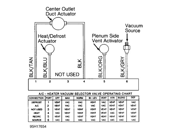

I recently changed the heater core & the car puts . out heat, but after a few seconds the vent door closes. I can hold the switch and force it to stay open,but I am afraid to damage something. Is there a part that may be replaced to allow the vent door to stay open while heater is on?
Feb 5, 2021 at 9:39 AM (Merged)
JDL
  • CAR REPAIR CONTRIBUTOR
  • 16,098 POSTS
Are you talking about the actuator for the dash?
JDL
  • 16,098 POSTS
Note the vacuum diagram for hvac. The actuator may be losing vacuum?
