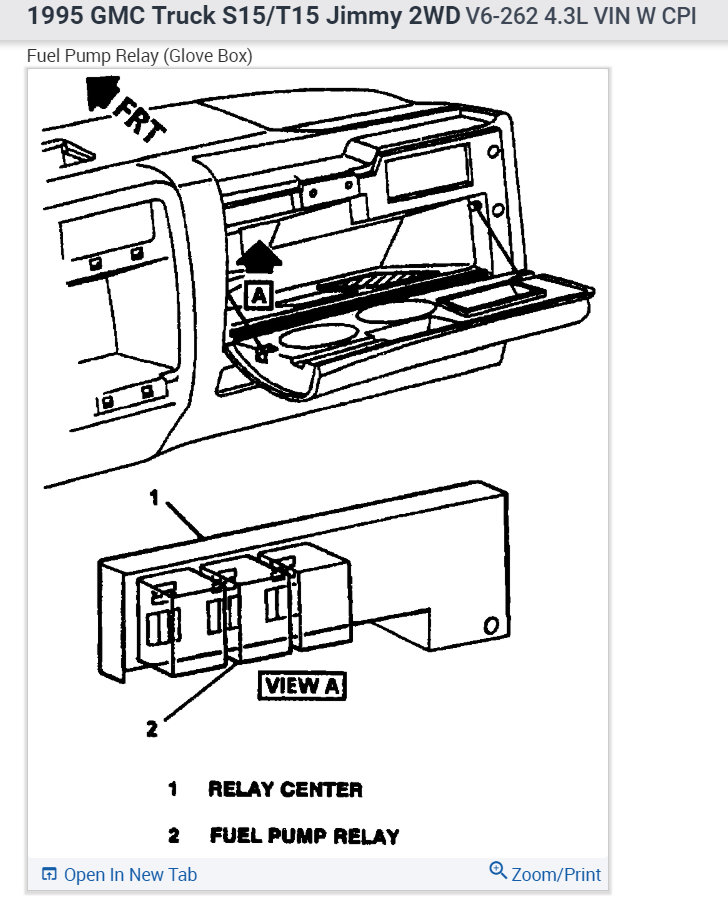

This vehicle does not have a fuel cutoff switch. There is a fuel pump relay though here is the location below and a guide to help test it.

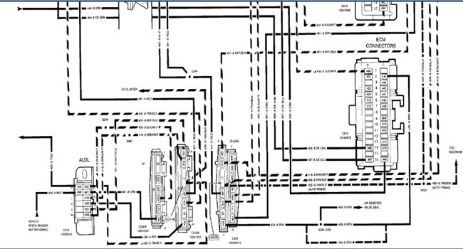

JMURRAY3585
  • 6 POSTS
The suburban is getting fire but fuel pump isn't working and it new the reason why I know is because put gas in carburetor and it fired right up and already replaced almost everything on it.

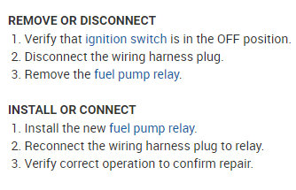

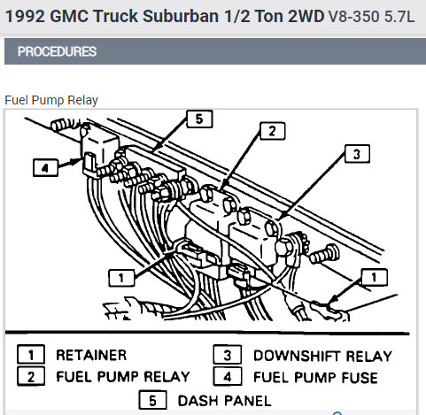

Have you checked the fuel pump relay? Here is a tutorial showing how to test a relay:
I've attached pictures below on how to remove and replace the fuel pump relay and its location. Hope this helps and thanks for using 2CarPros.

JMURRAY3585
  • 6 POSTS
Already did that and it keeps on catching on fire. it's like the fuel pump isn't getting no power.

STEVE W.
  • CAR REPAIR CONTRIBUTOR
  • 15,148 POSTS

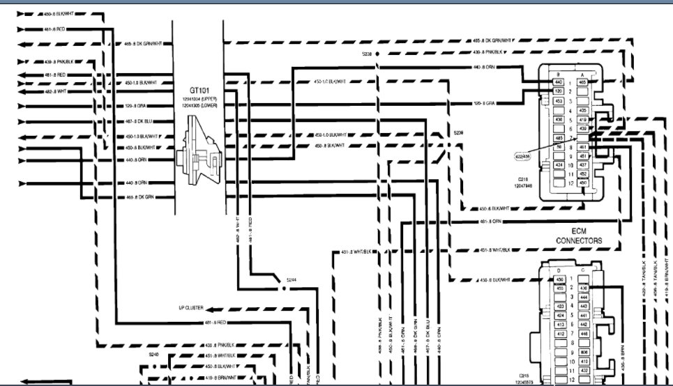

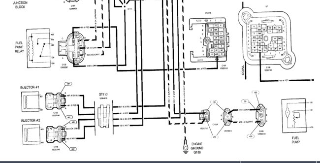

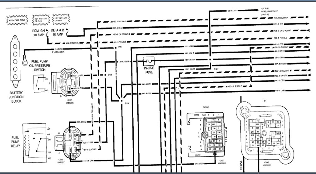

If you mean the relay is burning up then it is likely that the pump itself has failed or the harness is shorted and dumping a lot of current through the relay. To test for that you would need to drop the tank and unplug the pump, if it still has a problem then you will need to trace the harness looking for damage or corrosion.

DANNY L
  • 5,648 POSTS
Hello again.
I agree on checking the fuel pump harness. It might have a shorted wire somewhere. I've attached a fuel system wiring diagram below for you. I've curt the pictures in half so you can view larger. Let us know if you have any further questions on this issue after you test the wiring. Hope this helps and thanks again for using 2CarPros.
