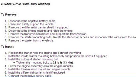

How to remove starter. There isnnt enough room to get it out.

Hello, I found the above info for the 6 cylinder, didn't notice an 8 being listed.
