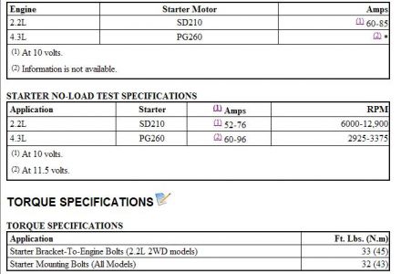

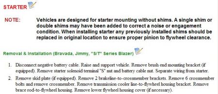

i cannot get the starter out and the wires disconnected please help the lady out.

Hello
Below is info. you requested.
