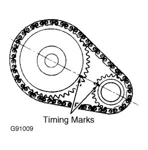

TALLCANADIAN
I've been trying to check my timing chain but when I bring the timing marks together I notice that the distributor does not point at number 1 but looks like number 3. Is this the answer that i'm looking for? Timing chain? Thanks for the any help.
Sunday, February 8th, 2009 AT 11:56 AM
BMRFIXIT
  • 19,053 POSTS
It should be close to # 1
try and turn the distributor
and or pull it out and check drive gear
if timing of, you should had a wrong compression readings
https://www.2carpros.com/forum/automotive_pictures/99387_Graphic1_187.jpg
