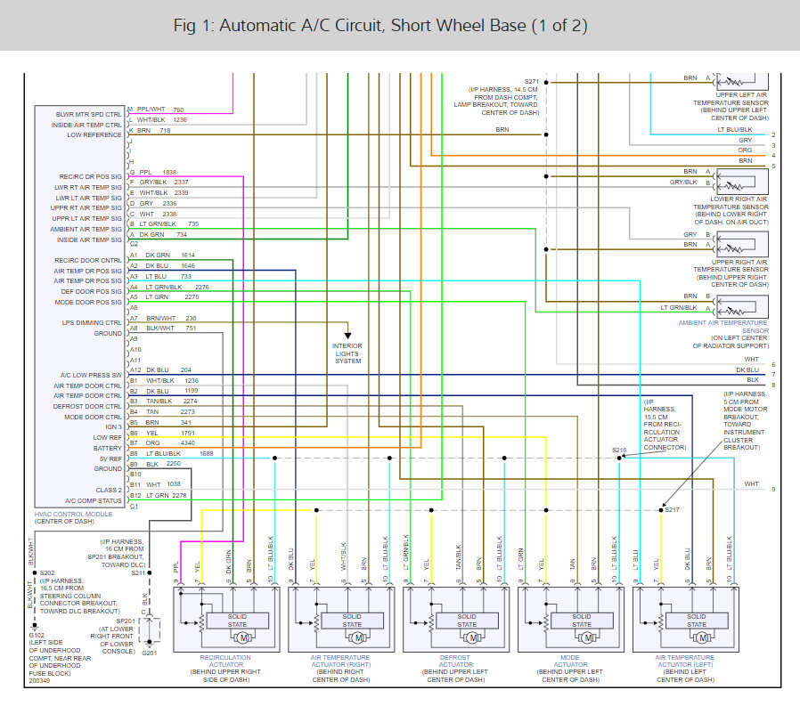

My heater blower motor stopped working, I replaced the Climate Control Assy and the motor worked. I reinstalled all components and did something wrong because I lost all power and could not remove my key. I jumped my GMC removed my key and charged the battery. The next morning I started my GMC and the blower motor would not work. I pulled the blower motor and jumped it to my batter and it worked fine. I installed the blower motor and it will not operate via the control assy. I checked and double checked all blower motor/HVAC fuses and swapped the relay under the good with another function relay but still no blower motor operation. Suppestions please.

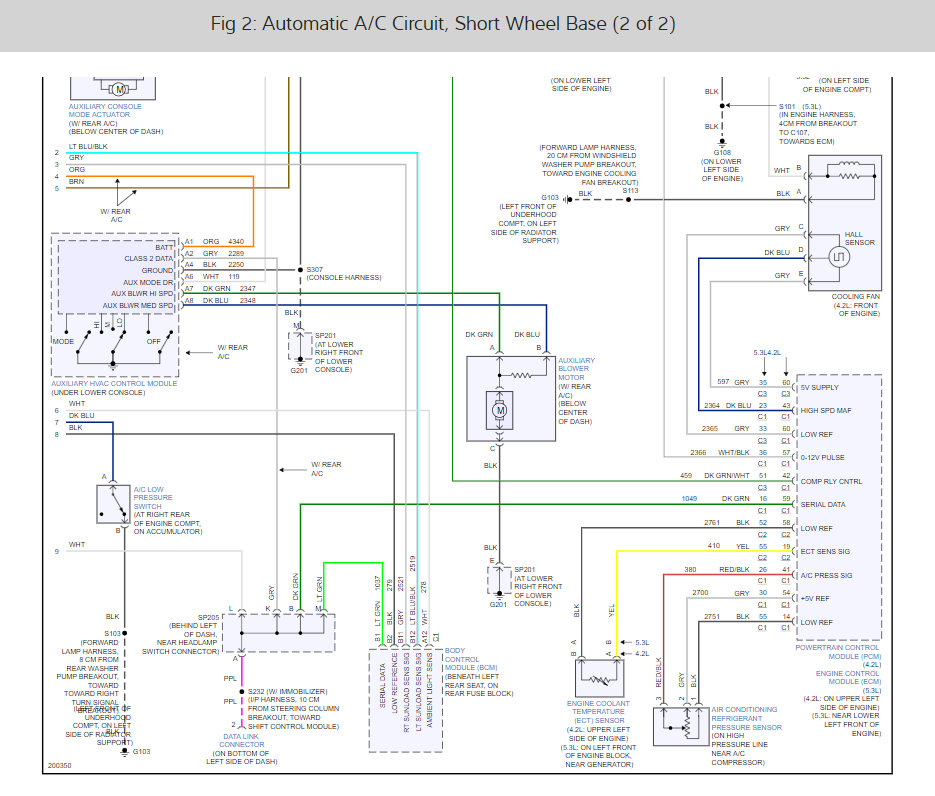

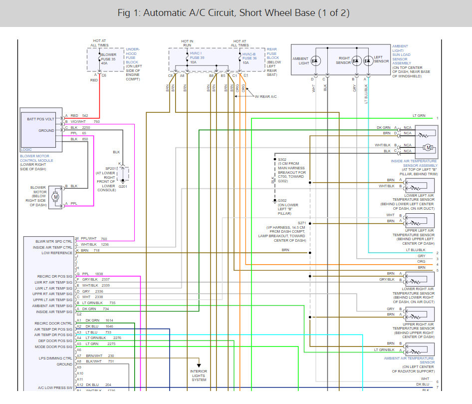

Is this an automatic, or manual climate system? It makes a significant difference in the schematic, and components involved. Lets start by checking the motor this guide will help.
https://www.2carpros.com/articles/blower-fan-motor-works-on-high-speed-only
Here are the blower fan wiring diagrams so you can see how the system works. Check out the diagrams (Below). Please let us know what happens.

It's a manual system, meaning the driver selects temp with sliding dual temp controls.

According to my schematic, check first the blower fuse 40amp in underhood fuse block. With a test light to ground, check for power at blower resistor terminals G, B in lo, A in med 1, D in med 2, C in med 3, and F in hi. Check for ground on pin E. If you could use this ground to ground your test light when checking the above, it will validate it. If you have power and ground (the resistor can be disconnected) on these, and no power or ground to your blower, than replace the resistor. The resistor is shown attached to the blower motor.

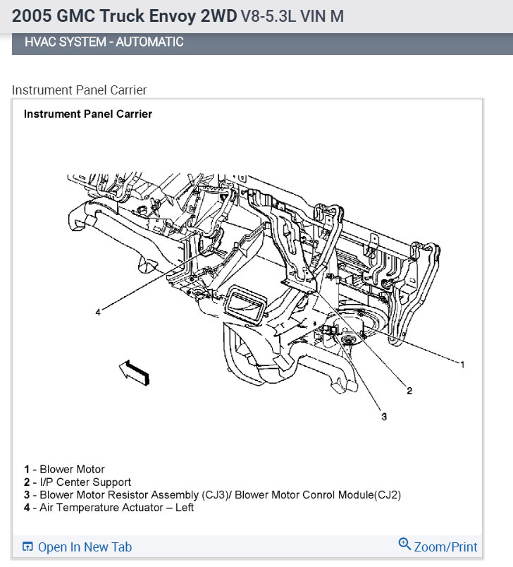

I have a 2005 GMC Envoy which the main blower motor does not turn off even when the truck is off and key is out the ignition and stays on it's highest level. Would it be the relay and if so where is it located? Please help it's cold up here in the NorthEast country.
Tuesday, July 28th, 2020 AT 2:07 PM (Merged)
WRENCHTECH
  • 20,757 POSTS
I assume you have Auto Temp Control. That is usually caused by the blower speed control module which is located where the blower motor resister normally would be, next to the blower motor.

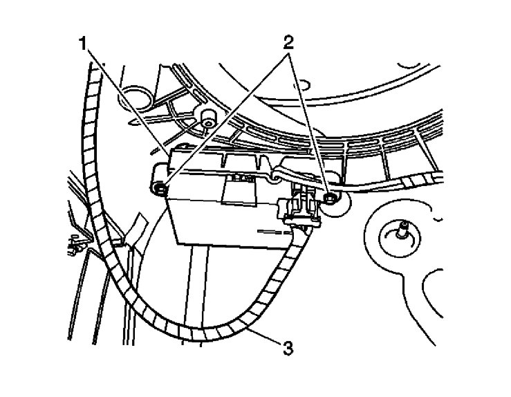

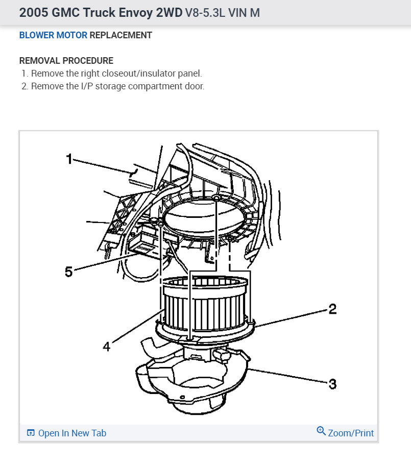

  • 52,797 POSTS
Good afternoon,
The most common issue is the blower resistor. I will attach the procedure and the picture of the location.
Procedure
REMOVAL PROCEDURE
1. Remove the right closeout/insulator panel.
ImageOpen In New TabZoom/Print
2. Disconnect the blower motor resistor electrical connector (3).
3. Remove the blower motor resistor mounting screws (2).
4. Remove the blower motor resistor (1).
EGUNS80
  • 78 POSTS
Where is the panel located?
Tuesday, July 28th, 2020 AT 2:08 PM (Merged)
  • 52,797 POSTS
On t b.C. E end cap of the dash and under CD where your knees are.
