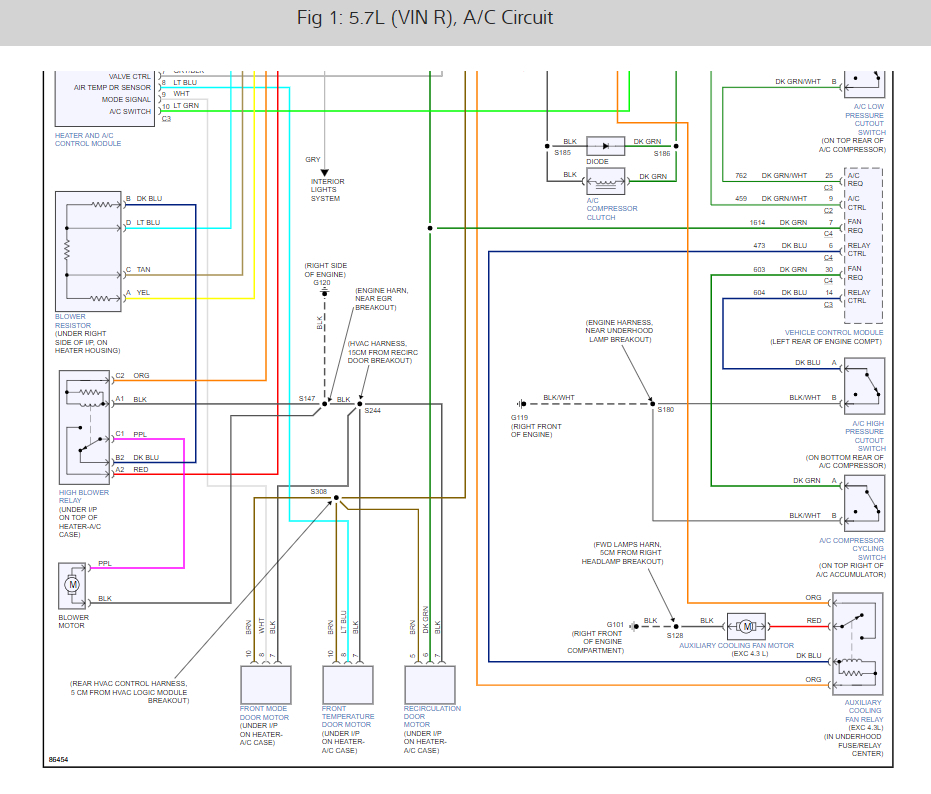

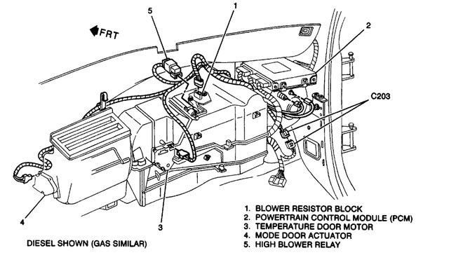

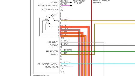

I have replaced the black bosch relay behind the glovebox, the blower resistor and the blower motor and still cannot get the blower to work on high. I remember in older model years of gmc's and chevys that their was a high speed blower relay that caused this issue. If there is a high speed relay, I can't find it. Any suggestions?

Yes there is a high speed relay which sounds like it is out. Here is a guide to help test it and the blower motor wiring diagrams so you can see how the system works with the relay location below as well.

Turn control switch to Hi and look for power at the hi speed relay orange wire-No power either you have an open wire or the blower switch itself within the heater/ac control module-
Also check AC maxi fuse 50amp-it powers the hi speed relay

Must be wiring between the switch and relay, maybe the ground.

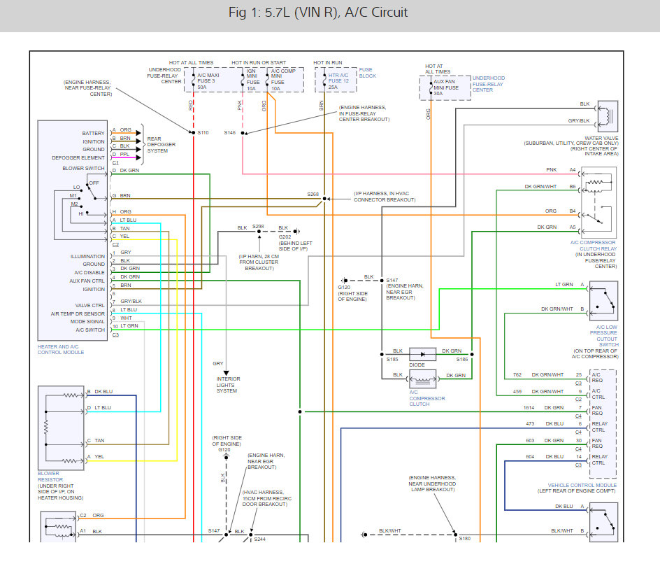

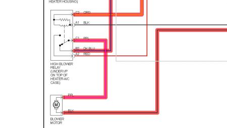

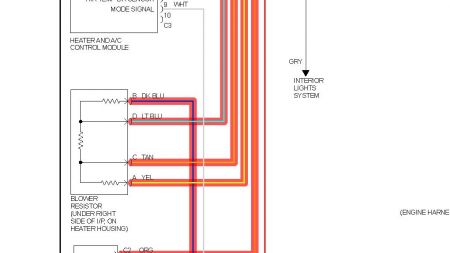

Here's the electrical wiring diagram-try tracking it from the HVAC module to the blower motor-
https://www.2carpros.com/forum/automotive_pictures/12900_switch1_1.jpg
https://www.2carpros.com/forum/automotive_pictures/12900_switch2_1.jpg
https://www.2carpros.com/forum/automotive_pictures/12900_switch_1.jpg
