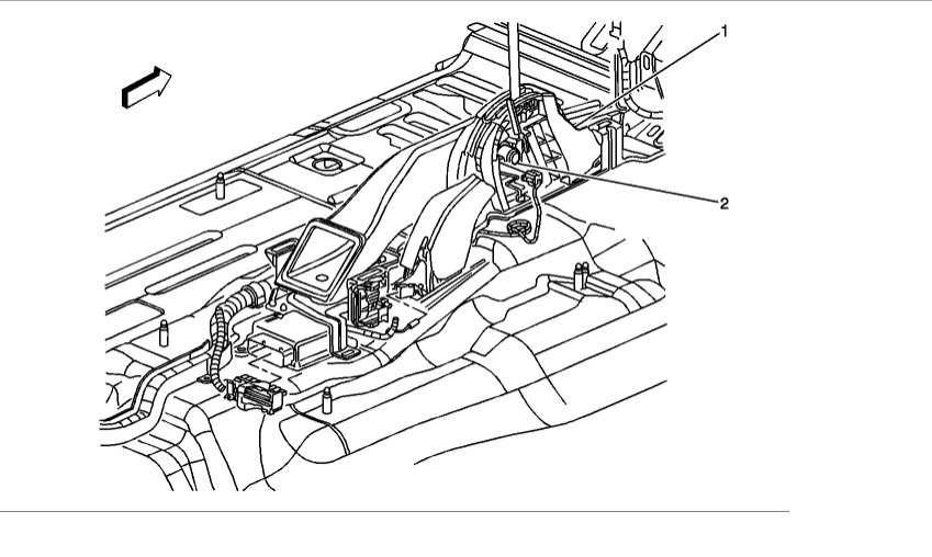

Gear shifter is stuck in reverse
DAVIDEISEN
  • 2006 CHEVROLET TRAILBLAZER
  • 153,000 MILES
Gear shift is stuck in reverse, car wont start, the knob to move shifter will not depress. All the lights come on in the car, the gear shift is stuck in the reverse position. What can I do to try and fix it? How do I remove the gear shift? What else could it be. The car was running great earlier today, then tonight this happened out of the blue.
Friday, September 13th, 2013 AT 9:34 PM
21 Replies
KEN L
  • MASTER CERTIFIED MECHANIC
  • 55,291 POSTS

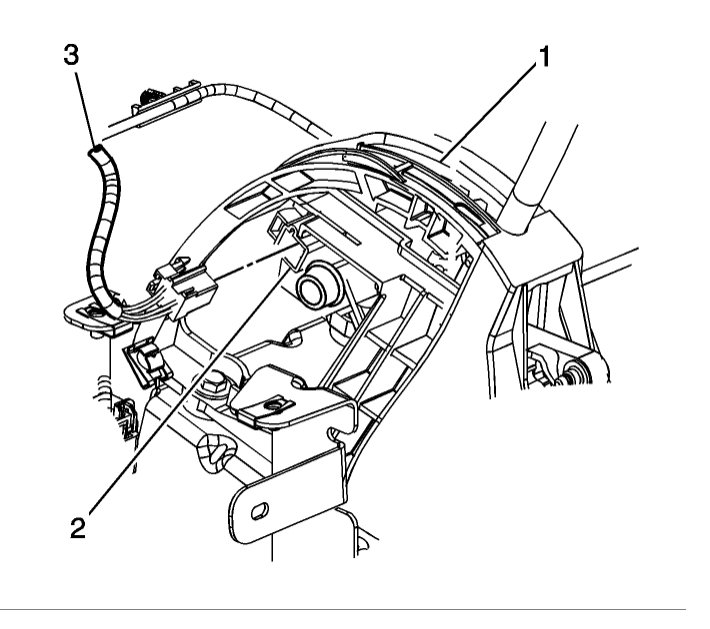

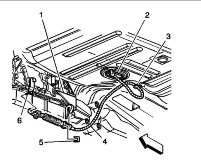

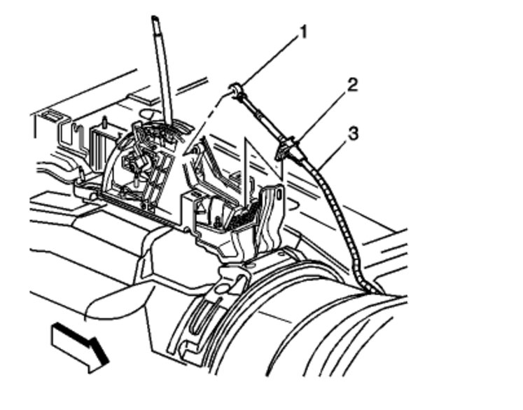

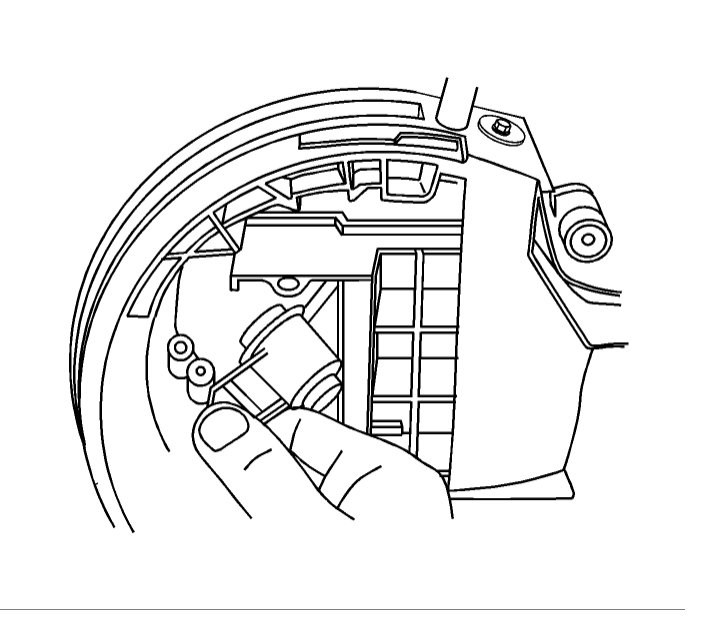

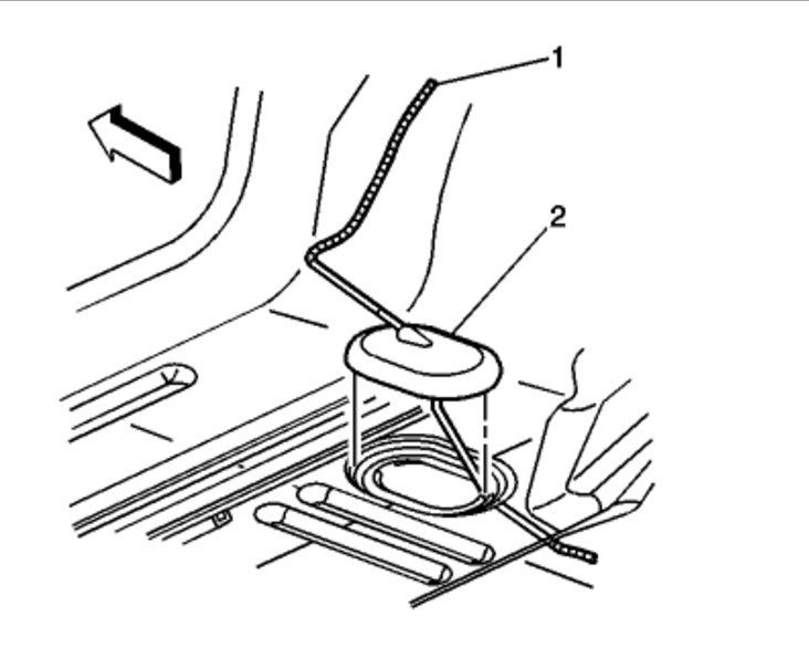

This can be one of two things. Either the interlock solenoid is not working or the shift cable is broken or seized down at the transmission which is common. Get under the car by the selector shaft at the transmission and have someone move the shift lever back and fourth you will see the cable is separated from the mount.

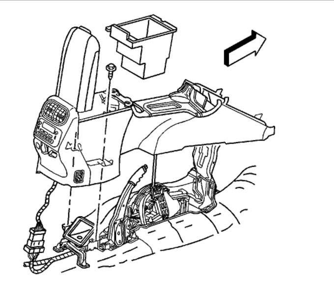

Here is a guide so you can jack up the car safely and some diagram (below) to show you the repair

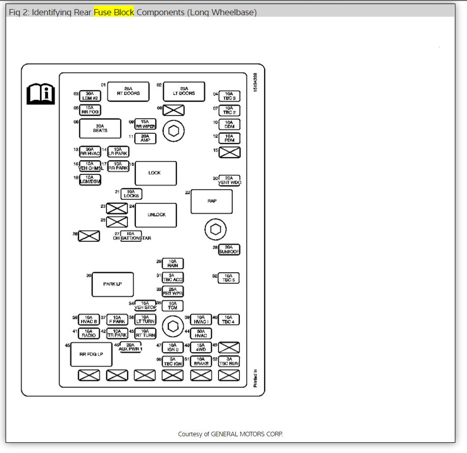

I would also check the fuses to make sure the solenoid is getting power.

I had the same problem with my trailblazer I check the shifter cable and it was the shifter cable bushing that's that small rubber piece on the shifter

It sounds like the shifter cable or the mount has lets go or come loose, look underneath the car while she moves the shifter back and fourth too see what is going on, please let me know what you find.

You are correct. It is a broken cable. Cost to repair - $404. Thanks for the help!

My wife has a 2005 Trailblazer with a I6.  She backed out of the garage 20 ft before trying to shift into drive.  However the vehicle wouldn't shift out of reverse.  She killed the engine, but only to lock the vehicle in reverse and now unable to start it.  The key was also stuck in the ignition in the run position.  Check engine light now on.
1. First I checked the shifter linkage.  GOOD at Trans.
2. Read that not enough volts would cause the shifter lockout solenoid to activate. Â
3. Hooked up my vehicle by booster cables.   (Quick attempt to move vehicle out of the alley we were blocking). NOTHING
4. Removed top of center console to access the shifter lockout solenoid. Manual shifted into neutral to push the vehicle out of the alley.  WORKED - linkage is GOOD.
