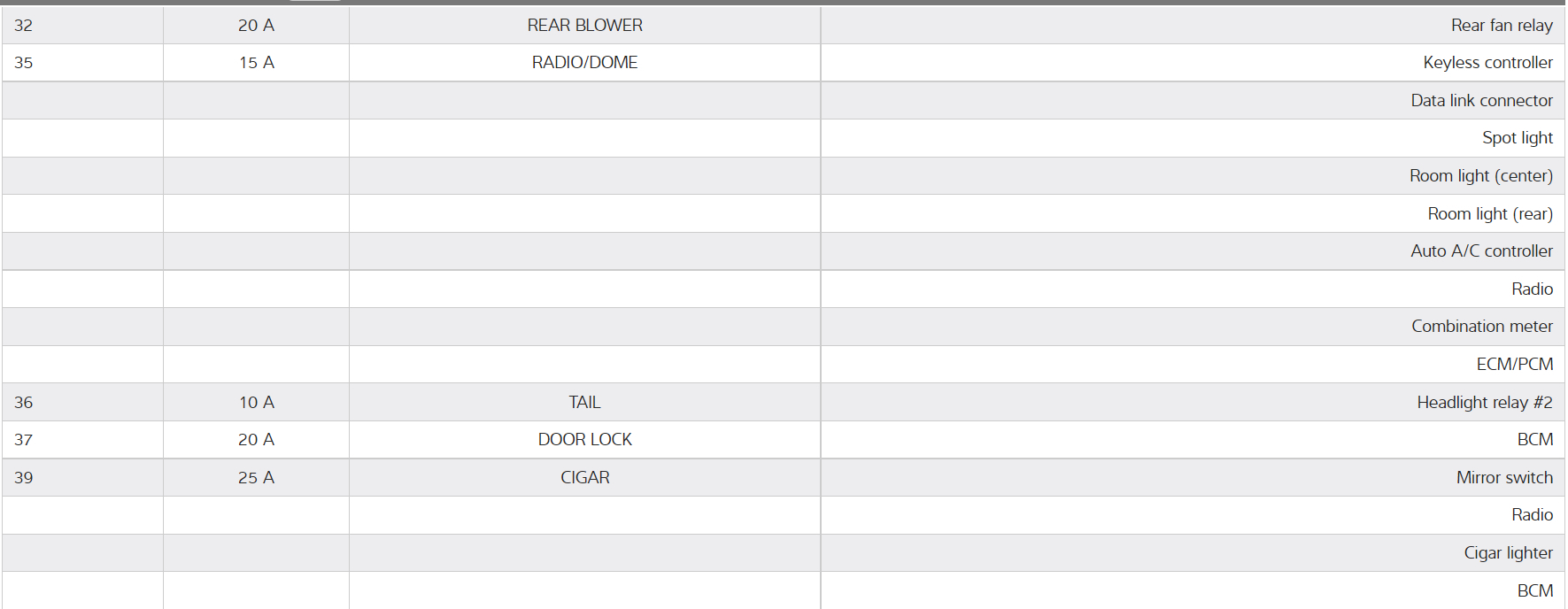

Is there an interior location for fuses?
Monday, November 15th, 2021 AT 10:10 PM
AL514
MECHANIC
5,596 POSTS

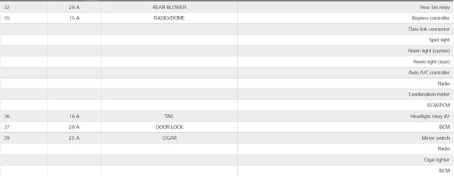

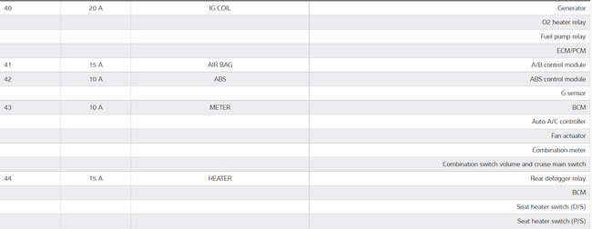

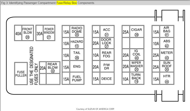

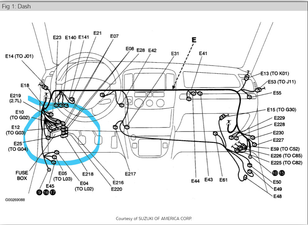

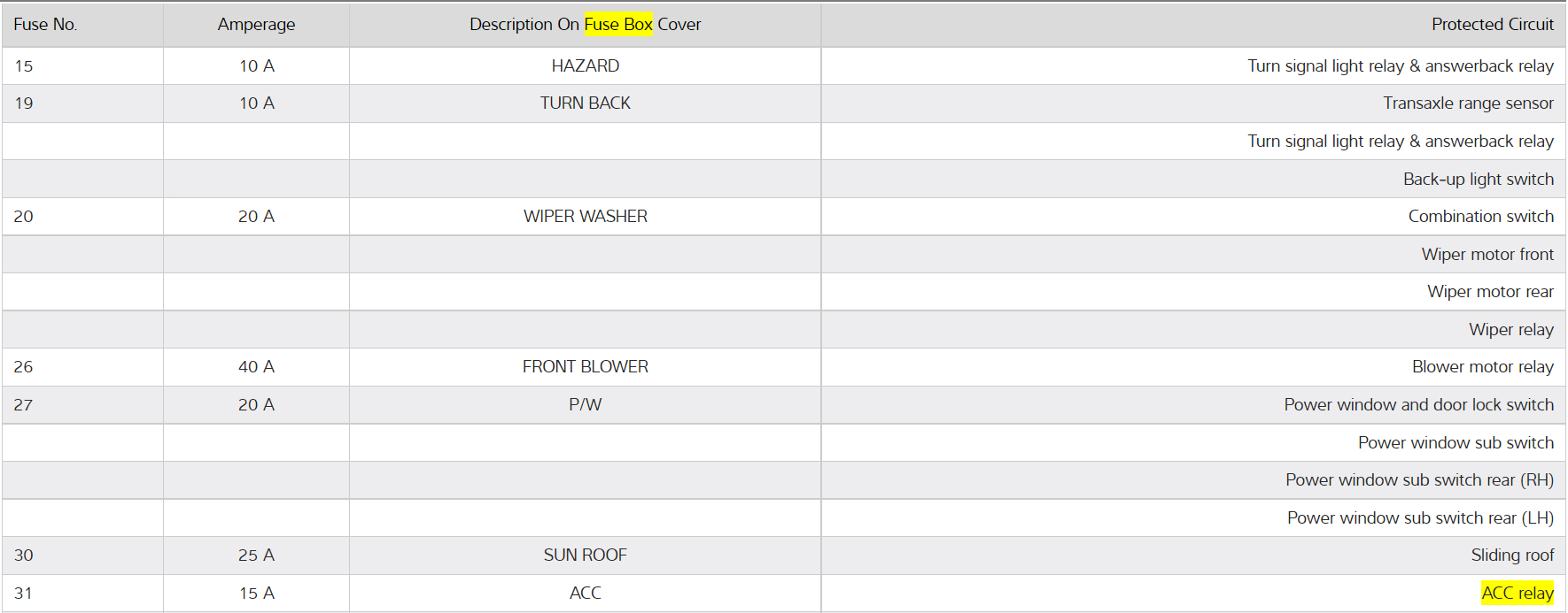

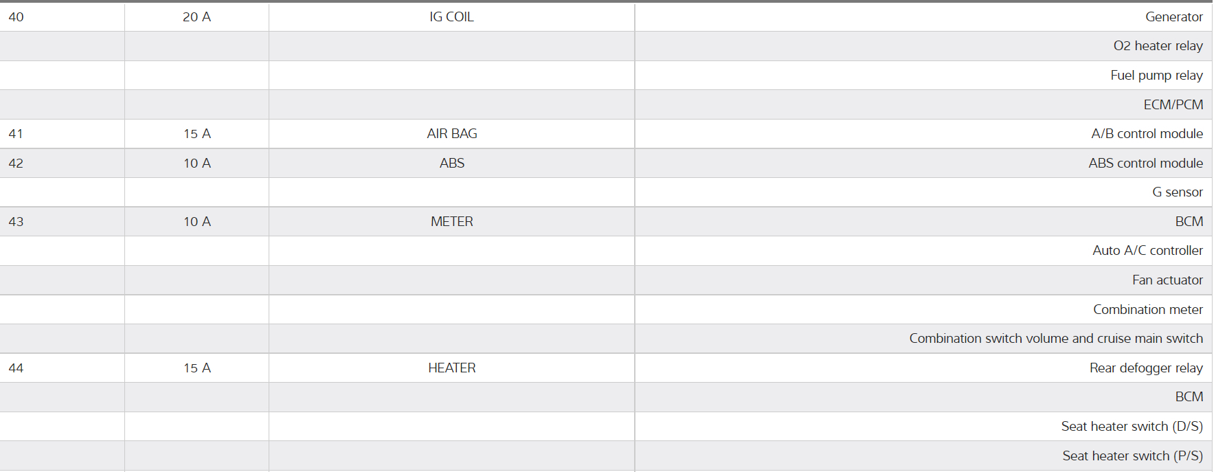

Hello. yes, there is a fuse panel under the driver side of the dashboard. Do you any particular fuse blown?
