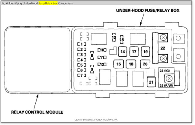

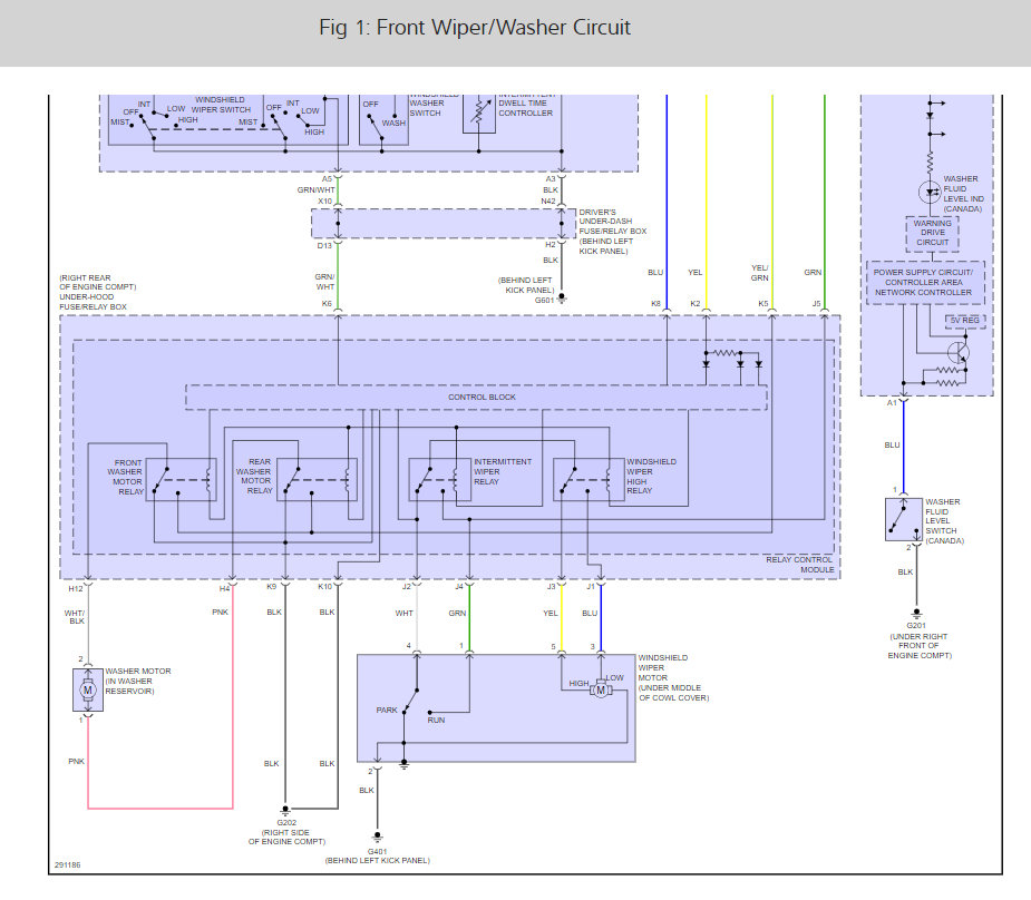

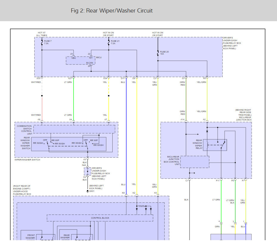

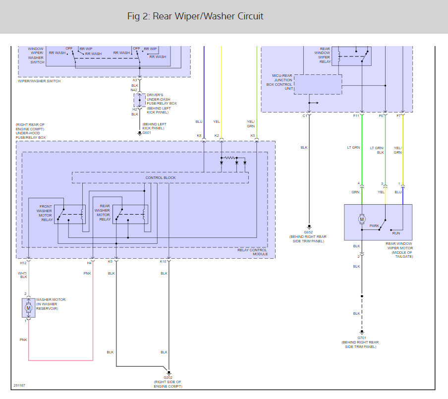

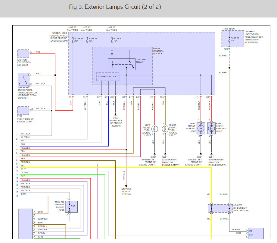

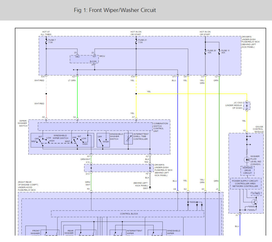

My turn signals will not work, my rear wiper do not work, my outside temperature is blank line, my front wipers will not work on intermittent, and my headlight indicator does not display but headlights do work.
Tuesday, September 4th, 2018 AT 7:46 AM
15 Replies
KEN L
  • MASTER CERTIFIED MECHANIC
  • 55,499 POSTS

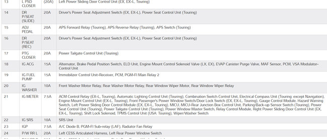

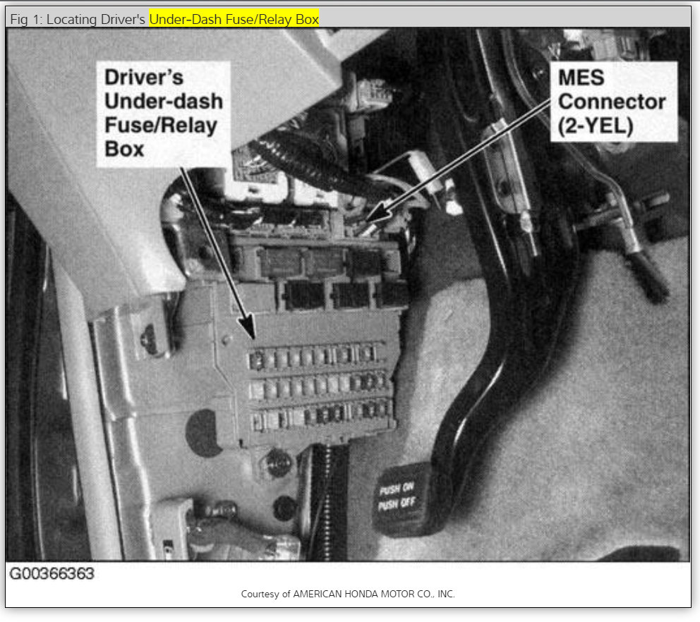

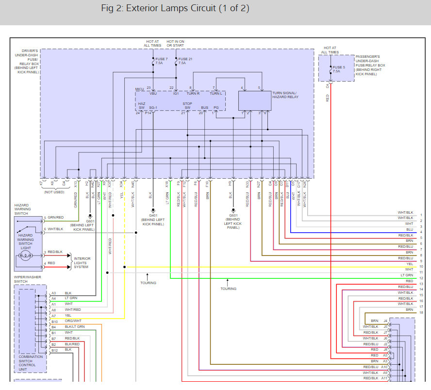

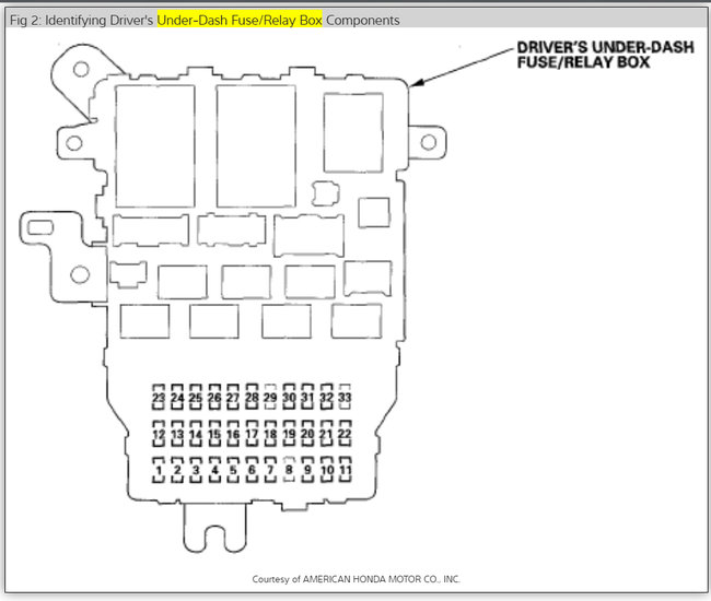

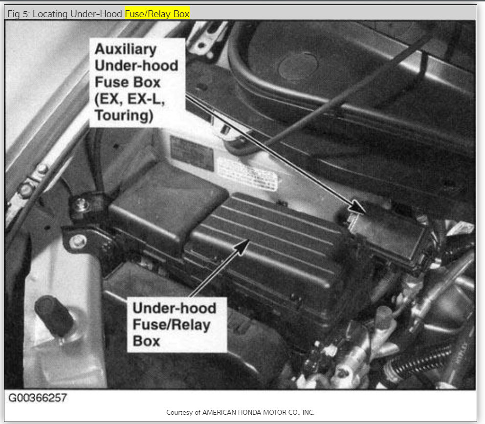

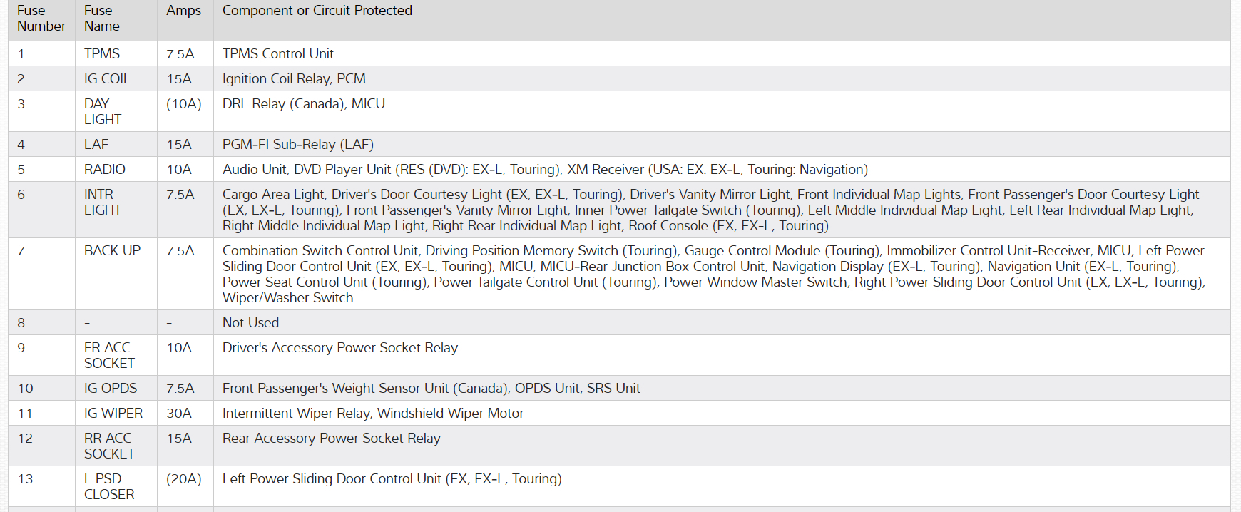

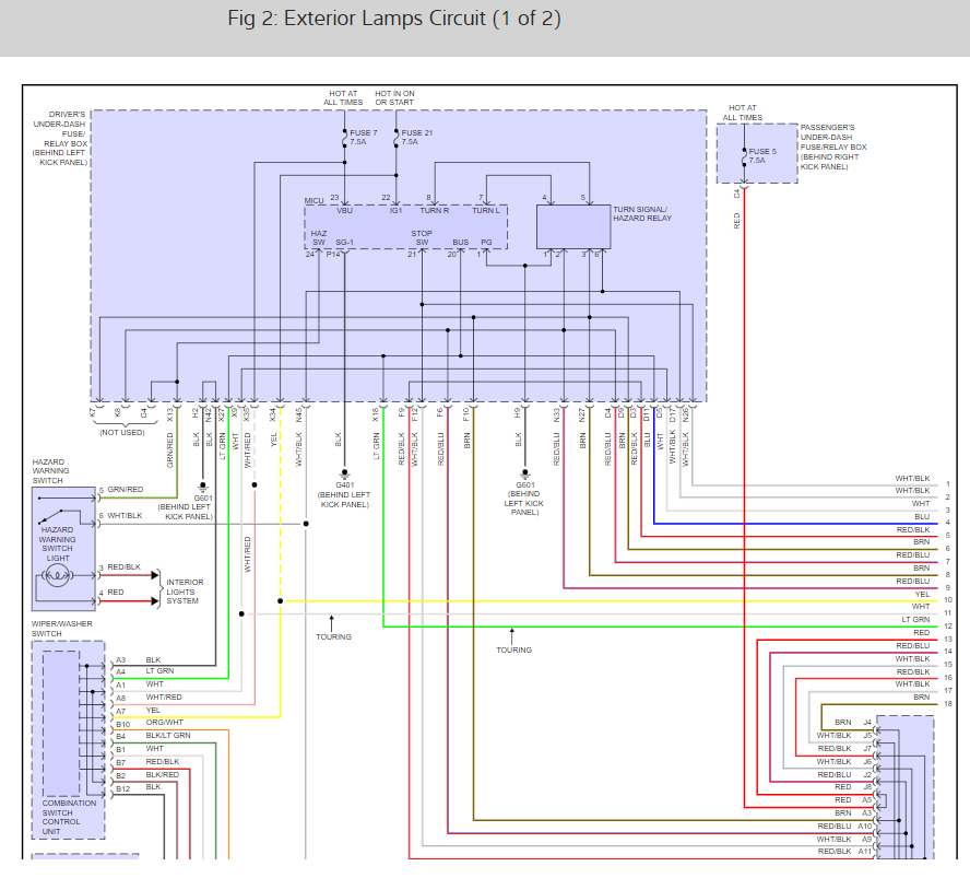

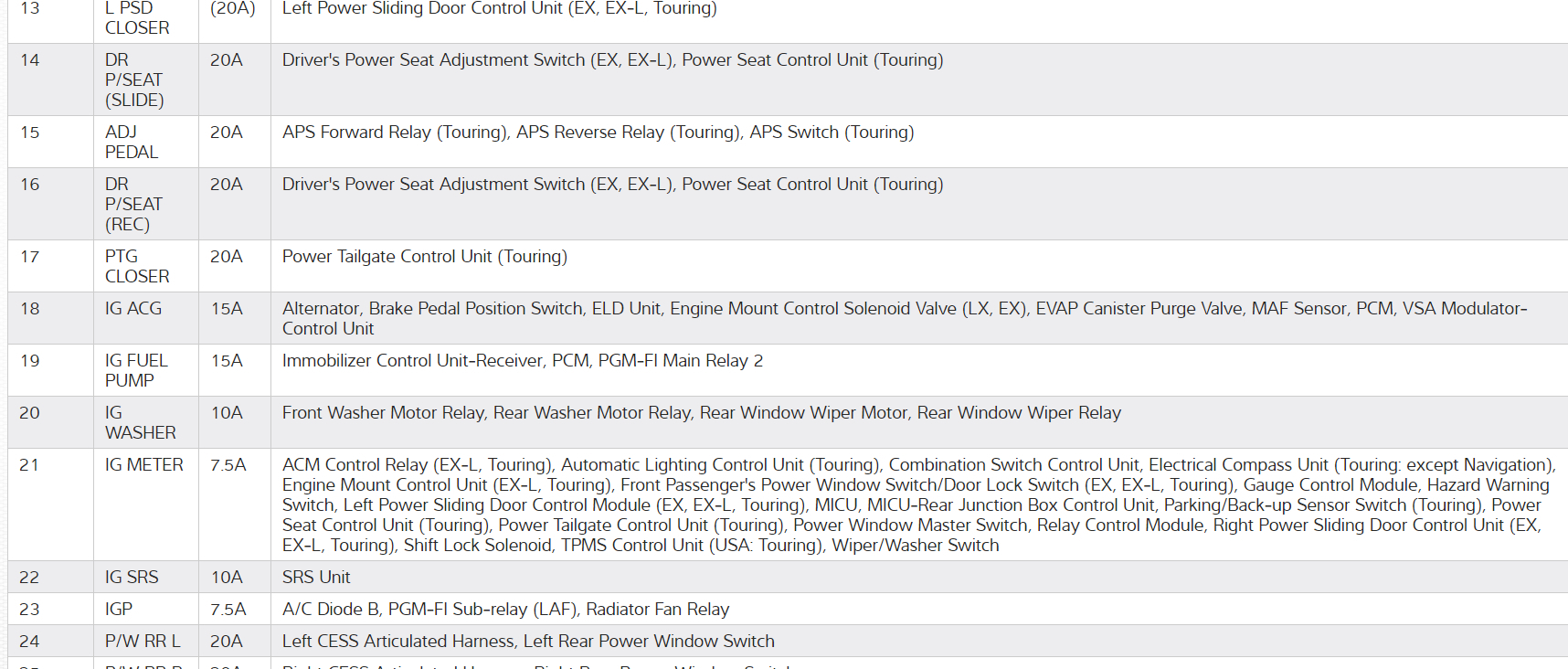

It sounds like the relay control module has lost power lets check fuses # 20, #7, #21 and #11 in the driver side fuse panel. Here is the guide to help you test the fuses, the fuse locations and the wiring diagrams for the front and rear wipers and turn signals so you can see how the system works:

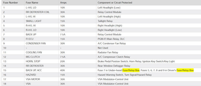

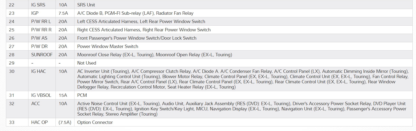

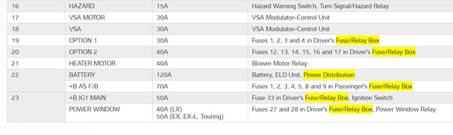

I am trying to locate the fuse for my van. I tried to look for the number in the owner's manual on page 384. May be it is listed with a name other than 'Turn Signal'. Can some one help me find it?
ZA
Thursday, September 6th, 2018 AT 3:44 PM (Merged)
KHLOW2008
  • 41,814 POSTS
Hi zaf19,

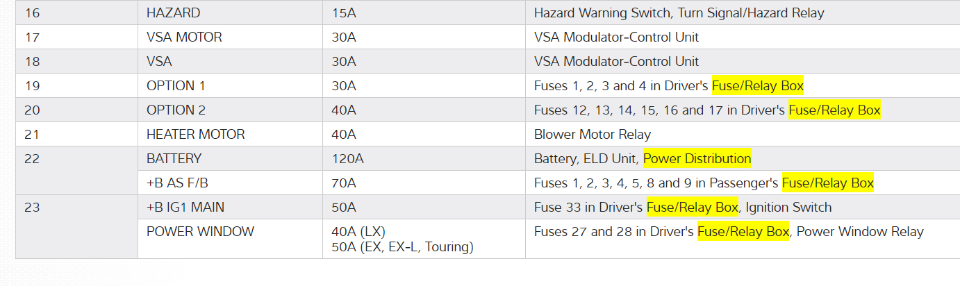

The turn signal/hazard relay fuse is # 16 in under hood fuse box.
Other than that it does not have designated fuses ans the turn signals are incorporated into the Body control/Multiplex system.

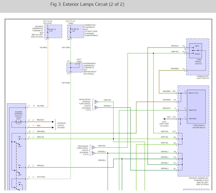

My lights turn on but my signals do not work neither do my hazard lights I replaced the fuse 3 times but it keeps blowing. I dont know what else to do or what it might be.
Monday, December 31st, 2018 AT 10:49 AM (Merged)
  • 110,194 POSTS
If it blows the fuse, there is a direct short. This can be a nightmare to find. Tell me, does the fuse blow as soon as you put it in or do you have to turn the signals on for it to blow?

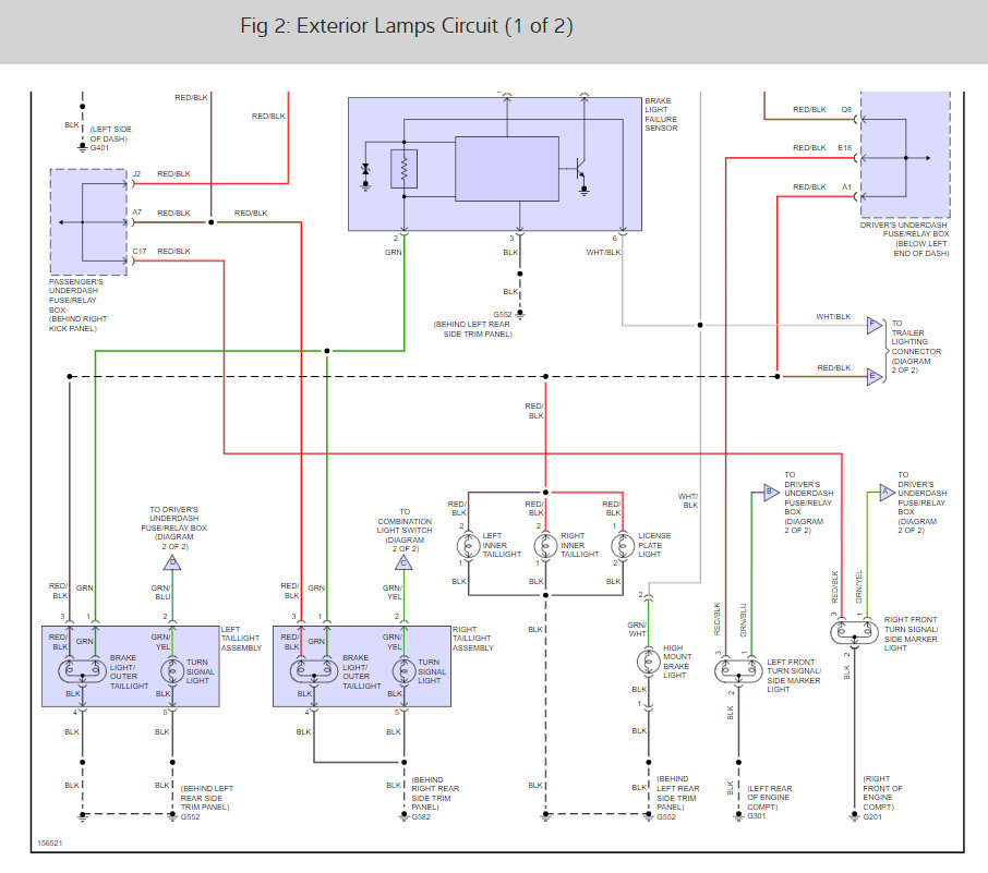

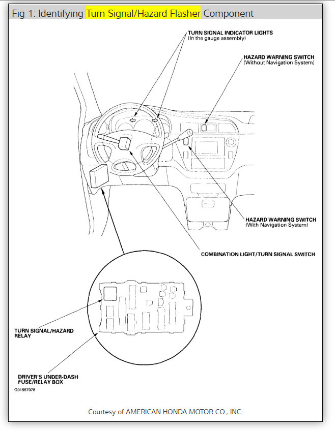

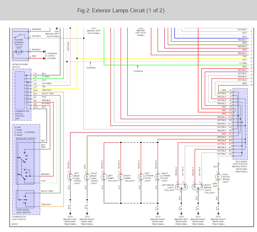

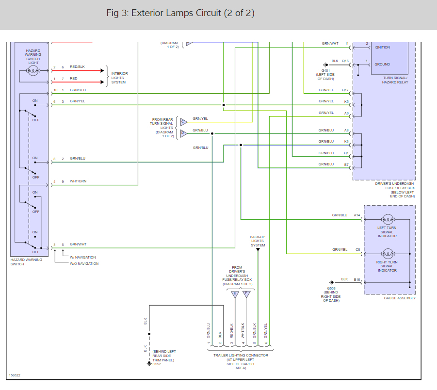

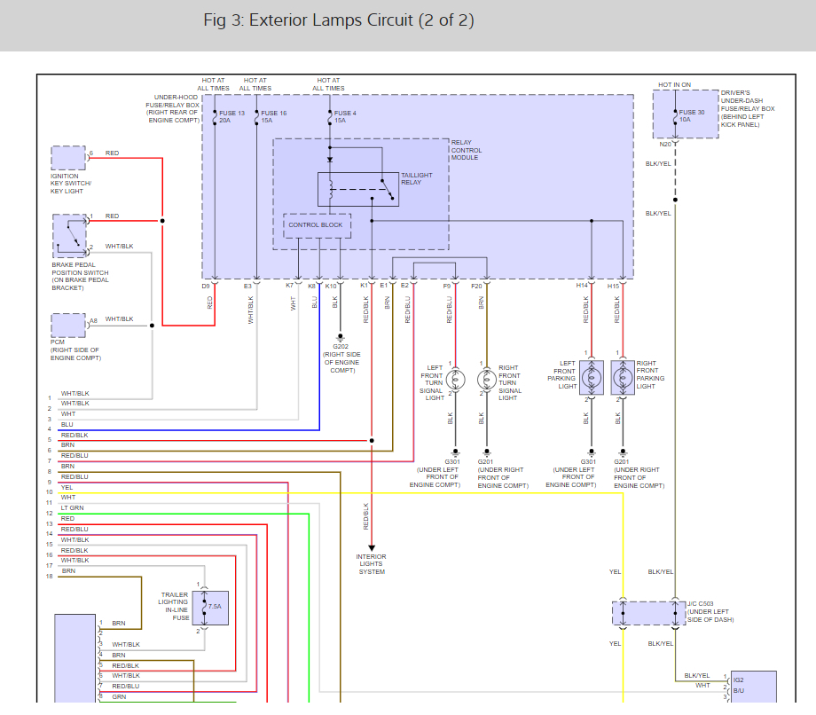

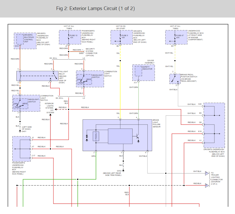

KEN L
  • 55,499 POSTS

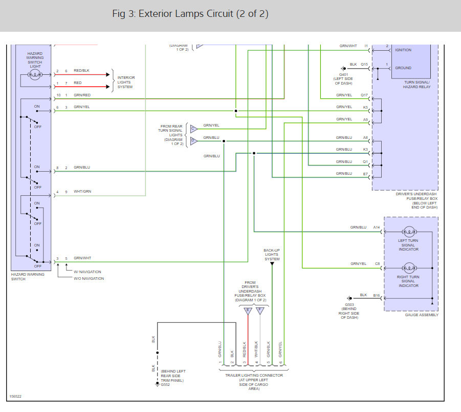

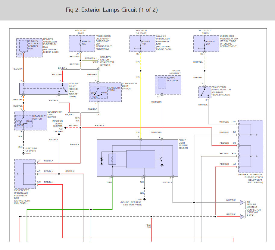

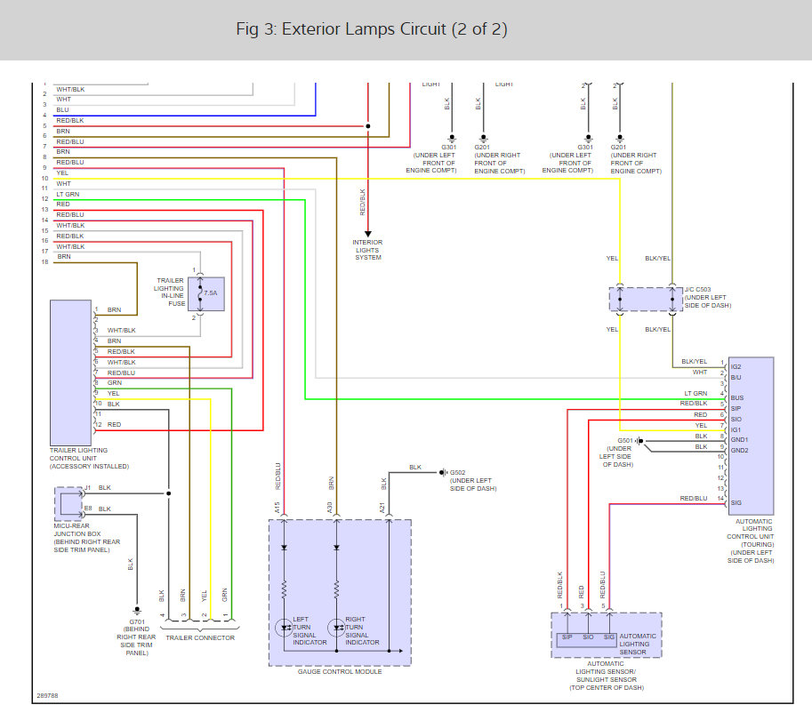

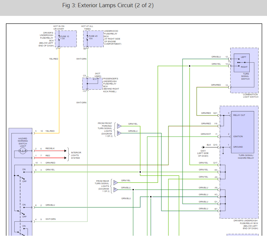

This sounds like the hazard/flasher relay is shorted out but to be sure lets check the bulbs at each corner. Check out this guide make sure nothing is burnt up or melted.
https://www.2carpros.com/articles/turn-signals-not-working-blinker
Here is the wiring diagrams for the lighting system so you can see how the system works and the flasher/relay location check it also for the burnt smell.
