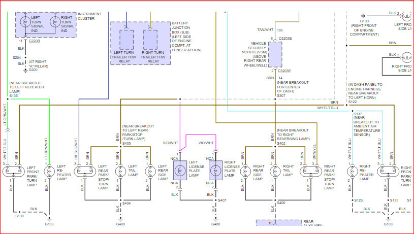

Fuse was replaced, brake switch replaced.

Just to be clear; do you mean the brake lights are not working? Hope this helps and thanks for using 2CarPros.

Yes sir. The brake lights are not working at all. My husband replaced the brake switch and checked the fuse and still was not successful.

Do u have a test light? If yes check for power on wires to switch. Just asking did u check bulbs?

Yes he checked bulb. Getting ready to ask him about testing it. Thank you so muc. I will get back with you in a few

Attached below is the wiring diagram for the rear brake circuit. This is for the non-IVD. Hope this helps and thanks again for using 2CarPros.

Thank you so much! I'm passing this informative information onto my husband. Thanks again and have a Happy New Year!
