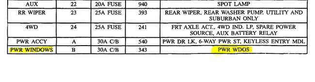

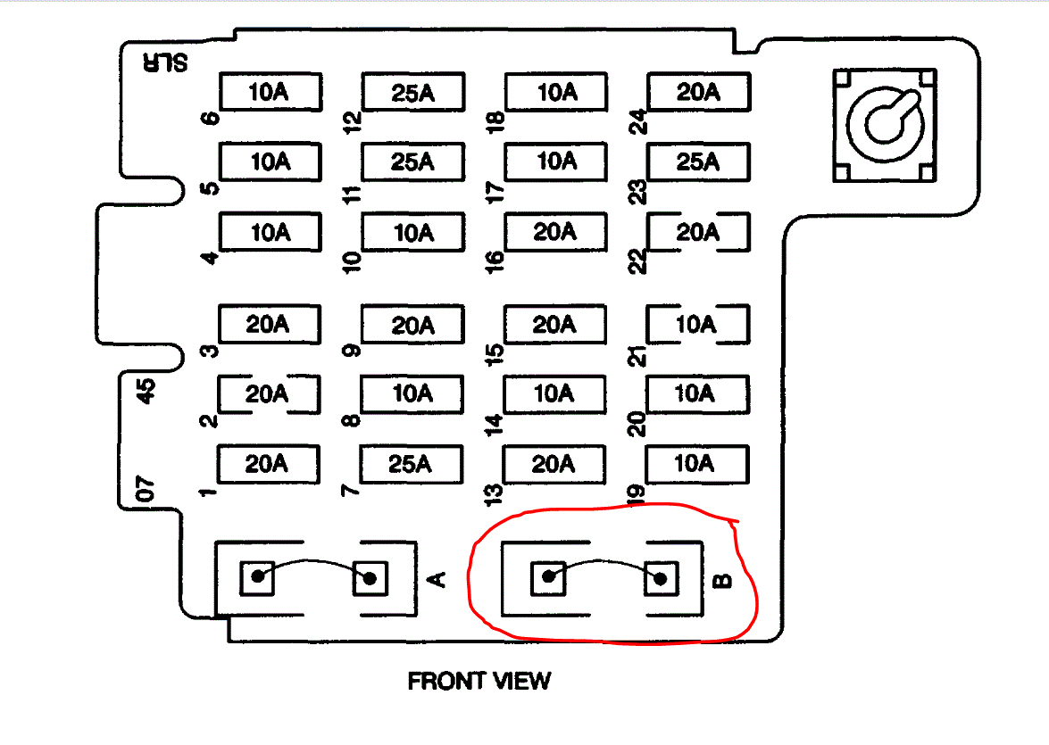

Where would the fuse located for the powers windows?

It is in the vehicle instrument panel fuse box. I attached two pics. The first is a portion of the legend. It shows fuse 'B' for the power windows. The second pic shows location in the box.
Let me know if this helps.
