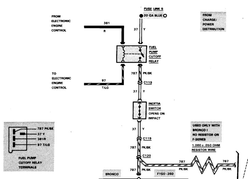

I have replaced the fuel relay and fuel pump, but the truck is still not getting any fuel.

Good morning.
Did you verify power to the pump?
Did you check the fuses?
I will attach a wire diagram for you to view. I need the engine size.
If you have a test light or voltmeter we can do some checks to see.

5.0L dual tank XLT.

Attached is a wire diagram for you to view. You need to verify power to the relay.
