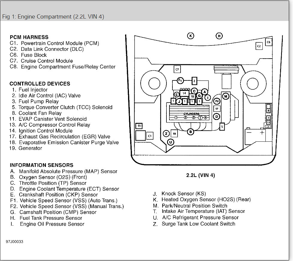

Trying to find out if the 1997 have a fuel pump cut shut off switch.

No it does not. If you are looking to stop the fuel pump, take out the fuel pump relay. I have included its location in the diagrams down below.
