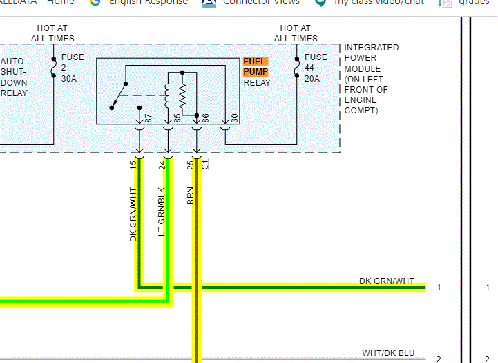

Having an issue with my fuel pump. The truck shut off on me while driving about 4 weeks ago. When I turn the key to the on position or try to start it, the fuel pump doesn’t cut on at all but when checking with a multi-meter, I have power to the plug. The truck tries to turn over but nothing. Need help please!

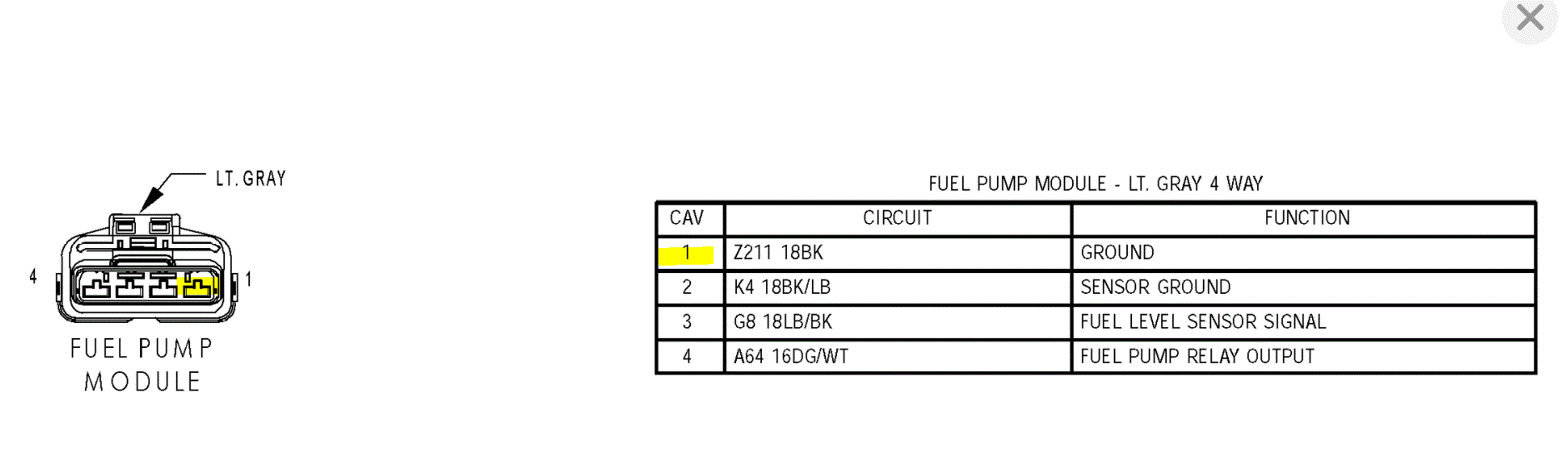

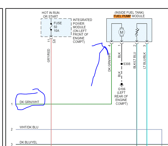

If you have power to the pump, is there a good ground? If there is, then the pump is bad. Do me a favor, take a look at the attached pic. It shows the wiring connector to the pump. Confirm there is continuity to ground in terminal 1.
Let me know what you find.

Replaced the fuel pump already and yes, continuous power to it.

What about ground? Have you checked for continuity to ground? If you have power and know the pump is good, then there must be a ground issue.
If you run a 12v jumper wire to the pump, will it run?

Yes, I have good ground as far as the multi-meter is showing. Just no power to the relay output. Should I put a toggle switch between the pump and battery? And also, am I Hooking the 12v wire to the relay output?

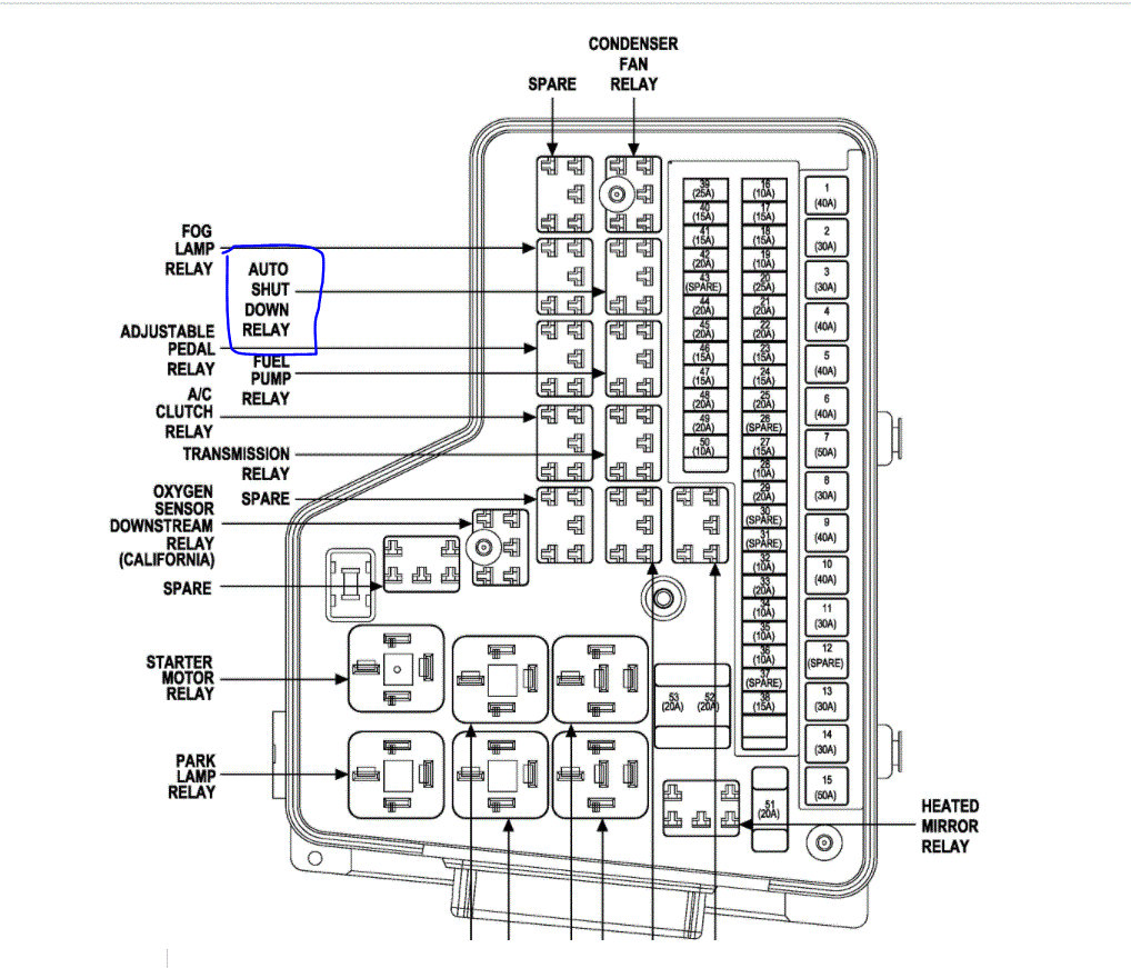

Do me a favor. Check to make sure the ASD (auto shut down) relay is good. I attached a pic below of it's location. Also, check fuse 49 in the same box.
Let me know. You may have a faulty integrated power module (IPM). They have several connectors filled with tiny pins that corrode, break, and so on.

Good morning. Okay, both fuse and relay are good. When running a jump wire to the battery, where should I tie it in at on the plug?

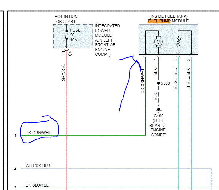

At the pump module, there should be a dark green wire with a white tracer. Where that plugs into the module is where you should supply power. See the attached pic. (Pic 1)

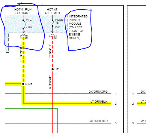

Also, check the fuse I have in pic 2. It's in the under hood fuse box.
I have a question. You indicated in a prior post that there was power to the pump. Has that changed?

The fuse is good.
Also, yes there’s still power and showing good readings to all wires except the green and white wire.

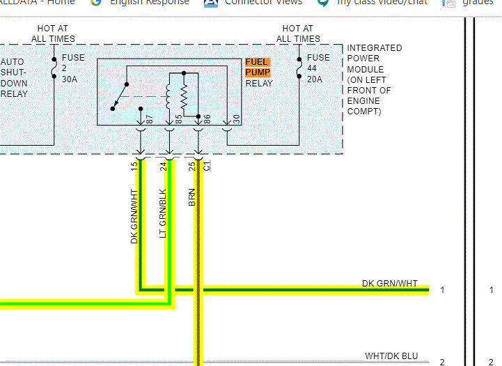

I attached a pic below that shows the relay for the fuel pump. The one you indicate has no power is what powers the pump. Go back to the relay and check if there to make sure the wire doesn't have power.
If you look at the pic, the brown wire goes to the PCM and the light green/black wire is fuse power from the ignition switch. Here is a link that explains how to test a relay. Also, keep in mind that the ASD relay will shut down power to the pump as well.
You can do that, switch the really with a known good one with the same part number, or take a jumper wire and jump power from fuse 44 to the dark green wire. See the diagram for pin numbers. If you do that and the pump still gets no power, then suspect the dark green wire is broken at some point.

Okay. So now I have power to the pump, the green and white wire has to be bad somewhere throughout the wiring because I ran a jump wire in place of that one and it powered right up. But now, all it’s doing is spinning over but not cranking up. What could that possibly be?
