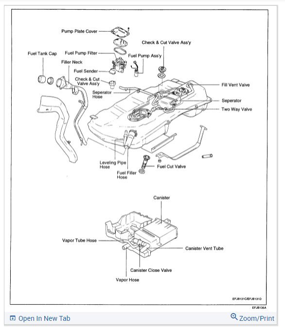

Car is turning off during the drive on the road, no matter what is the speed and rpm's. When try too start engine again fuel pump is soundless, because it is not getting power. I am able to start the car only just if pump starts making some noise.
Could you tell me how to resolve this issue? Thank you!
Oct 31, 2016 at 5:27 AM
So if the pump makes no noise and it doesn't start then it does when you do hear the pump then the pump is the issue.
Here is a guide that that will help with testing the pump if you want to confirm this:
Also, here is a guide on how to replace the pump as well:
https://www.2carpros.com/articles/how-to-replace-an-electric-fuel-pump

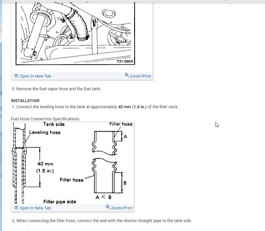

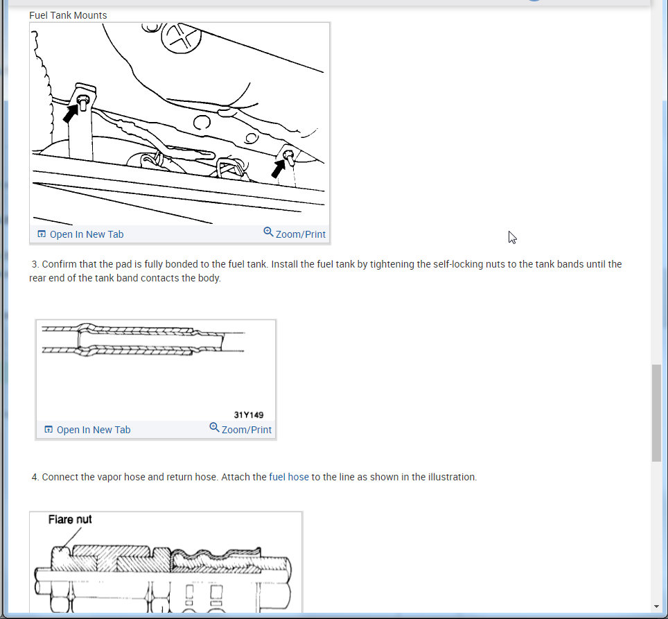

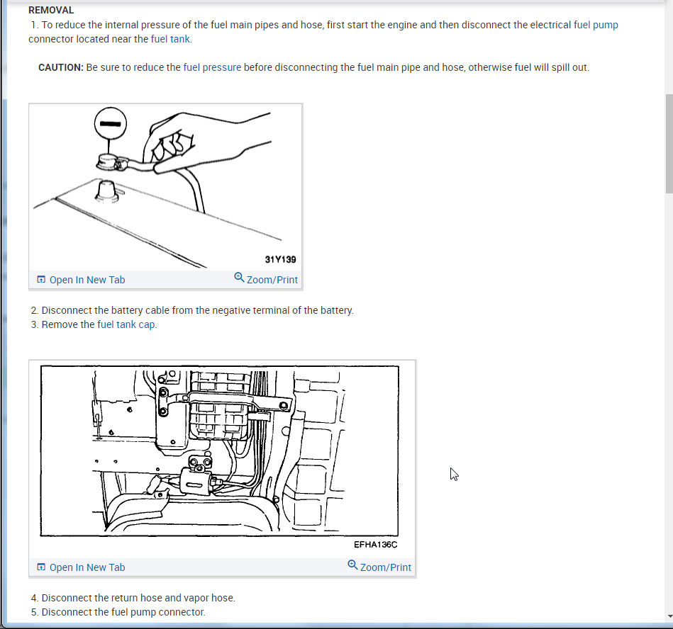

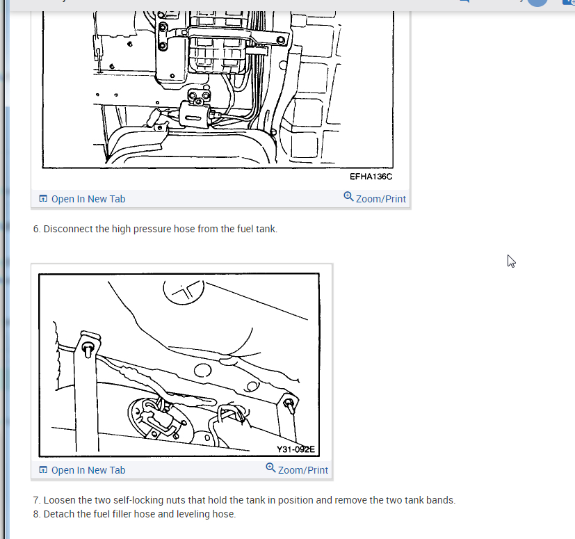

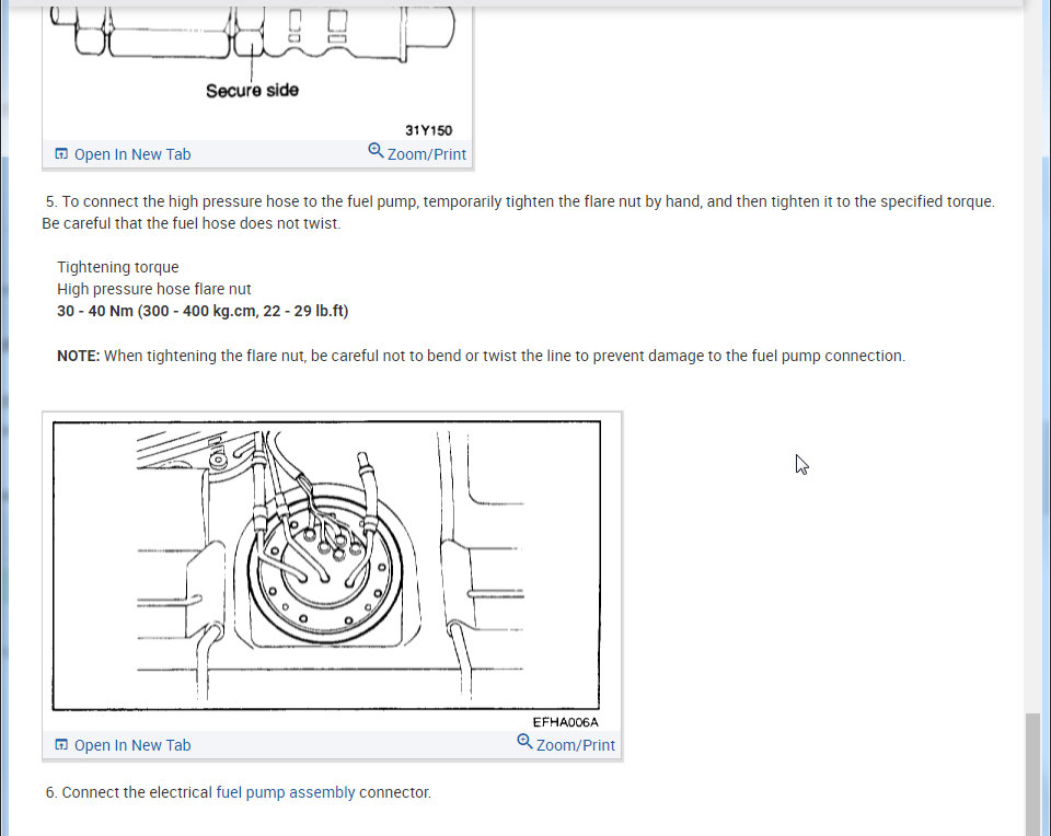

Below you will find the process from the manual that will help with this as well. Please let us know if you have other questions. Thanks
