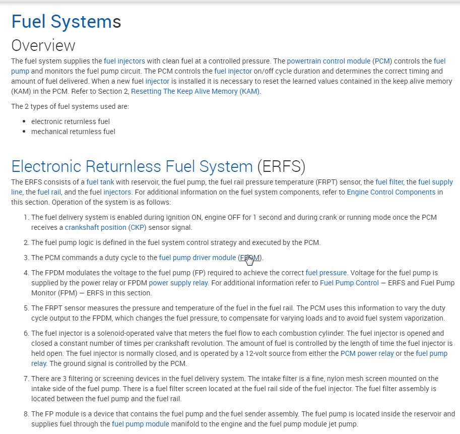

Fuel pump won't stay running after you start it.

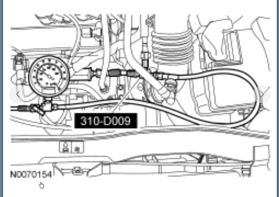

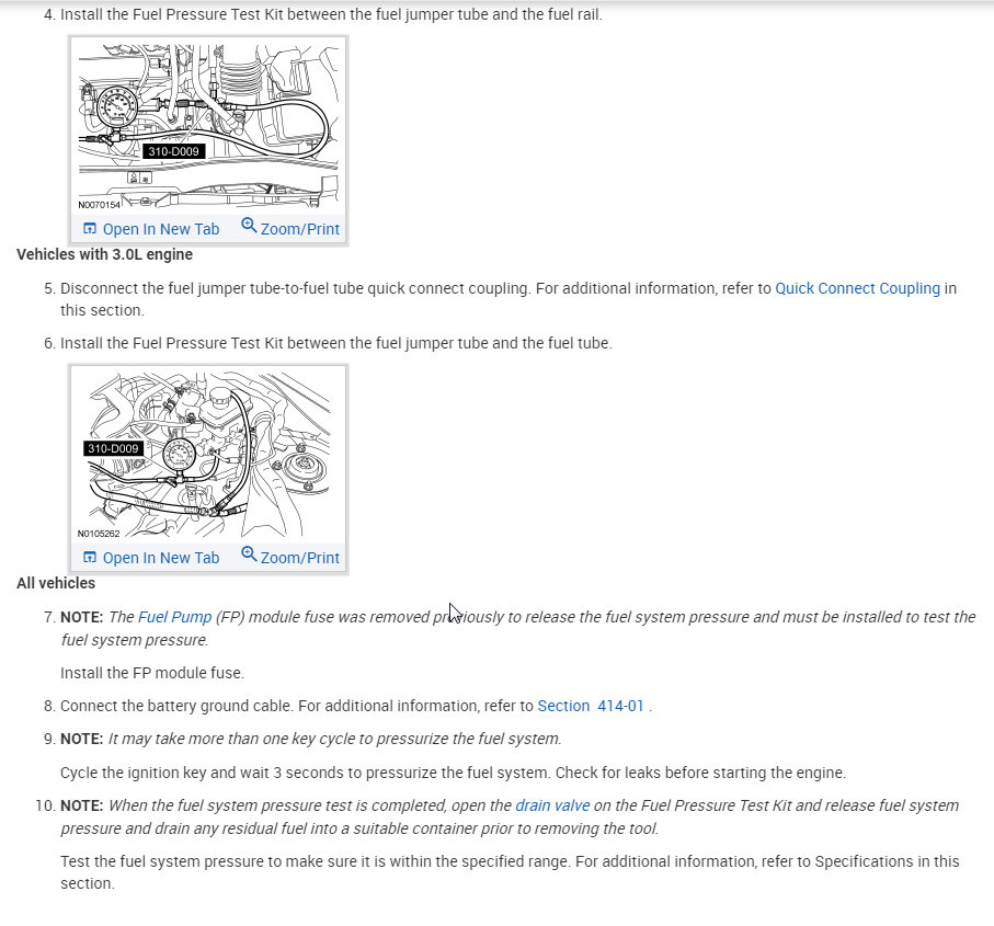

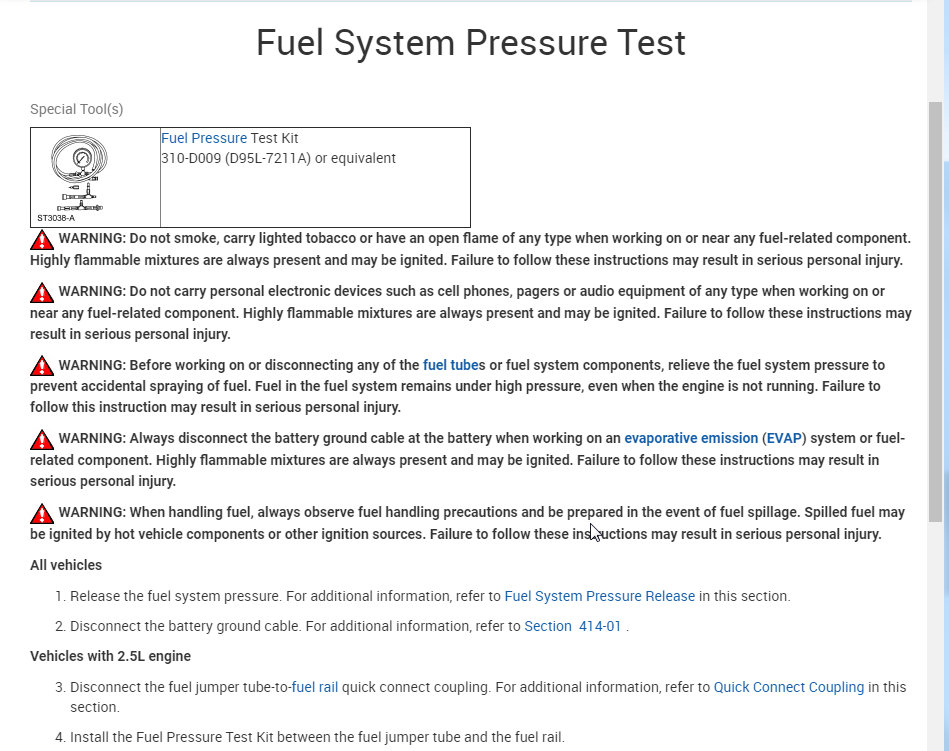

I would suggest starting with monitoring fuel pressure when this cuts off and when you first turn the key on.

I've change the fuel pump and the fuel pump diver module. It will start then the fuel pump shuts off, could it be the oil pressure sensor?

The pump will run for five seconds then stop.
Saturday, December 7th, 2019 AT 11:22 AM

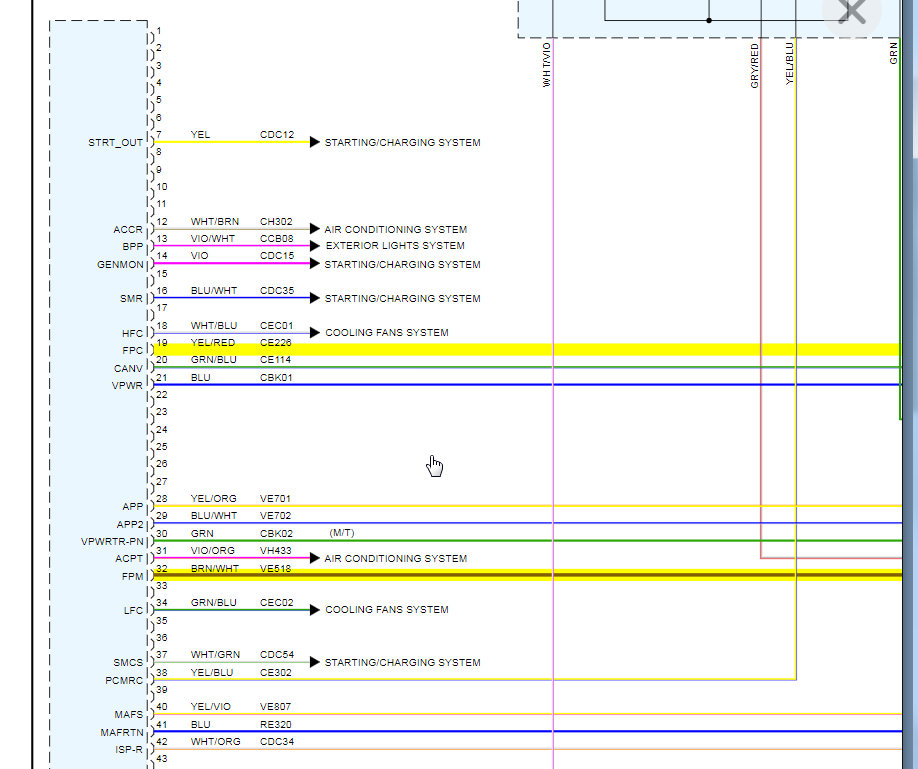

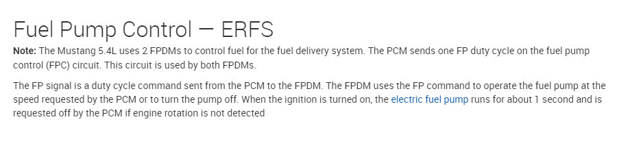

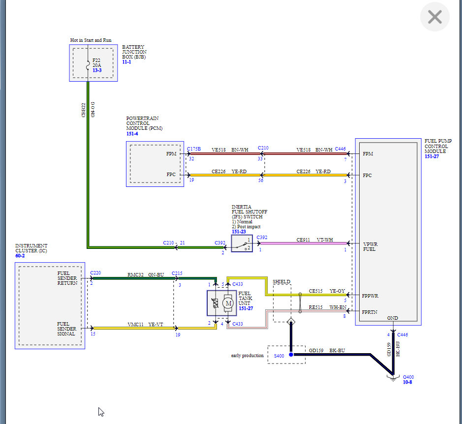

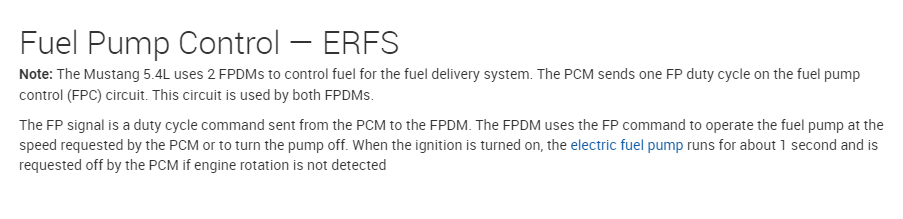

Okay. You are correct that the module directly controls the pump but the PCM is what is considered the control module. Ultimately the PCM is what tells the FPCM what to do. I would go to either the PCM or the FPCM and measure voltage on the FPC wire. The FPM is the monitor circuit and the PCM uses this to determine if there is an issue. If this is shutting it off, then there may be a code. If we haven't checked for codes, I would do this before replacing the PCM. It could be a PCM issue but it could also be something that the PCM is seeing that is causing it to cut the pump off.

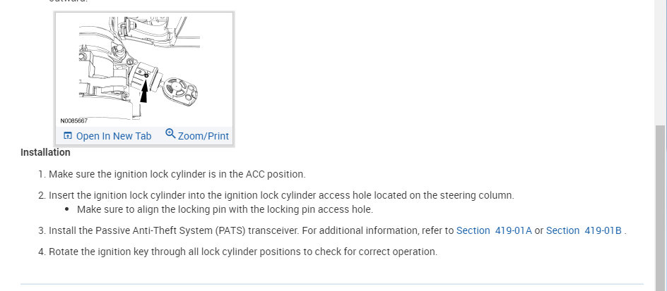

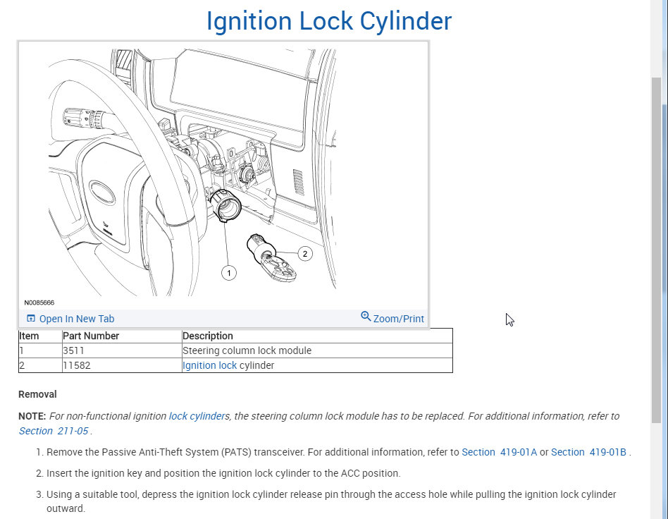

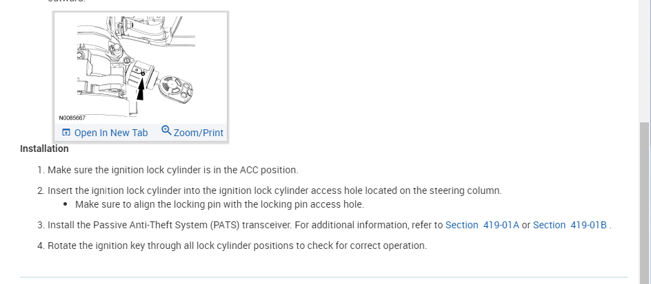

Could it be the Ignition Lock Cylinder? The key is hard to turn and I have to push hard to make it start and I have to play with it get it to start.
Sunday, December 8th, 2019 AT 6:10 AM
That is interesting. Yes. It could definitely be the issue. Clearly it should not be that way so even if it doesn't fix this it should be taken care of. I would go ahead and do it and see if that fixes all of it.
Sunday, December 8th, 2019 AT 7:34 PM

It fixed the key issue but it still doing the same thing.

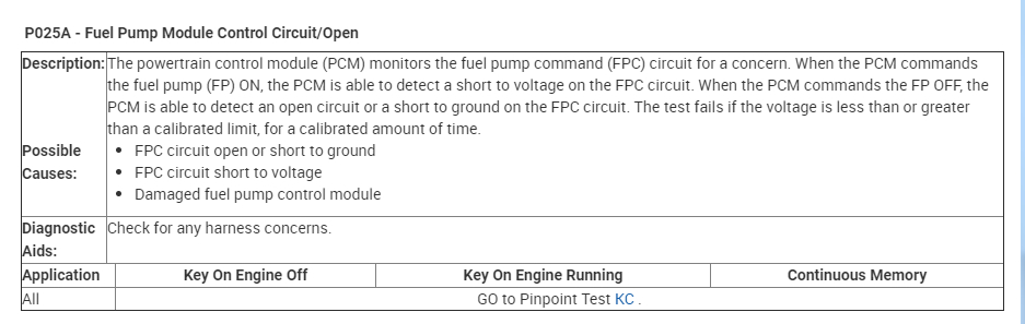

PO 25APO581 po1000UO109.
Wednesday, December 11th, 2019 AT 2:01 PM

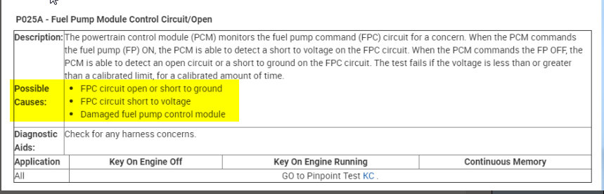

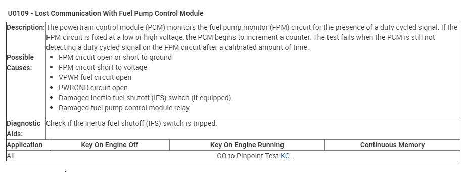

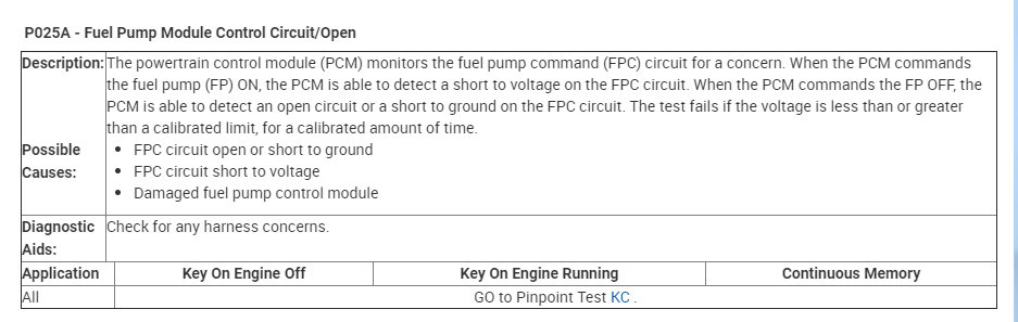

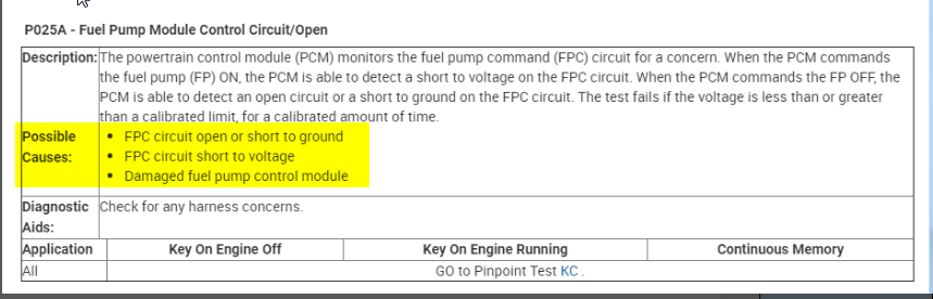

P0453 - EVAP Emission System Pressure High
P0455 - EVAP System Leak Detected
P0581 - Cruise Control Multifunction high
U0109 - Lost communication with the fuel pump module
P025A - Fuel Pump Module Control Circuit open

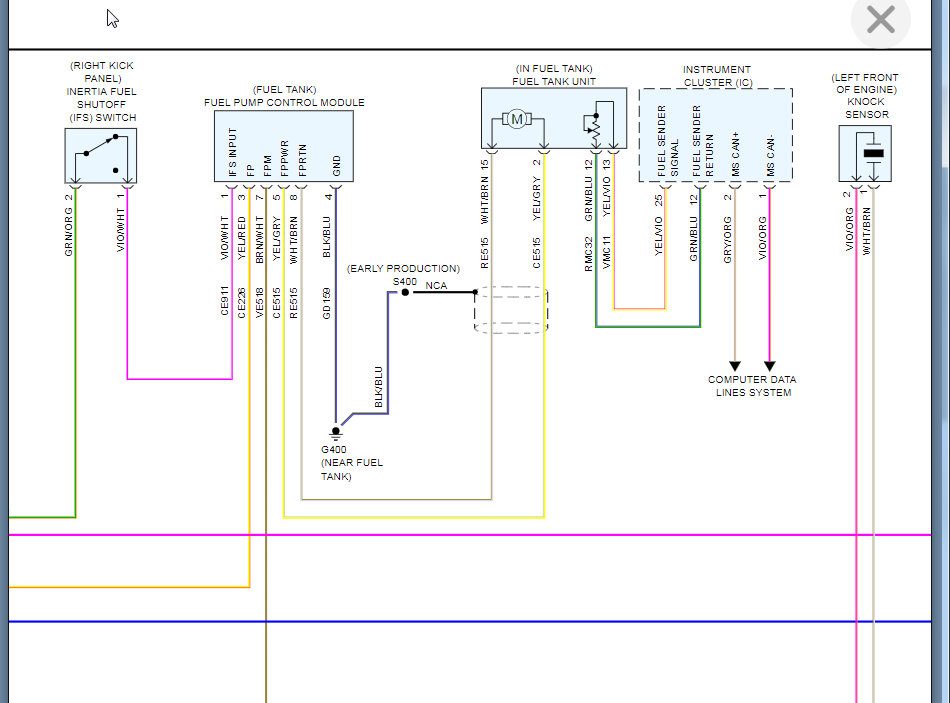

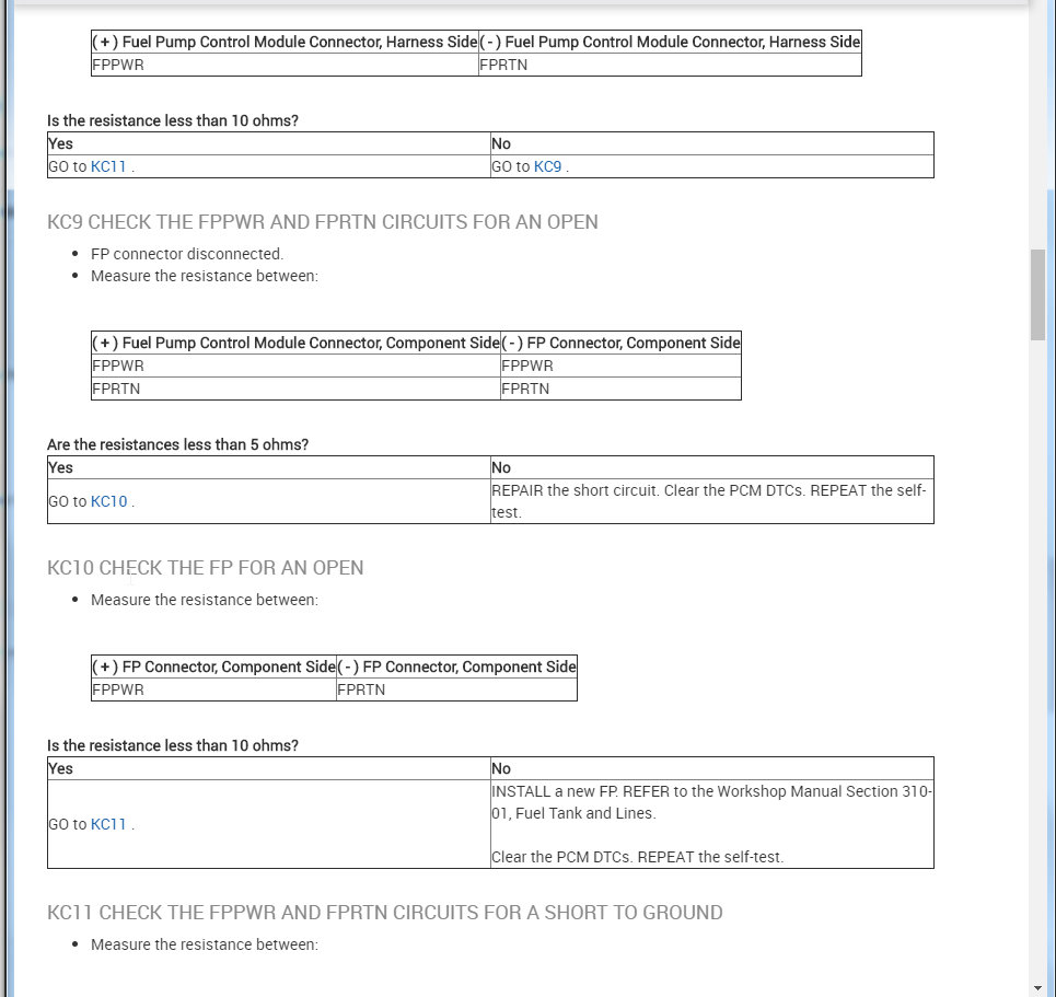

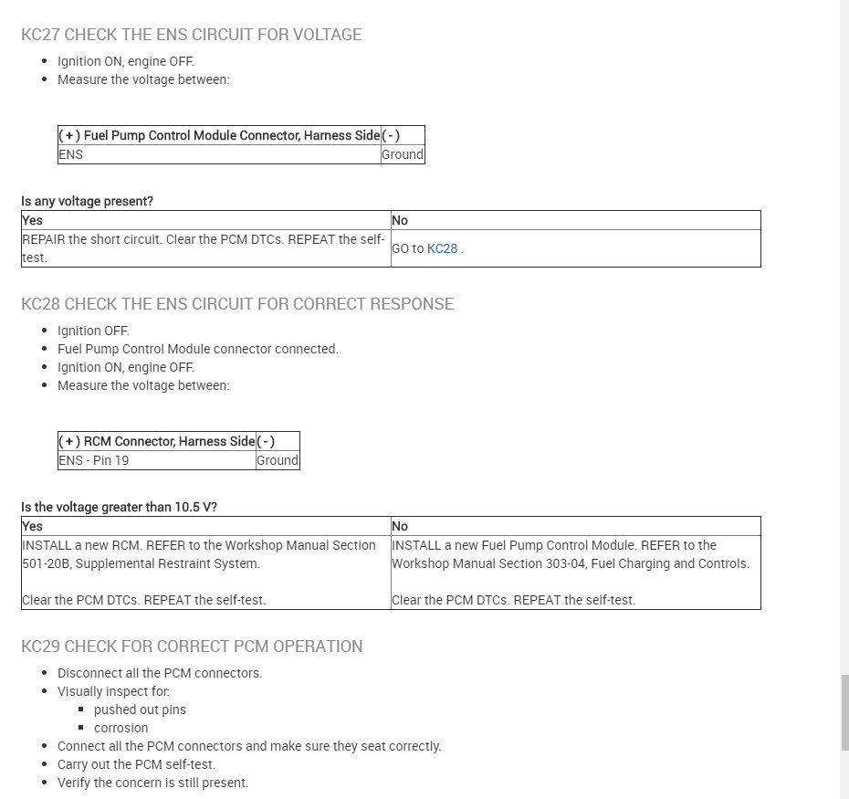

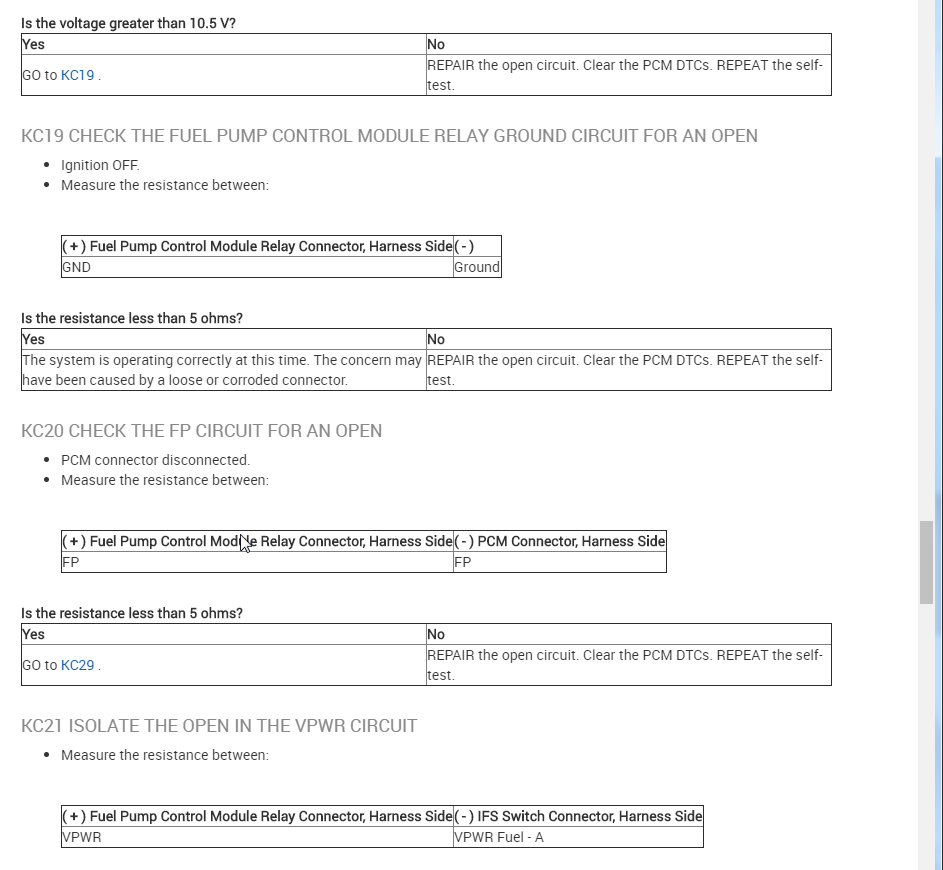

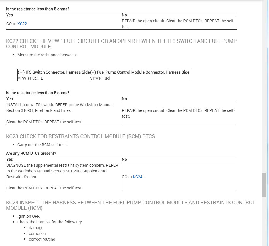

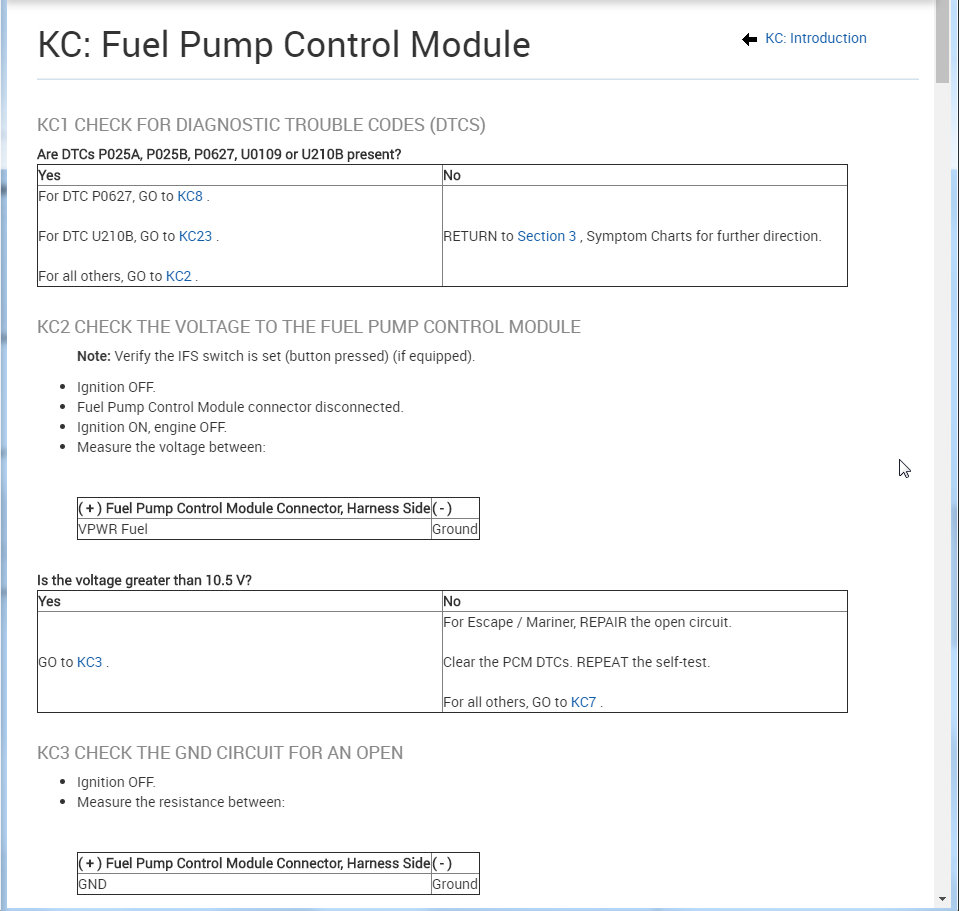

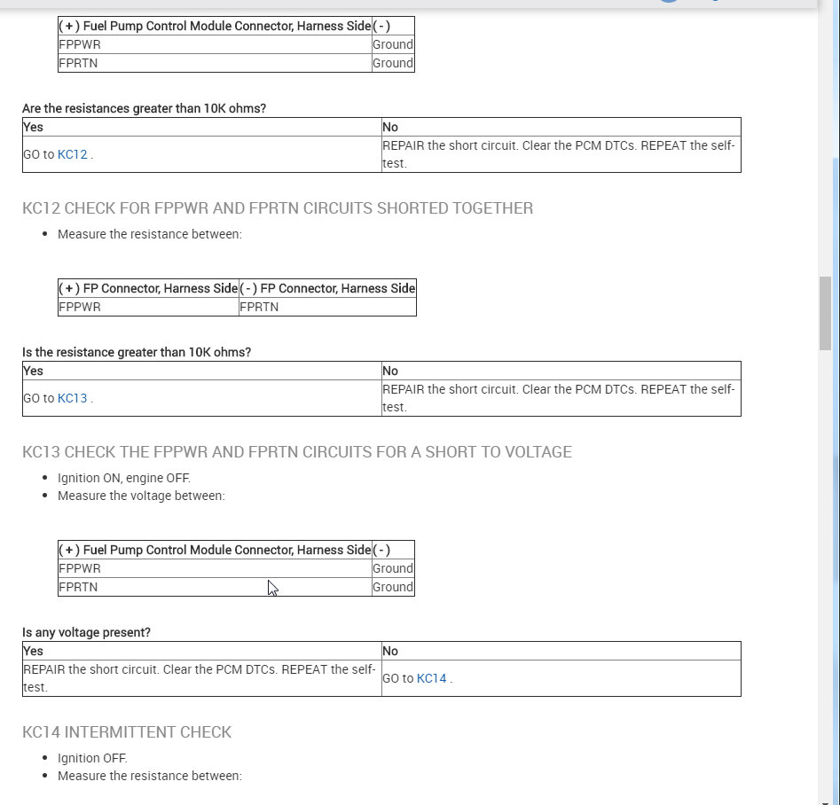

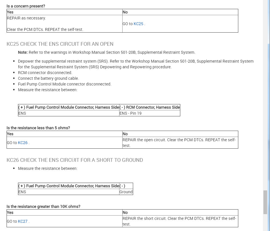

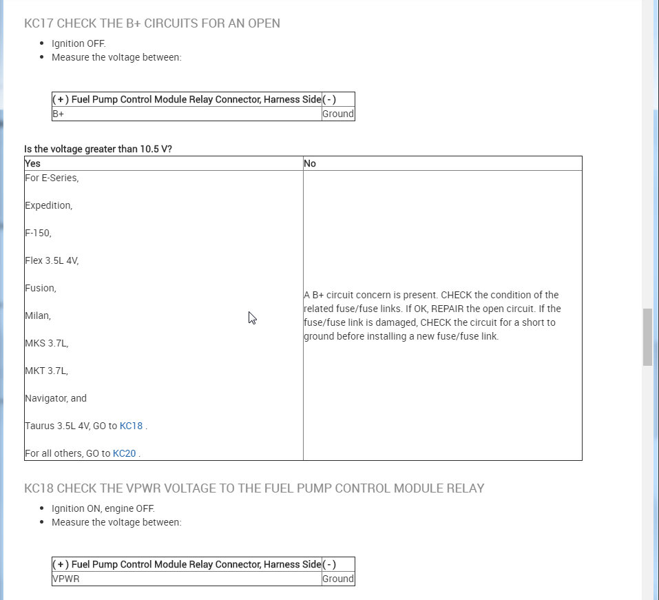

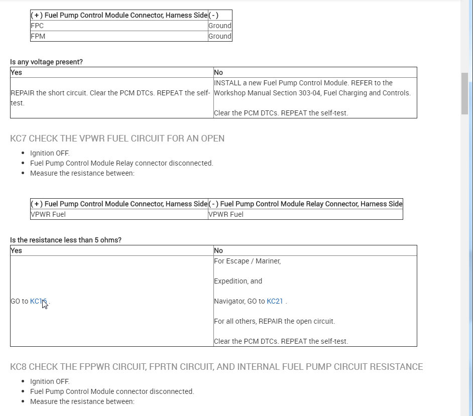

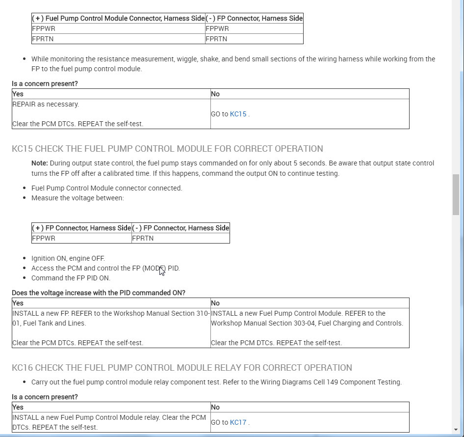

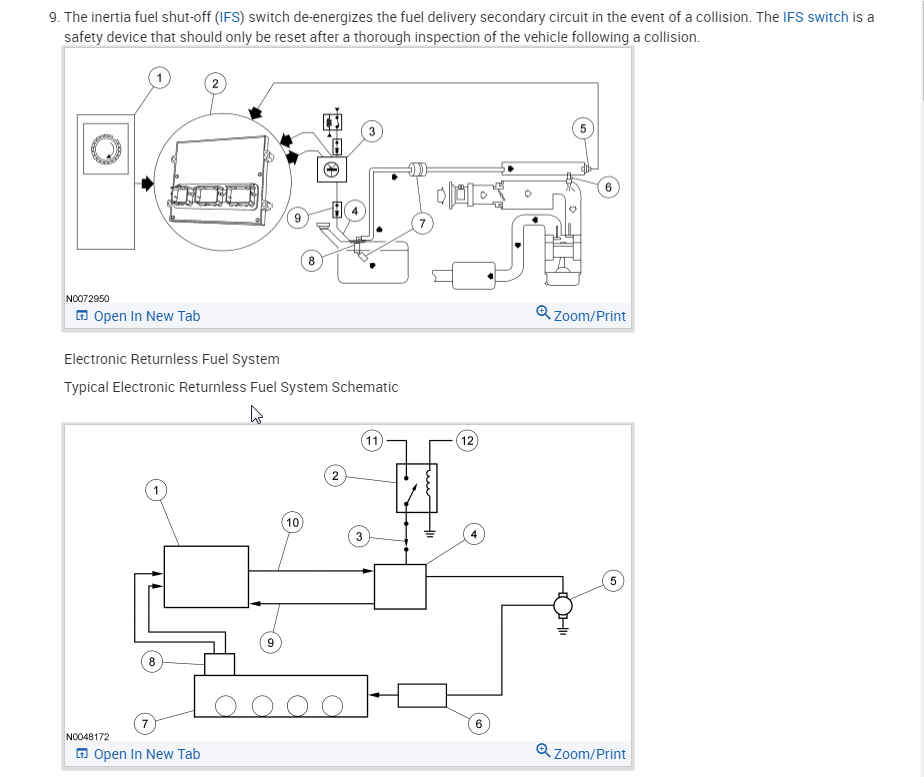

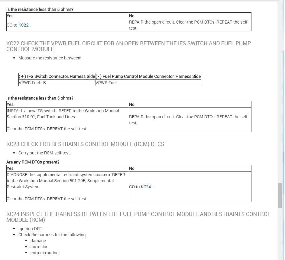

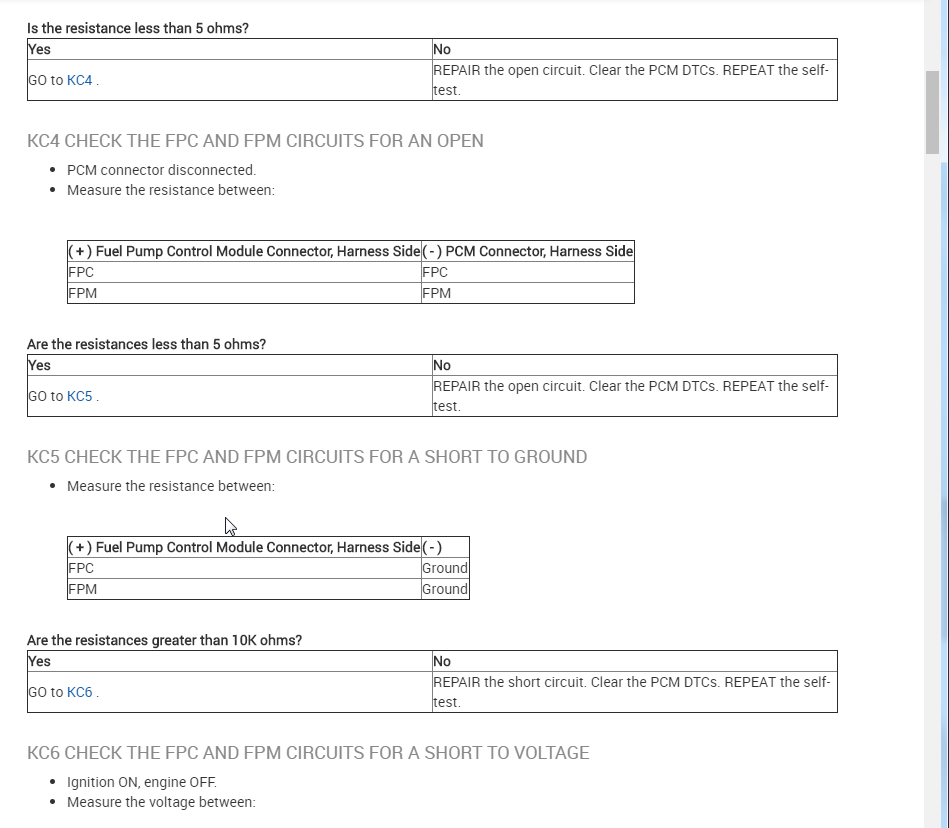

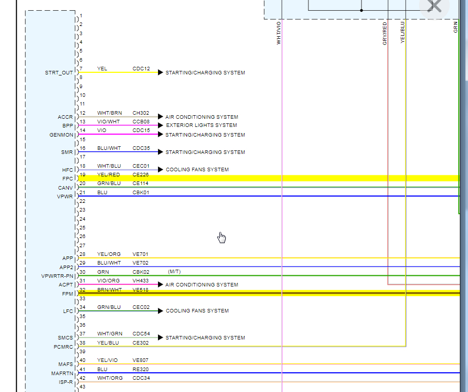

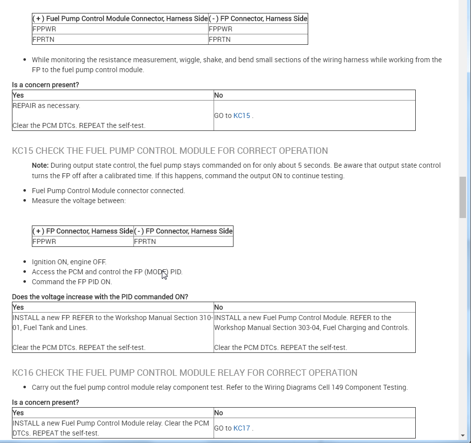

This is kind of what I suspected. You have a wiring issue. I would focus on the P025A and U0109. The other codes are not going to cause the fuel pump issue.

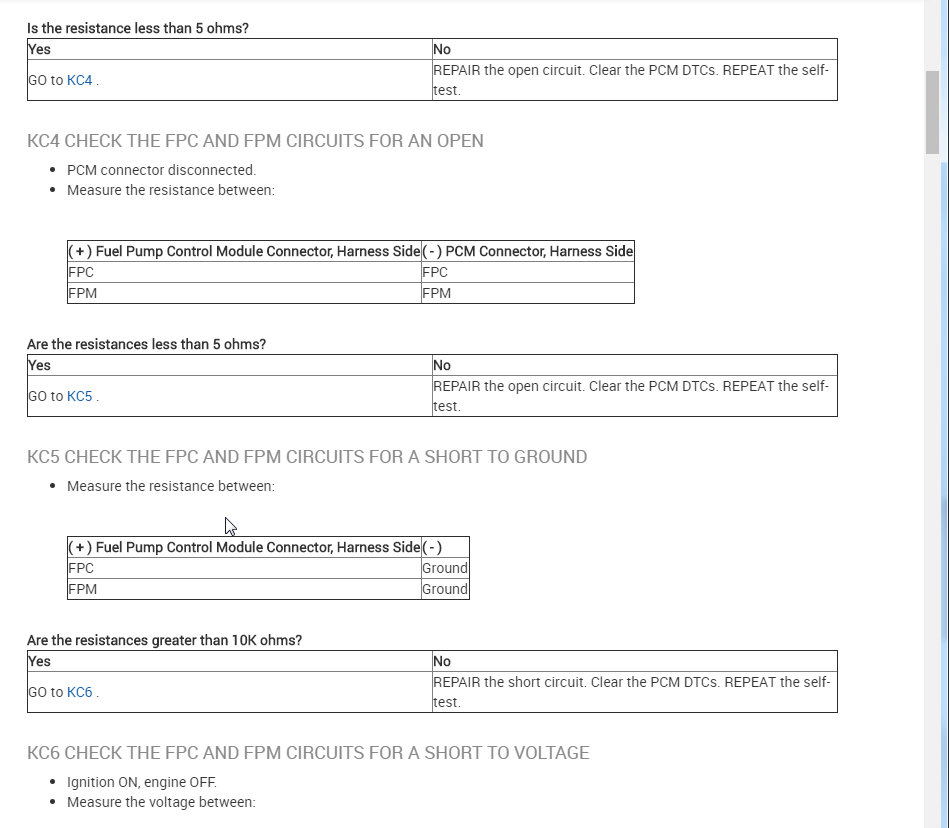

I attached the test that you need to follow. It is lengthy but should take you to the issue.
Wednesday, December 11th, 2019 AT 4:50 PM

Checked all the connections for lose or broken wires. Is there any way it could be the PCM itself, or how can I check it?
Sunday, December 15th, 2019 AT 11:47 AM

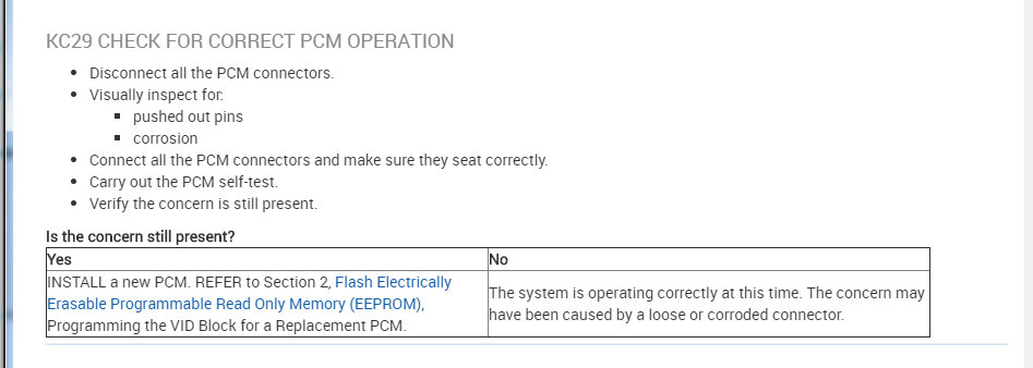

You checked the connections but did you check the wiring from end to end for an open or a short? Based on the codes that you have, a PCM is not mentioned as a possible cause so I doubt it. You have circuit codes so more than likely you have a pinched wire somewhere. The other thing named is a fuel pump but you already changed that.
You need to remove the connectors from the fuel pump and test the resistance from there all the way back up to the PCM. Start with measuring resistance from the pump to the control module. Then the control module to the PCM. I suspect one of these wires will have high resistance or even be open.
