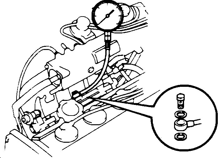

The car turns on, but turns off after 5-10 seconds I’m not sure if it’s the fuel pump. How can I find out?

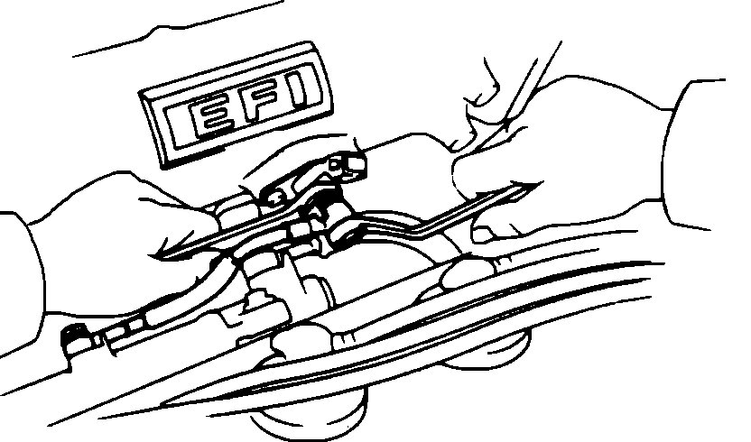

What really needs done is simple. You need to check fuel pressure. If the pressure drops off when it stalls, then it sounds like the pump. However, if pressure doesn't drop, it is most likely ignition related. There is a pick up coil in the distributor that functions as a crankshaft position sensor. It too can cause the engine to stall.
Start with checking fuel pressure. You will need a gauge. Most parts stores will lend it to you. Watch the pressure until the engine stalls. Does pressure drop?

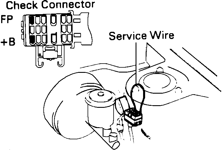

3. Using a service wire, short terminals +B and FP on the engine check connector. The fuel pump should operate.
Shorting Fuel Pump Test Terminals
Pic 1
4. Feel the fuel hose coming from the fuel filter to the fuel rail. The fuel flow should be felt, if the fuel pump is operating.
EFI Fuel Filter
pic 2
5. If not, perform pressure test below.
6. If fuel flow is felt, fuel pump operation is indicated, although fuel pressure may not be correct. For an accurate diagnosis, perform pressure test.

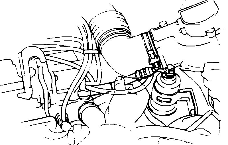

3. Remove fuel delivery pipe between Cold Start Injector and fuel rail. Use caution if the fuel system is still under pressure.
Disconnecting Cold Start Injector Delivery Pipe
pic 3
4. Connect a suitable fuel pressure gauge to the fuel rail using the union bolt and gaskets to provide a tight seal.
Connecting Fuel Pressure Gauge
pic 4

6. Using a service wire, short terminals +B and FP on the engine check connector. The fuel pump should operate and cause the pressure gauge to deflect.
FUEL PRESSURE: 38 - 44 PSI (265 - 304 kPa)
7. If pressure is low, check fuel pump output and/or fuel filter for restrictions. If pressure is high, refer to FUEL PRESSURE REGULATOR/FUEL RAIL and test components.
