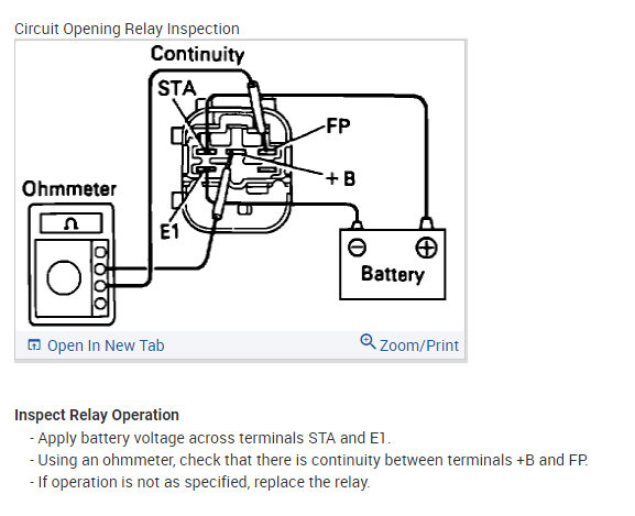

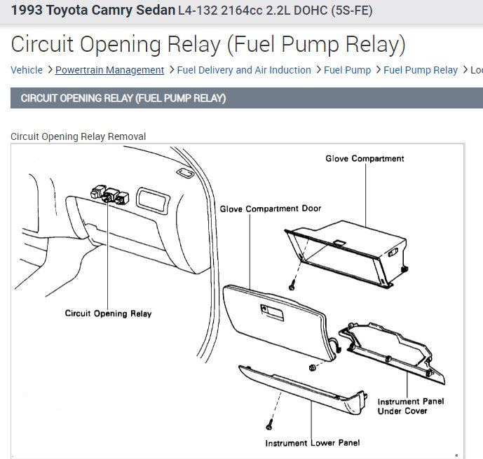

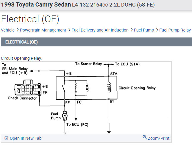

If you are not getting any power to the fuel pump, then the first thing needs to be checked is the fuel pump relay.
That relay is located behind the glove box. You will have to remove the glove box to access it (see diagram).
Visually inspect the relay for any corrosion or burnt pin(s).

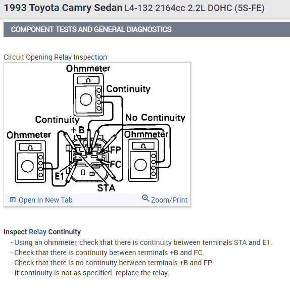

You can also test the relay as well:
