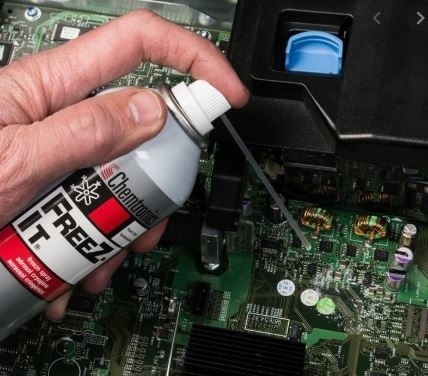

Well, depending on which one but pretty much yes. Some integrated circuit fail only when heated or cooled though. You can get whats called freez-it and it will instantly freeze whatever you spray it on to sub zero. If it was in my shop I would take the PCM cover off and shoot the chips with it with the car running if I didn't see any melting evidence. A partially failing chip will completely fail if frozen. If the EGR proves to be working properly or is replaced that is the next thing I would do. Here is a pic of what I'm talking about.

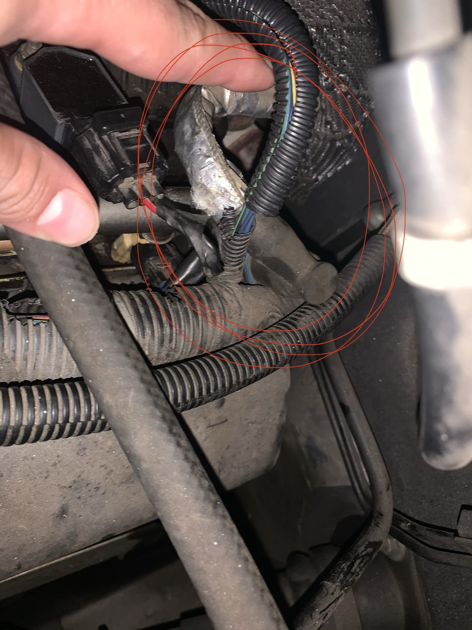

I will post the pic, while I was under the hood, I wiggled and pushed on what I think is the PCV while it was stuttering and it seemed to make it stop. Not sure if a coincidence but seemed to happen 3-4 times.

It doesn't look like one if I'm seeing it correctly. If it had an effect then we need to look closer at it though. Does it have any vacuum lines or wires coning from it? If so, how many pins are in the wire connector for it. It looks like part of the evap system to me.
Let me know And I'll try to ID it. Look, for a part number on it.

So from what I’ve pulled up in forums and online that is the crankcase vent to intake manifold tube. That rubber plug at the end is attached to the PCV valve. (It’s not on the oil filler tube on this model) That tube would be a vacuum line right?

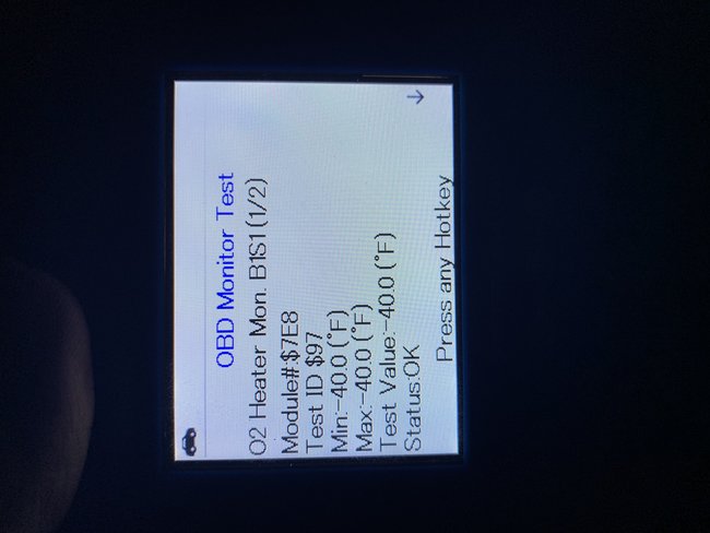

It’s the first time seeing the code, it was pending. From what I’m seeing o2 sensors or the sensor heaters seem to be most frequent reason for that. I do remember Kenny mentioning the o2 sensors as well. I do have the o2 heater sensor test on my scanner. I’ve looked at it before but not sure what exactly that test does. I do remember looking at the test after driving for a bit and it was showing -40 degree. I’ll attach the pic I took. I think I’ve mentioned it on this thread before but not sure.

I went ahead and looked at the O2 sensor heater test as soon as I stopped after a good 25 minute drive. All of my sensors up and down stream and both banks showed min and max of -40 degrees and a test value of -40 as well. I pulled up pictures from July 4th where each sensor was a min of -40 and a max of 536 and each sensor had a different temp. B2s1 was at 113 that day and B1S1 was at 77.
Not sure if this means anything at all but thought it would be worth mentioning just in case.
Thursday, August 13th, 2020 AT 4:56 PM

Just drove back, not much drivability issues just a couple little bumps and sputters. Had live data on my scanner and made sure it went into closed loop. Got back and parked and looked at the scanner and fuel system one was in open loop-fault.
Decided to go ahead and check the same O2 sensor heater test and this time they were showing readings. Min -40 Max 536 with a temp of 113 for b1s1 and 122 for b2s2.
I didn’t have an engine light on but went ahead and ran a scan and I had p0131 pending. O2 circuit low voltage b1s1
Can the sensors be causing all these issues?

Well, if the O2's were messing up the code would be there. What about the PCM have you been able to look at its PCMs circuit board yet?

Is p0131 not an o2 code?
Thursday, August 13th, 2020 AT 8:53 PM
4DRTOM
  • 467 POSTS
Yes, but it's telling you the mixture is not right not that the sensor is bad. Meaning the computer isn't working right.
