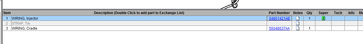

Agreed. If the injector circuit code is back then we need to run through that testing and find it but I would not be surprised if the injector harness is the issue as I have seen that a number of times on 4.7L.
Wednesday, July 22nd, 2020 AT 6:40 PM
NYC2NC82
  • 96 POSTS

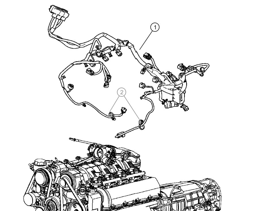

I was thinking about the harness in general since I’ve have the codes on different cylinders. How bad is it to get that done?
Wednesday, July 22nd, 2020 AT 6:46 PM
It is not bad. The manuals don't actually list a process for this however I attached the illustration of it. Just follow the harness from the PCM down over the engine to the injectors. Not much has to come off to remove it as it has the wiring cradles that hold it in place.

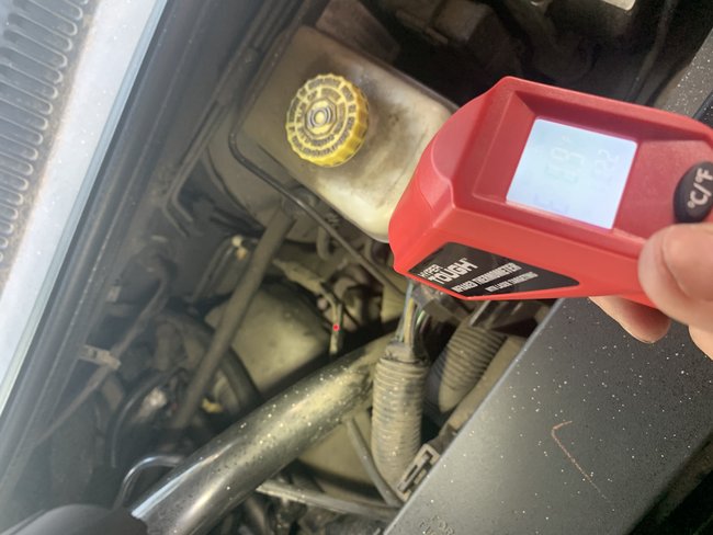

Okay, picked up my infrared thermometer. Didn’t drive a lot but hotter day and got some
sputtering going. Car was sputtering a little when I parked and let it idle and started taking temperatures all over the engine bay. Hottest temperature reading was about 180 and that was the spot in between the alternator and A/C compressor at the top. The injectors and fuel rail were about 150-175 at various points. Pretty much everywhere I could get close and point the beam around the block and manifold it was 150-180 range. Radiator was 95-100 most places I pointed. PCM area got as high as 120. I will say shortly after opening the hood the sputtering stopped and I would guess the temperatures should be higher with the hood shut.

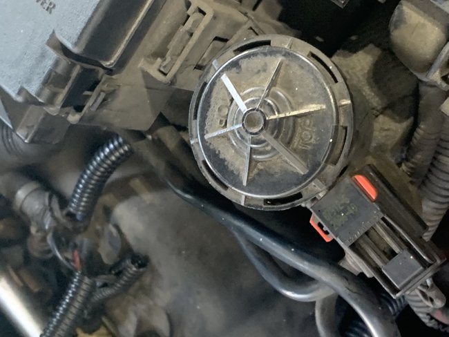

I noticed some smoke coming from the driver side close to the firewall. Was hard to tell but looks like it was coming from a hose or wire that connects to what I believe is the purge valve solenoid. I will post pics. Furthermore I took temperatures from the line on one end to the other and it was about 150-160 except for the area that looks like a connector (will post pic as well). The temperature there was reaching up to 400+ degrees. Seemed like it was spiking when I was getting sputters but not 100% sure.
Monday, July 27th, 2020 AT 1:51 PM
NYC2NC82
  • 96 POSTS
Right about where that dot is and on that connector is where the temperatures were spiking into the 400's.

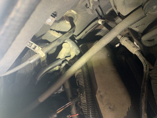

This is where it seemed like the smoke was coming from:
Monday, July 27th, 2020 AT 1:55 PM

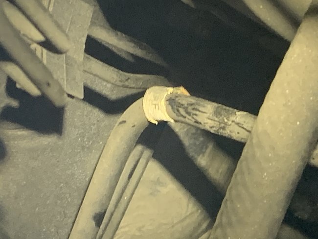

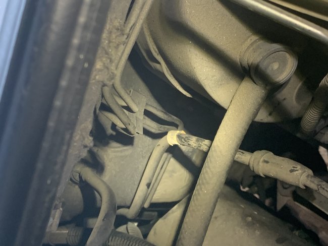

This was the other spot smoke was possibly coming from, but after a looking for a while it looked like the other spot was most likely.
Monday, July 27th, 2020 AT 1:57 PM

Just got back home. Checked that area again and the temperatures were as high as 560 degrees. Only on that section right before that connector area that connector (if that what it is) itself. Seemed like the temperatures would go up and down. It was as low as 170 at some points and jump right back up. Past the connector and before that small section The temperatures were about 150 range. Also getting p0307 now.

Okay, well there is something going on there, 400-500 degrees is pretty hot. Is there any sound like a possible exhaust leak? There might be somewhere in that area an exhaust gas circulating tube that could get that hot, but it would emit enough to make the area hot unless it was leaking. I'm going to see if I can get an image of what I'm talking about. Still though 400-500 degrees is hot. We might be onto something here. From the pic looks like you getting smoke up against the fire wall, Am I seeing that right?

Could not tell if there was a sound or not. Yes, the smoke was by the firewall? Drivers side. It looked like it was coming from that second pic I posted. Those high temperatures see only coming from a small section of that tube.
