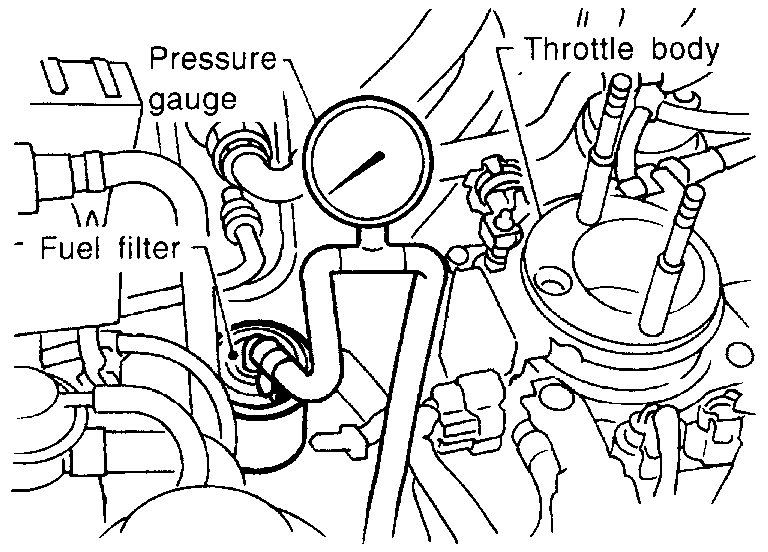

Need to know the fuel pressure on this truck, furthermore it start a few seconds then shuts off. Ignition is good sparks all around but still shuts off a few seconds. If the cam and crank not align will it be able to start then shuts off later or it wont start all
The fuel pressure reading I'm getting is about 33psi I thought it was suppose to be between 60-80 psi on this truck-Please let me know-Thank You

Pressure at idle should be at 34, so you are right on target. Here are the directions for testing. The pics attached correlate with the pics. Just making sure you did it how the manual says to do it.

1. Release fuel pressure to zero.
2. Disconnect fuel hose between fuel filter and fuel tube (engine side).
Pic 1
3. Install pressure gauge between fuel filter and fuel tube.
4. Start engine and check for fuel leakage.
5. Read the indication of fuel pressure gauge.
At idling:
Approximately 235 kPa (2.4 kg/cm2, 34 psi)
A few seconds after ignition switch is turned OFF to ON:
Approximately 294 kPa (3.0 kg/cm2, 43 psi)

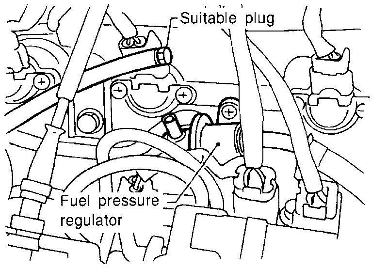

6. Stop engine and disconnect fuel pressure regulator vacuum hose from intake manifold.
Pic 2
7. Plug intake manifold with a rubber cap.

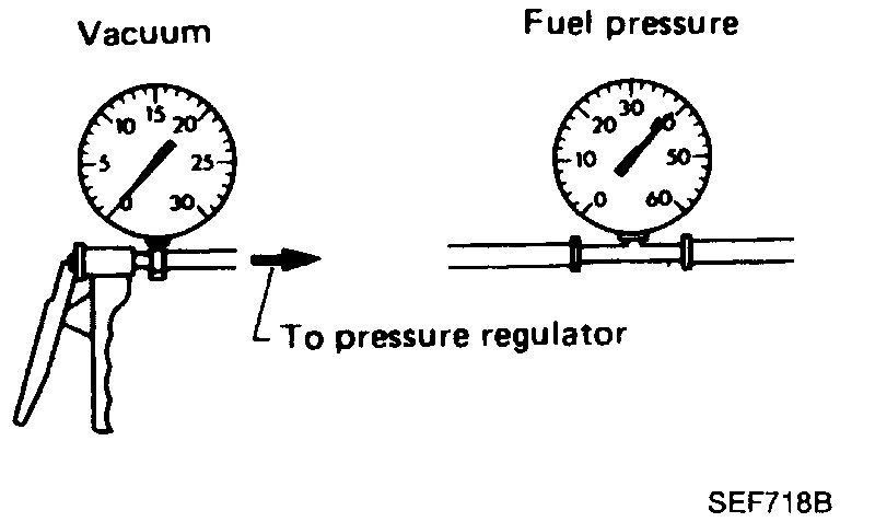

8. Connect variable vacuum source to fuel pressure regulator.
Vacuum/fuel Pressure Test
Pic 3
9. Start engine and read indication of fuel pressure gauge as vacuum is changed.
Fuel pressure should decrease as vacuum increases. If results are unsatisfactory, replace fuel pressure regulator.

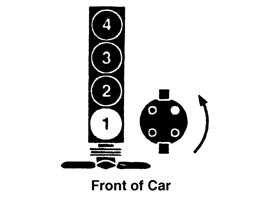

Joe, can you verify the rotation of the distributor one reference from here has the distributor turning clockwise the other is c/clockwise? I'm getting confuse here don't know which to follow.
Wednesday, February 12th, 2020 AT 8:54 PM
  • 110,194 POSTS
That isn't listed in the manuals, but it should be clockwise. Can you crank it to confirm?
Wednesday, February 12th, 2020 AT 9:13 PM
PACIFICISLANDER
  • 240 POSTS
Joe, this one it's moving c/clockwise. This is how it's turning when cranking:
Wednesday, February 12th, 2020 AT 9:24 PM
  • 110,194 POSTS
Glad you found that. I honestly thought it was clockwise.
