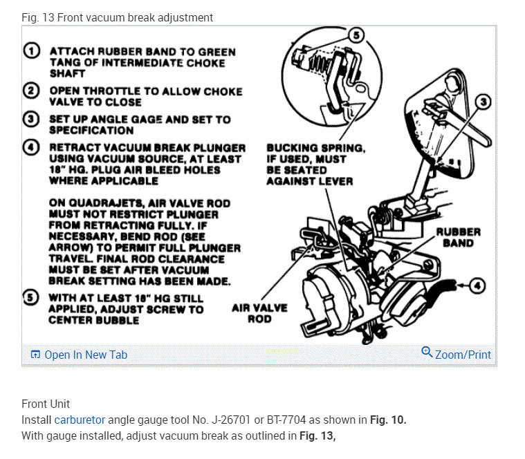

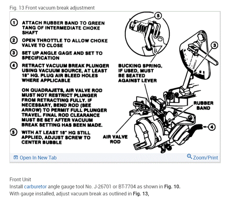

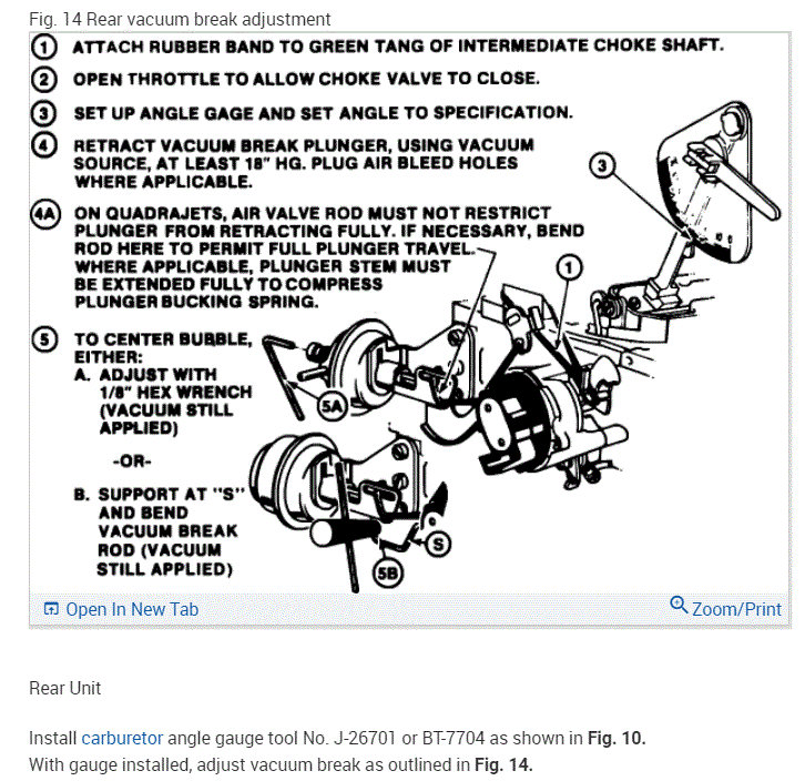

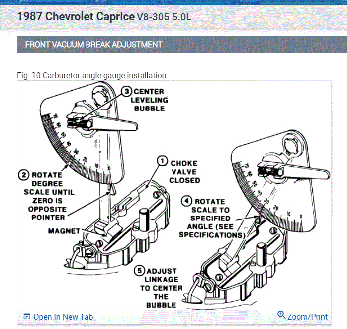

Can you send me the adjustment specs for this carburetor if there are any? I might try to do it myself.
Wednesday, April 6th, 2022 AT 8:00 PM

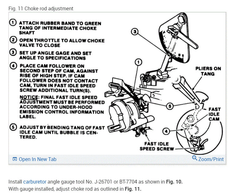

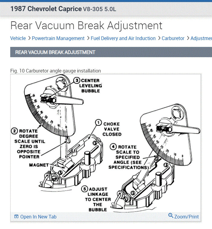

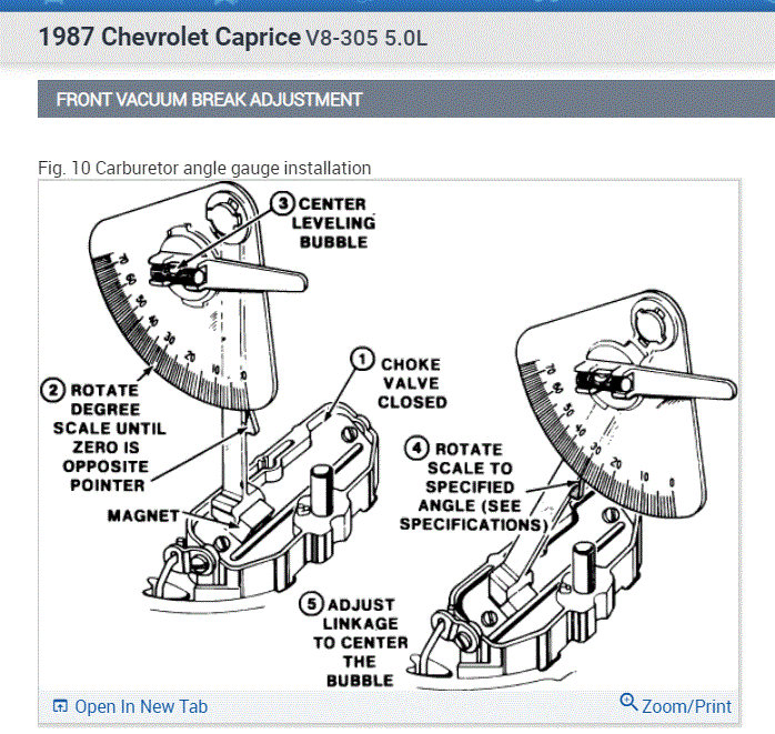

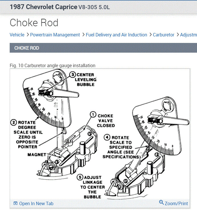

  • 110,192 POSTS
The only adjustments I have are for the choke and front and rear vacuum break adjustment. I attached them below. If the choke isn't opening, that certainly will cause a rich fuel mixture.

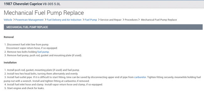

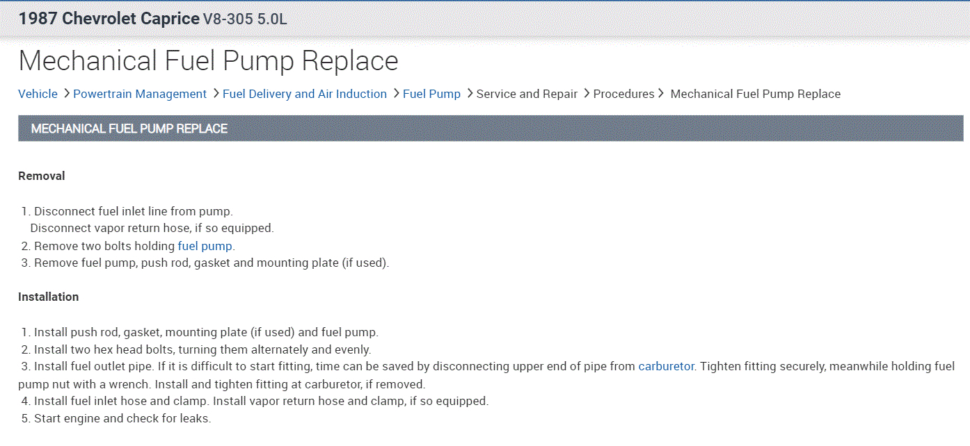

  • 275 POSTS
And can I get the torque specs for the fuel pump mechanical? I'm just going to get rid of the electric one and go back to that.
Friday, April 15th, 2022 AT 9:34 PM
  • 110,192 POSTS
The bolts are to be tightened to 30 ft/lbs. I attached the directions below. Make sure when you tighten it, do it evenly. The housing is aluminum and it's not hard to break one of the ears off.
