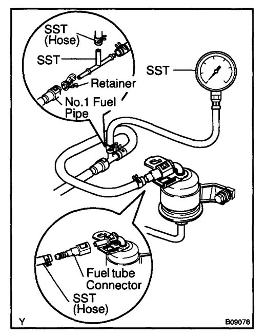

My 2002 Avalon has codes PO302 and PO420. The check engine light was flashing. The engine was shutting off. The spark plugs were fouled and replace along with 3 ignition coils. The cat was replaced. The oil had gas in it. The oil and filter was changed.
Where did the gas in the oil come from? If the fuel injectors are leaking, can they be sufficiently cleaned with a fuel injection induction service by connecting to the fuel service port and running a can of fuel cleaner directly through the injectors? Where is the service port located? Would this has a good chance of solving the problem of the gas leak?
What do you advise?

If you had a cylinder misfire, there is a good chance that is where the fuel came from. If the plug isn't burning the fuel, often times it will make its way into the oil via the cylinder walls. Once the gas washes the oil from the cylinder walls, compression will lower and it is easier for it to happen.
One other thing, have you checked fuel pressure? If the regulator has failed and pressure is too high, excessive fuel will be injected into the engine.
Since you have already changed the oil, is there still gas getting into it since it is now running correctly? Also, the service port doesn't exist on this vehicle. To check fuel pressure, you have to install a T between the fuel filter and engine. See picture 1
Do me a favor. Check fuel pressure and confirm that it is within the manufacturer's specs. Here are the specifications:
Fuel Pressure 44 to 50 psi
If you find it is too high, let me know. Also, since the engine is now running properly, drive it and see if the problem continues. I have a feeling that since the engine is now burning all the fuel, it won't be a problem anymore.
