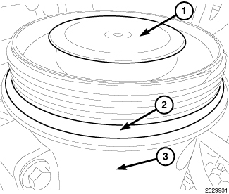

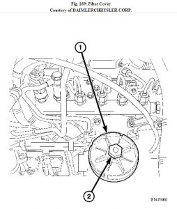

Trying to see if I would be able to change fuel filters myself. Have some knowledge of basic servicing of vehicle.
Thanks
Sunday, November 11th, 2018 AT 12:28 PM
21 Replies
  • 110,194 POSTS
This video will show you how with instructions below
https://youtu.be/6de-1mIpzi8
There are actually two filters. And if you have some mechanical abilities, you should be fine.
I am going to provide removal and install directions for both filters. All attached pictures correlate with these directions.
________________

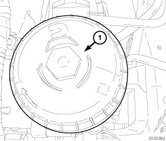

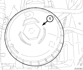

Filter 1
FUEL FILTER 1
NOTE:
Refer to maintenance schedules in this manual, or the Owner's Manual for recommended fuel filter replacement intervals.
Clean all debris from around filter canister (1) and canister cover.
Using a socket, rotate the fuel filter housing cover (1) counter clockwise and remove cover (1).
Remove and discard the O-ring (2).
Remove fuel filter element (1).
___________________
Here are the replacement directions. At the end of the directions, it explains how to reset the computer for the service. See picture 5 for reset.

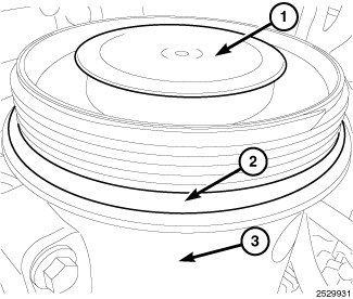

FUEL FILTER 1
CAUTION:
Do not pre-fill the fuel filter with fuel. Severe damage to fuel system and injection system components may result.
NOTE:
The engine has a self-priming low-pressure fuel system (Refer to 14 - Fuel System/Fuel Delivery - Standard Procedure) .
NOTE:
DO NOT USE brake cleaner, carburetor cleaner, or similar harsh solvents for cleaning the internal housing walls.
Ensure that the internal housing wall is clean of debris before installing a new fuel filter cartridge.
Install fuel filter element (1).
Lubricate with clean engine oil and install the new O-ring (2).
Install the fuel filter housing cover (1) and tighten to 31 NÂ m (23 ft. lbs.).
_________ Reset

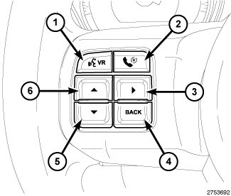

Once the fuel filter maintenance has been preformed, the Fuel Filter Life monitor can be reset by:
Vehicle in RUN with engine OFF (no RPM)
Hold the right arrow (3) down to reset the monitor.

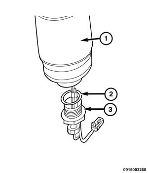

Filter 2
FUEL FILTER 2
NOTE:
Disconnect and isolate both of the negative battery cables.
Raise and support the vehicle (Refer to 04 - Vehicle Quick Reference/Hoisting/Standard Procedure) .
Clean all debris from around the secondary fuel filter area.
Open the drain and drain fuel from fuel filter.
Disconnect the water in fuel sensor wire harness connector.
Remove the fuel drain/water in fuel sensor assembly (3).
________________________________________
FUEL FILTER 2 install
Install the secondary fuel filter element (1) and tighten finger tight. Tighten the fuel filter an additional  turn.
Using a new O-ring seal (2), install the fuel drain/water in fuel sensor assembly (3) and securely tighten.

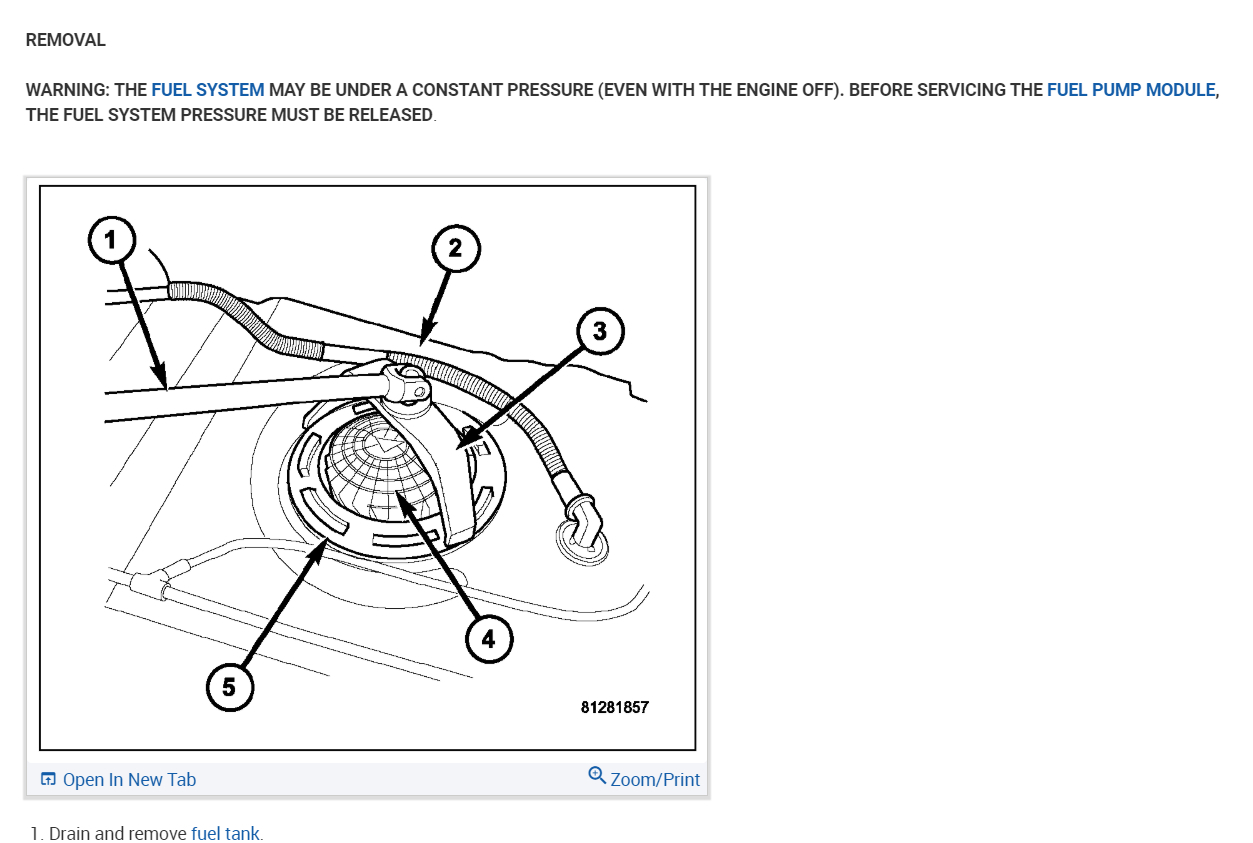

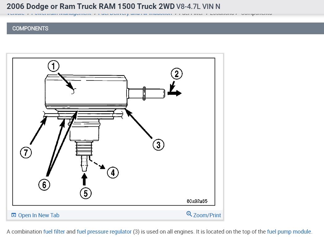

Where is the gas filter located?
Thursday, August 27th, 2020 AT 11:47 AM (Merged)
  • 75,992 POSTS

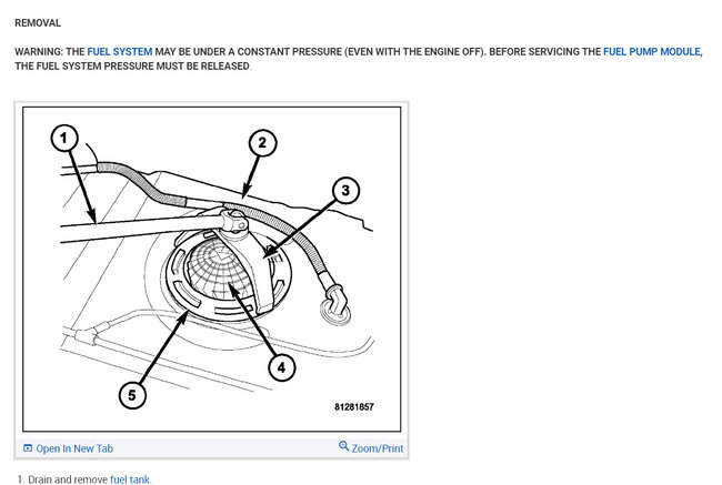

The fuel pump module assembly is located on the top of the fuel tank. The complete assembly contains the following components:
This video will help
A combination fuel filter/fuel pressure regulator
A separate fuel pick-up, or inlet filter
An electric fuel pump
A lockring to retain pump module to tank
A soft gasket between tank flange and module
A fuel gauge sending unit (fuel level sensor)
Fuel line connection
The fuel gauge sending unit may be serviced separately. If the electrical fuel pump, primary inlet filter, fuel filter or fuel pressure regulator require service, the fuel pump module must be replaced.

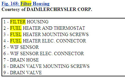

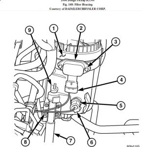

Where is the fuel filter located on a diesel Ram 3500. And what is the procedure to replace the filter.
SERVICE WRITER
  • 9,123 POSTS
https://www.2carpros.com/forum/automotive_pictures/30961_die_3.jpg
https://www.2carpros.com/forum/automotive_pictures/30961_die1_1.jpg
https://www.2carpros.com/forum/automotive_pictures/30961_die2_1.jpg
https://www.2carpros.com/forum/automotive_pictures/30961_die3_1.jpg

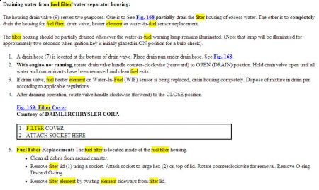

STEVEV2006
  • 2006 DODGE RAM
  • 6 CYL
  • 4WD
  • 43,000 MILES
Valve to release water? Do I just unscrew cap and replace old filter with new? Thanks Steve
Thursday, August 27th, 2020 AT 11:48 AM (Merged)
