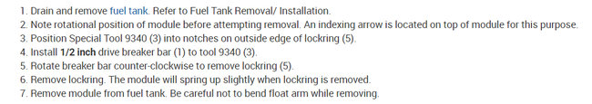

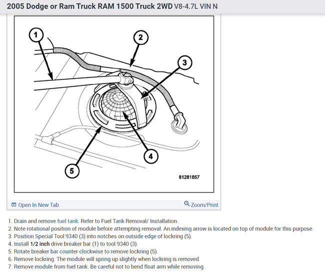

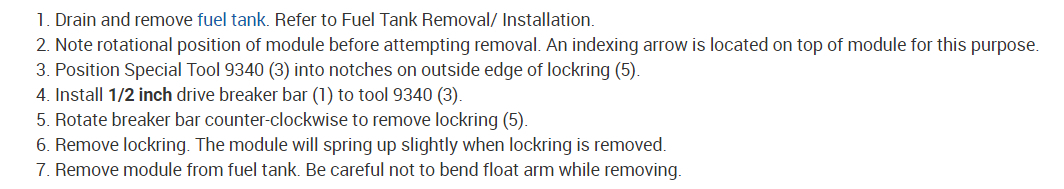

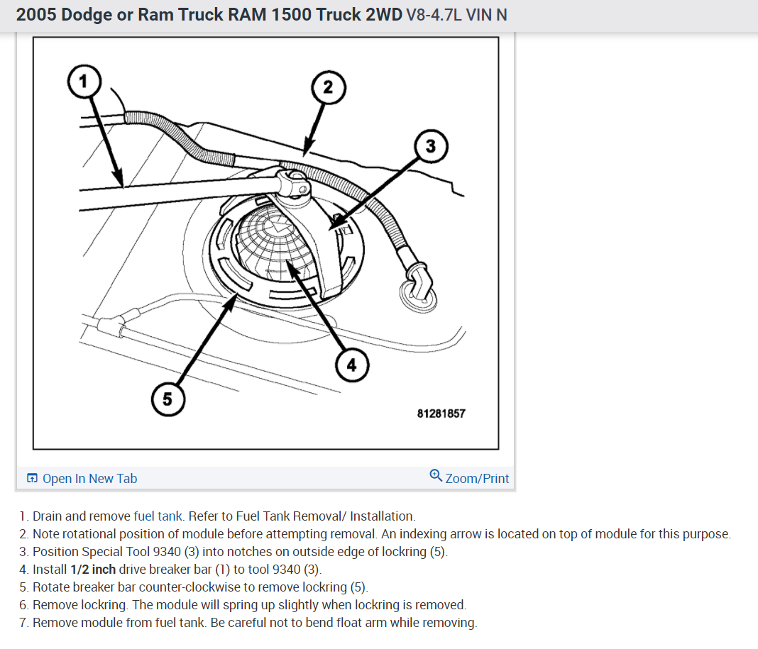

The fuel pressure regulator is part of the fuel pump I have included instructions in the diagrams below to show you how to replace it. Check out the diagrams (Below). Please let us know what happens.

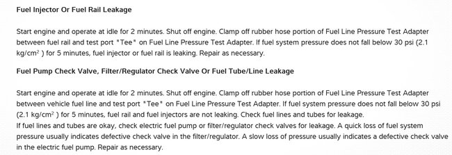

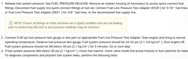

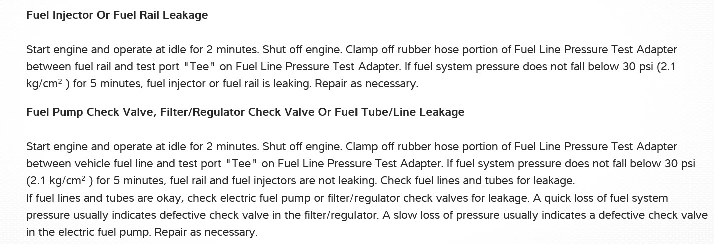

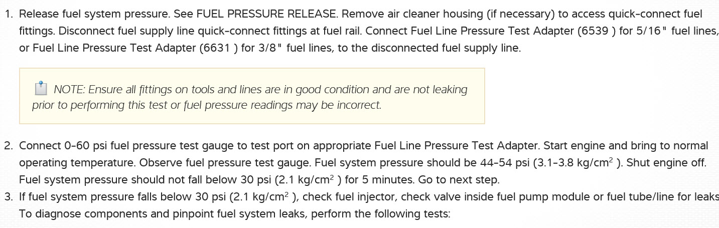

See pics for testing your fuel pump if you have the old regulator still you may need that as it can be a check valve inside bad. Should not drop below 30 psi for 5 minutes. Follow these instructions and you should be able to find the problem.
Monday, October 19th, 2020 AT 1:39 PM (Merged)
YUKONHEO
Ya it looses almost all pressure in about 6 minutes, no leaks in fuel line or connections. Decided to leave the regulator alone on the pump and got another ordered to replace the current "new pump" since the regulator on it is faulty
