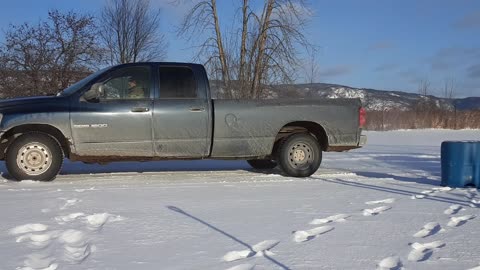

I did change front rotors and pads+clips, drove 100 km in town with many stop and go. Mounting hardware don't seem to be damage"sliding pins and caliper work fine". But no change except for on clean and dry pavement, the truck brake like a new one.

I have seen where the caliper hose gets twisted but the caliper was removed and reinstalled while the hose is wrapped up. Can you please look at both hoses to compare? Can you please shoot a quick video with your phone so we can see what's going on? That would be great. You can upload it here with your response.

Hoses are not twisted, and sorry but there is too much snow and ice to make a conclusive video.

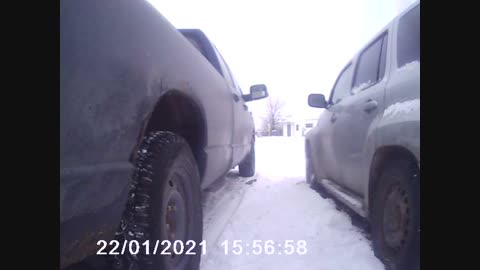

Here a video at very low speed just to show what it do.

It's the best I can do as video, being alone at 40km/h(20m/h).

Thanks for the video. So when the front wheels are locking up does the ABS engauge? (Tapping on your foot?) Is there an ABS light on?

No light on and engage at the end, at almost stop.
