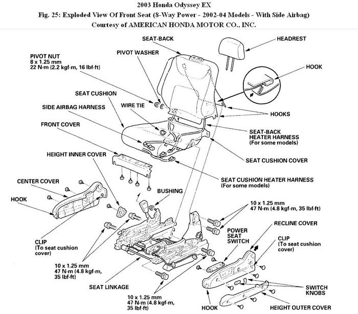

I need to replace the bottom heaters in the front seats of my 2003 Honda Odyssey. Any idea where I can get instructions? How do I get the seats apart?

Is it 8-way power, manual height adjustable or manual seats?
Are you replacing the bottom heater for both front seats?

I have the 8 way power leather seats. Only the bottom heater is not working, the back heater is working on both seats. The passenger seat is a manual seat.

The following diagram should help.
FRONT SEAT DISASSEMBLY/REASSEMBLY - 8-WAY POWER
'02-04 model With Side Airbag
NOTE:
SRS components are located in this area. Review the SRS component locations, (see AIR BAG RESTRAINT SYSTEMS article), and the precautions and procedures (see AIR BAG RESTRAINT SYSTEMS article) before performing repairs or service.
†For '03-04 models The operation of the driver's seat position sensor must be checked after any of these actions (see AIR BAG RESTRAINT SYSTEMS article ).
? Driver's seat position sensor replacement
? Cover plate (front side of driver's seat slide rail) replacement
NOTE:
†Route the seat wire harness correctly (see Front Seat Wiring
Harness Installation ).
†Make sure the bushing and pivot washer are installed correctly.
†Apply multipurpose grease to the moving portion of the seat
track.
†To prevent wrinkles in the seat-back cover, stretch the material
evenly over the pad.
†Replace the back panel clips with new ones.
