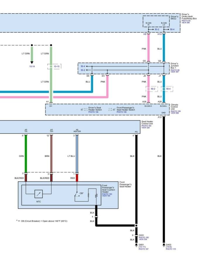

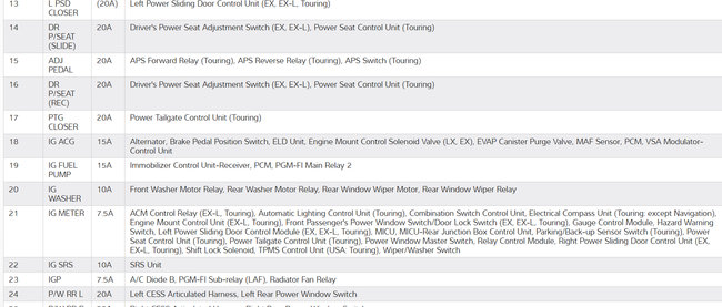

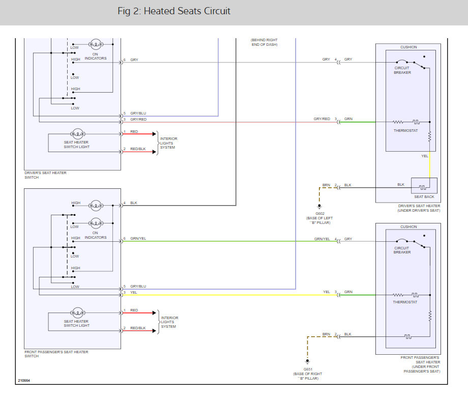

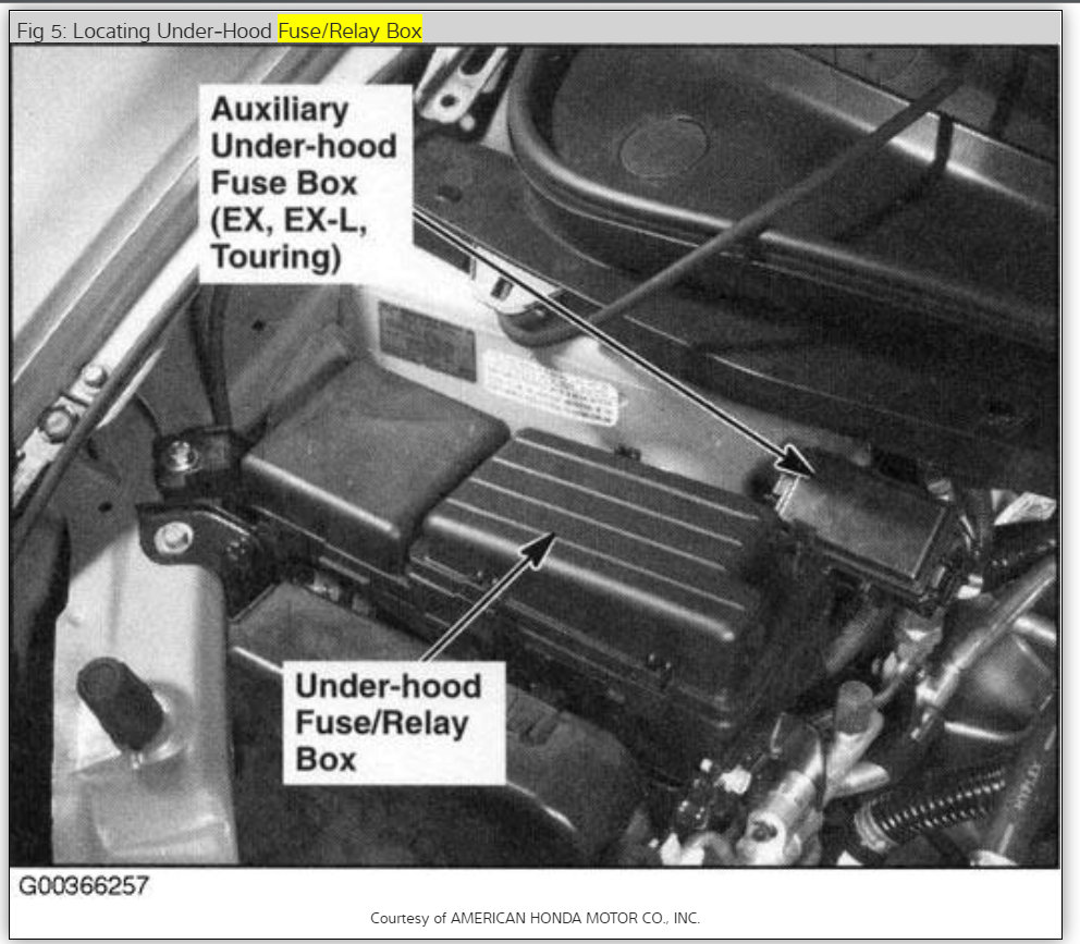

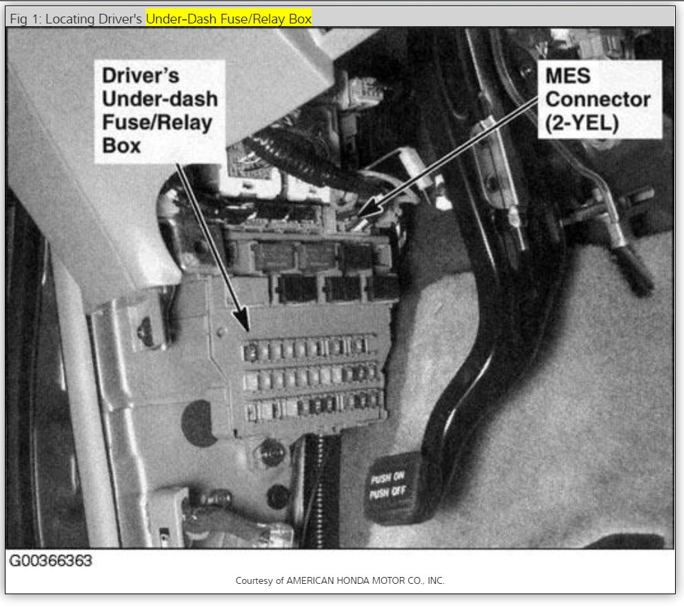

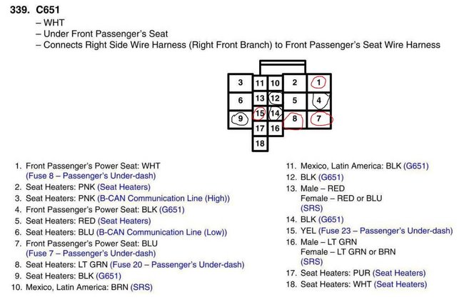

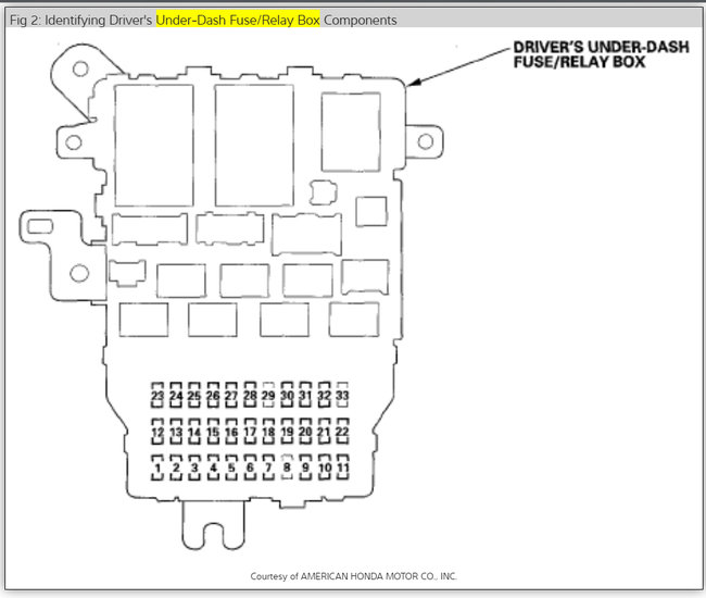

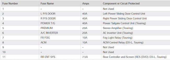

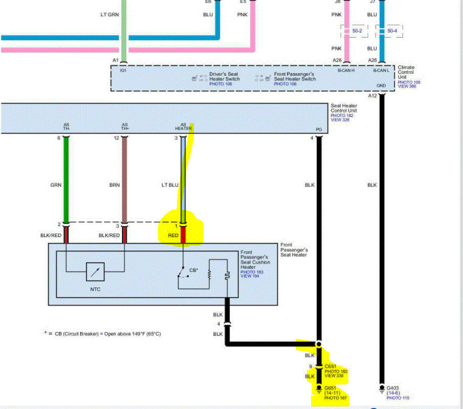

There are a few fuses to check. I attached two pics below. The first shows the fuses. The second pic shows the wiring to the passenger seat.
Based on your description, I suspect either there is a faulty ground for the seat or the switch itself is bad and can not control the load placed on it.
__________________________
I had to provide pics in two parts simply because they are from different pages. However, you can see where the wiring connects from one to the other.

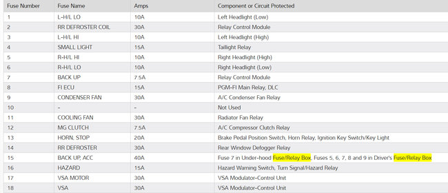

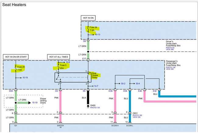

First, check the fuses I highlighted in the first pic. In addition to simply checking the fuse, I need you to confirm there is power both to it and out from it. Here is a link that you may find helpful:

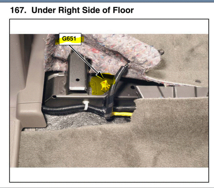

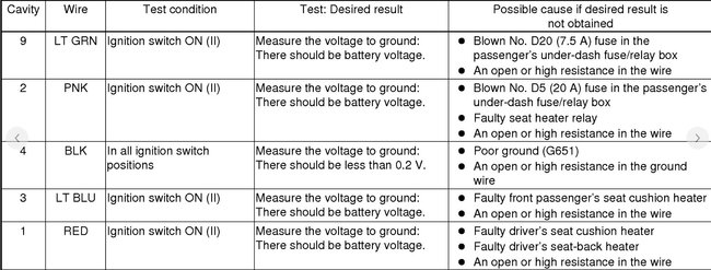

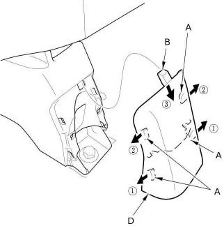

Next, confirm the ground is in good condition. If you look at pic 3, you will see the ground I am referring to. It is under the seat. (G651) Make sure the wire to the ground isn't damaged.

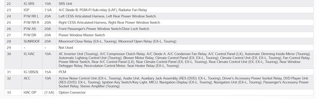

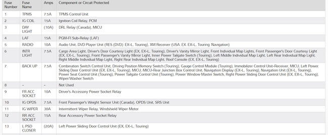

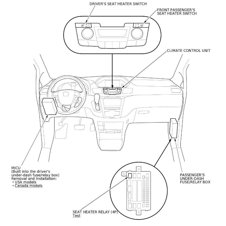

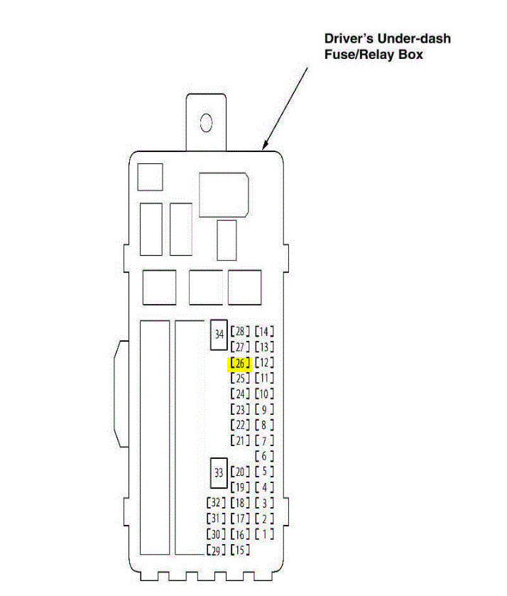

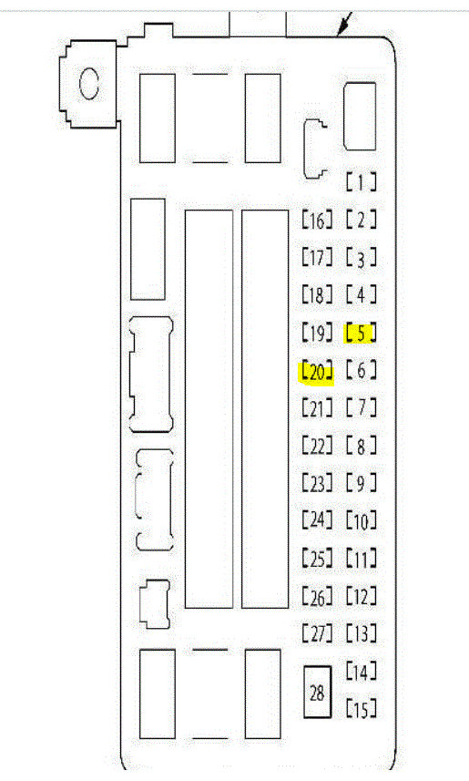

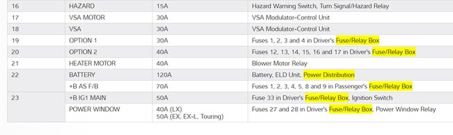

Next, pics 4 and 5 show fuse location. Pic is under the dash, passenger side and pic 5 is the fuse box under the driver's side. I highlighted the fuses to check.
Let me know what you find.

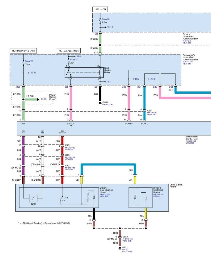

The first thing to check would be the fuses, there are 3 that power the heated seat controller and the seat heating elements. Fuse number 5 and fuse 20 in the passenger side fuse box under the dash and fuse number 26 in the drivers side under dash fuse panel.
Because it is both heaters at the same time I would suspect it is in the control or power feeds and not the elements themselves. The other item to check is the seat heater relay in the same fuse panel as fuses 5 and 20. It turns on when the key is turned on, if you can hear or feel it click when the key is turned on it has the control signal, but it's still possible that the contacts have failed in it. To test that the easiest way is to swap the relay with another one that is working and see if now the seats work and the other system doesn't. The one next to it controls the right rear window and should be the same part number. If you try the window and verify it works, then swap the relay, if the window still works the relay is okay, if it doesn't work the relay is bad, then you just buy a new relay. To test the fuses faster you can use a simple test light. It's easier and shows if there is actually power on both sides, I've seen more than a few fuses that looked good that were not.
It's also possible the seat heater control module has an internal failure. A scan tool like a dealer has would show if there was a fault in that. However I would check the fuses and relay first. Then return and tell us what you found and we can proceed from there.

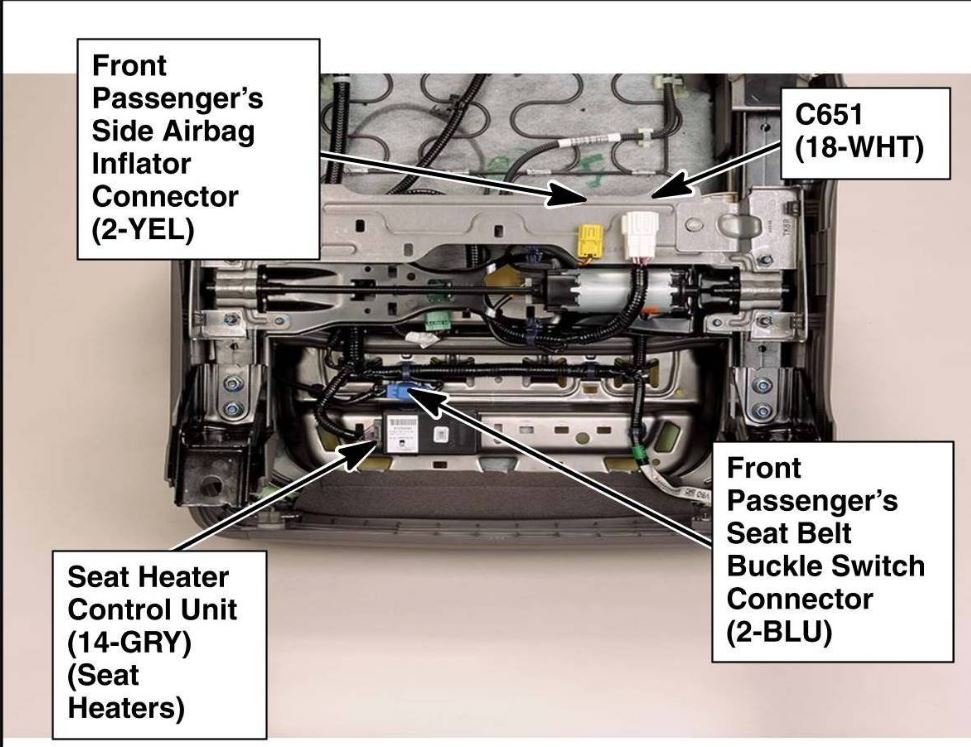

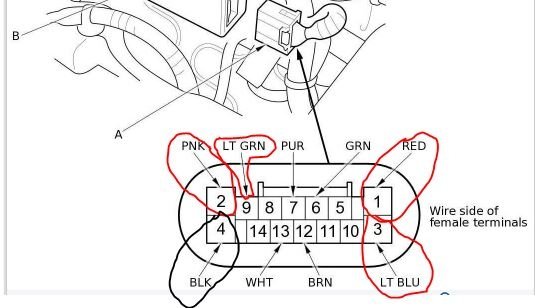

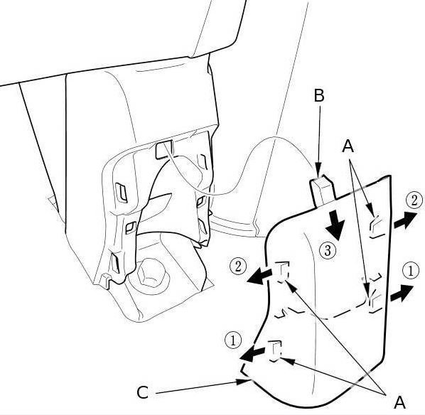

Okay, if the fuses and relays are okay then it is time to test for powers and grounds at the seat control module. The module is under the passenger seat and you will need to remove the seat to get to the wiring connectors for testing. This testing can result in the need to use a dealer level scan tool to reinitialize the passenger side occupant detection sensor as it will be disconnected from the vehicle during the testing.

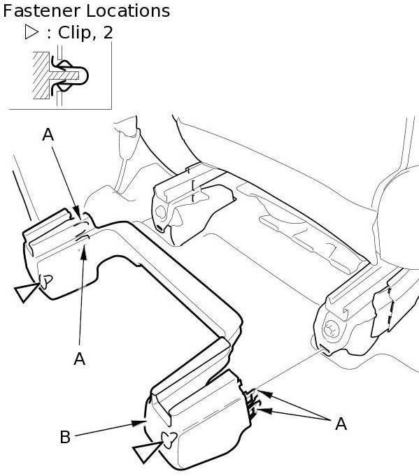

To remove the seat you will need to remove the trim covers on the legs of the seat to get to the 4 bolts underneath them. Pull the seatbelt out some so you can tip the front of the seat up and back to get to the connections shown in the first picture. You will want to access the white connector as well as the gray connector on the seat module. Now using a test light connected to ground you will need to test at the gray connector from the seat heater module for voltage and ground. Do not touch the yellow connector, that is for the airbag in the seat. The chart below tells you what you should find at each of the pins that you test, you will be testing using a back probe method to test the component without disconnecting it. Doing it this way should avoid needing to do any reinitializing of parts. To do back probing you can use a simple probe or even something like a sewing needle that slides into the connection from the outside and makes contact with the inner connection pin. The four connections circled in red should have battery power with the key on. The connection circled in black should be the ground circuit. To test the battery voltage with a test light connect the test light to a good ground and probe the connections. For the ground connect the test light to battery positive and see if it lights up when you probe the black wire. If they all check out then the issue is likely the controller itself. Or the wiring into the white connector C651 on the seat frame. To test there you can use the same testing methods as at the module. There should be power with the key on at the pins in red and grounds at pins 4,9,12 and 14. So in testing say you don't find power on pin 9 with the light green wire at the module if you then test the same wire at pin 8 in the white connector and do find it has power, there is a break in the wire between the two. Or if you don't find battery voltage at either point in testing there is a problem in that power feed between the fuse and the seat harness.

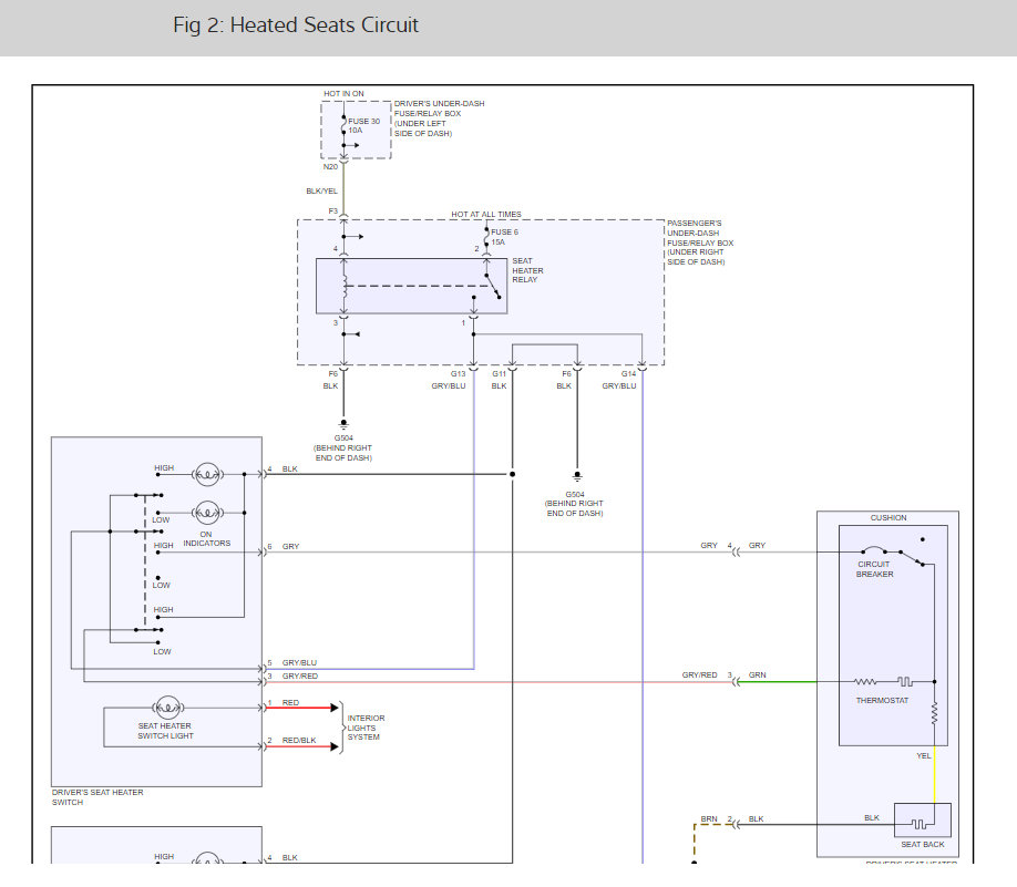

The heated seat on the driver's side has stopped working. The seat on the passenger side works fine. I need to know some troubleshooting methods I can use to figure out where the issue is. Also, the indicator lights on the switch for the heated seats on the drivers side does not light up. The switch has two indicator lights on it, one for High, and one for Low, so when lit, you know that the heated seat switch is on, and if it is on High or Low. Any suggestions on troubleshooting this as well would be much appreciated.
Dec 15, 2020 at 12:12 PM (Merged)
JOHNNYT73
  • 924 POSTS

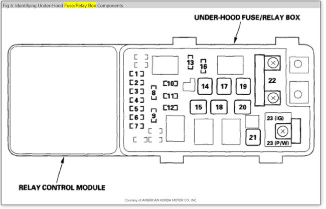

There are two fuses that run the system # 30 (underhood) and # 6 (pass comp) with a relay here is the heated seat wiring diagrams so you can see how the system works and the relay and fuse locations as well. Also here are two guides to help you test the fuse and relay.
and
Check out the diagrams (Below). Please let us know what you find. We are interested to see what it is.

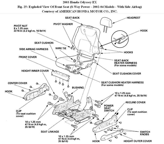

FOCUS4FUN

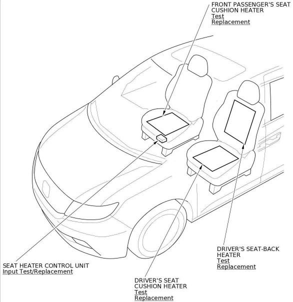

I need to replace the bottom heaters in the front seats of my 2003 Honda Odyssey. Any idea where I can get instructions? How do I get the seats apart?
KHLOW2008
  • 41,814 POSTS
Is it 8-way power, manual height adjustable or manual seats?
Are you replacing the bottom heater for both front seats?
FOCUS4FUN
I have the 8 way power leather seats. Only the bottom heater is not working, the back heater is working on both seats. The passenger seat is a manual seat.
KHLOW2008
  • 41,814 POSTS
The following diagram should help.
FRONT SEAT DISASSEMBLY/REASSEMBLY - 8-WAY POWER
'02-04 model With Side Airbag
NOTE:
SRS components are located in this area. Review the SRS component locations, (see AIR BAG RESTRAINT SYSTEMS article), and the precautions and procedures (see AIR BAG RESTRAINT SYSTEMS article) before performing repairs or service.

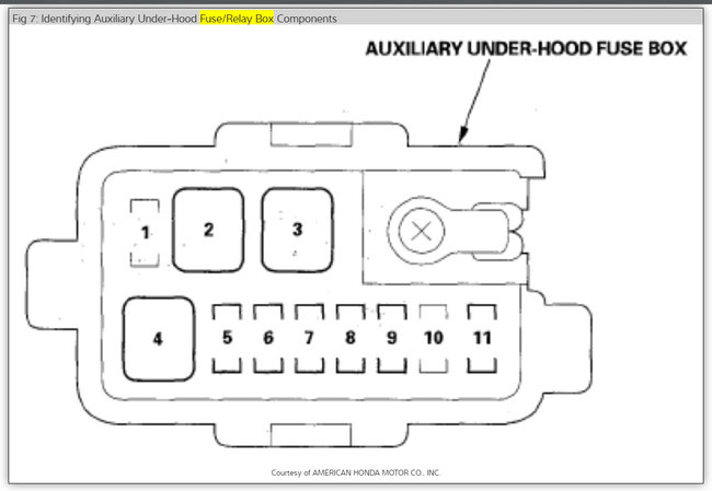

I just purchased a 2003 Honda Odyssey EX-L from a private party. There are switches on the side of both the driver's side and passenger side front seats for the seat warmers. Neither light comes on when the switch is turned to the "on" position and the seats do not heat. I have replaced the 20 amp fuse under the hood which is specifically for the seat heaters. What can I check next? The former owner informed me that it worked in the spring when he last used the driver's side heater.
HONDA TECH 1818
  • 536 POSTS
Did you check the #4 fuse (7.5A) under the dash fuse box?
KHENLEY
I will check that fuse here shortly. Does that #4 fuse control other functions as well? I haven't noticed any other controls (power windows, radio, driver's power seat, etc.,) that didn't work inside the vehicle. I thought that the #8 fuse under the hood was the only fuse that specifically controlled the seat heaters.
