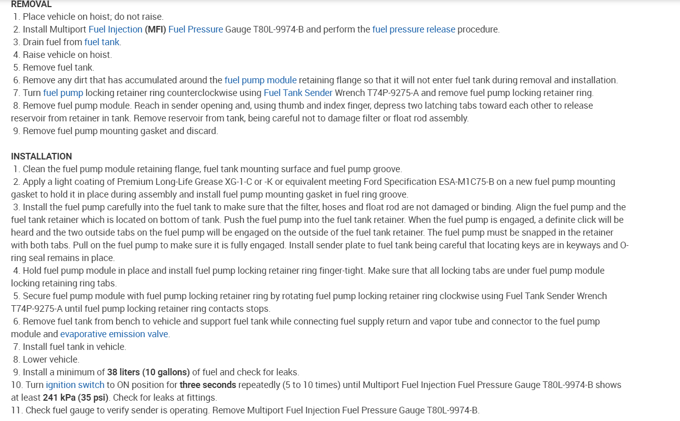

Once the lock ring is off the pump assembly should just raise up out of tank.
1. Depressurize the fuel system and remove the fuel tank from the vehicle.
2. Remove any dirt that has accumulated around the fuel pump module attaching flange, to prevent it from entering the tank during service.
3. Turn the fuel pump module locking ring counterclockwise using a locking ring removal tool or a brass drift and remove the locking ring.
4. Remove the fuel pump module.
5. Remove the seal gasket and discard it.
To install:
6. Put a light coating of grease on a new seal ring to hold it in place during assembly. Install it in fuel tank ring groove.
7. Insert the fuel pump module into the fuel tank, then secure it in place with the locking ring. Tighten the ring until secure.
8. Install the tank in the vehicle.
9. Install a minimum of 10 gallons of fuel and check for leaks.
10. Install a pressure gauge on the throttle body valve and turn the ignition ON for 3 seconds. Turn the key OFF, then repeat the key cycle five to ten times until the pressure gauge shows at least 30 psi.
11. Check for fuel leaks at the fittings.
12. Remove the pressure gauge.
13. Start the engine and check for fuel leaks.

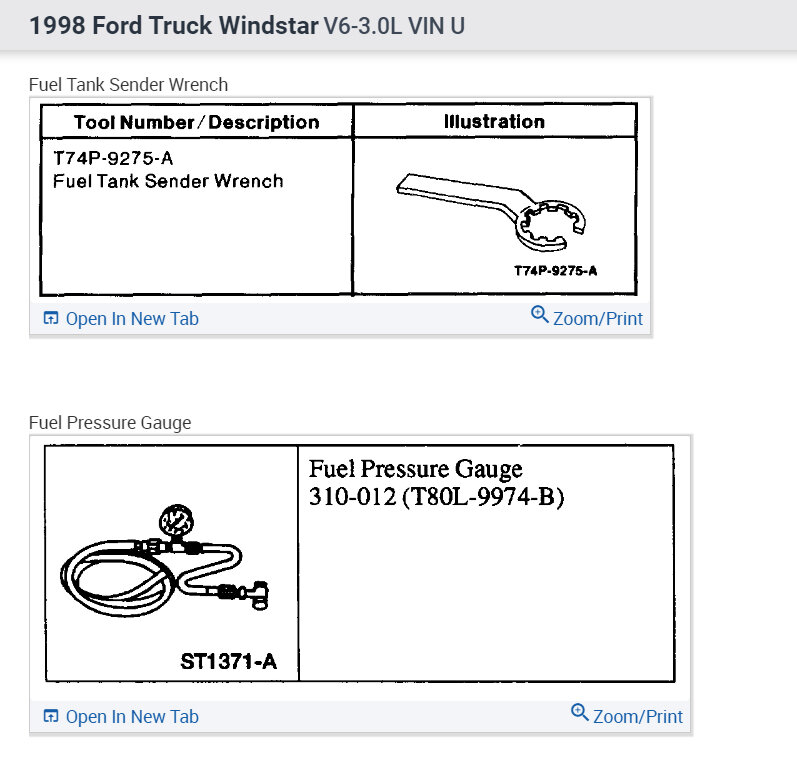

Not really sure what you are having problems with, once the lock ring is off that is all there is to it. It just lifts out, are you certain you removed the lock ring? Check out the images (Below). Please let us know what happens.

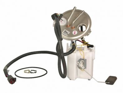

Is the metal top in the pic below what you are referring to as the "housing" ? the pic below is the fuel pump assembly, this is all that should be there. if not then someone may have installed a different pump/tank on the vehicle in the past..

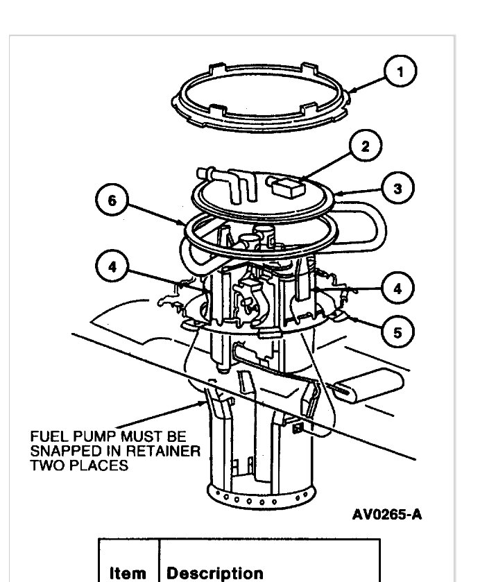

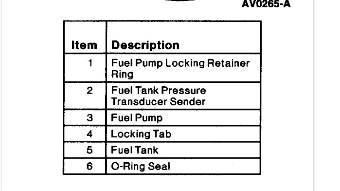

This is a 3.8 liter engine it is similar but not exact the top is plastic and the sending unit is in the tank attached to it as well as the fuel pump. Plus there are 2 lines on the top of the assembly
https://www.2carpros.com/forum/automotive_pictures/508994_P74749M_ANG_1.jpg
this is the exact model
Monday, March 29th, 2010 AT 8:02 PM
2CARPRO JACK
  • 11,533 POSTS
It snaps into the bottom of the tank. If you use a bright flashlight you will be able to see a couple tangs that you pop to release the lower part of the tank unit
