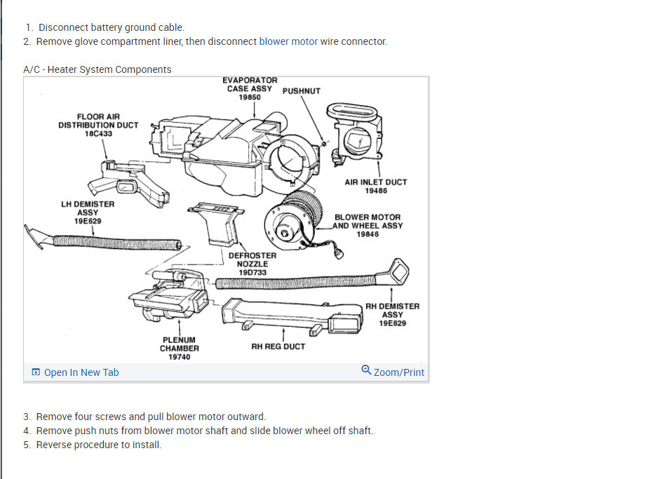

Im trying to find the location of the blower motor

The blower motor is behind the glove box, here are a couple guides that will help with this:
https://www.2carpros.com/articles/blower-fan-motor-works-on-high-speed-only
https://youtu.be/1eau7hCuuJ8
Below you will find the process from the manual on how to replace the motor.
Please let us know if you have other questions on this. Thanks
Image (Click to make bigger)
