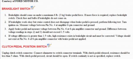

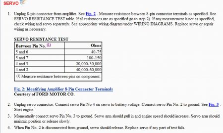

MERLIN2021
  • 17,250 POSTS

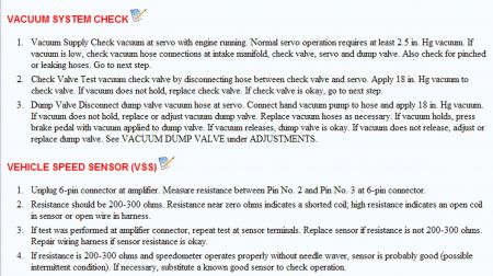

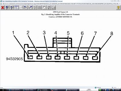

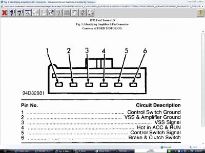

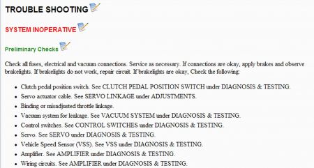

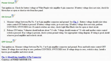

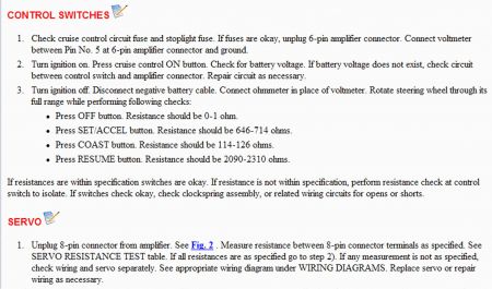

Heres some more testing info for you...
https://www.2carpros.com/forum/automotive_pictures/62217_Wiring_1.jpg
https://www.2carpros.com/forum/automotive_pictures/62217_Testing_1.jpg
https://www.2carpros.com/forum/automotive_pictures/62217_Testing2_1.jpg
https://www.2carpros.com/forum/automotive_pictures/62217_Testing3_1.jpg
https://www.2carpros.com/forum/automotive_pictures/62217_Testing4_1.jpg
https://www.2carpros.com/forum/automotive_pictures/62217_Testing5_1.jpg
https://www.2carpros.com/forum/automotive_pictures/62217_2_1.jpg
https://www.2carpros.com/forum/automotive_pictures/62217_8pin_1.jpg
https://www.2carpros.com/forum/automotive_pictures/62217_1_2.jpg

Hopefully I won't need to use any of the testing data you've generously posted, but it's sure nice to know its there because I'm sure there will be plenty of others browsing or searching the forum who'll be putting up with the same issue, and replacing a fuel filter might not do it for them. I'm still not absolutely certain it's what 'did it' for me. Never underestimate the power of coincidence!
