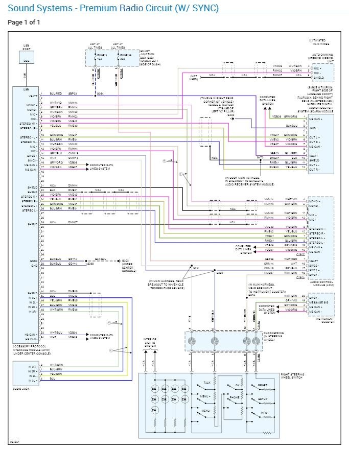

Audio controls on steering wheel of 2008 Taurus X not working How to repair or trouble shoot?
Wednesday, March 24th, 2010 AT 2:05 PM
BMRFIXIT
MECHANIC
19,053 POSTS
Sounds like the "Clock Spring" may be bad. This is the unit that contains the connections between the steering wheel and the vehicle.
Please run down these guides and diagrams and report back
