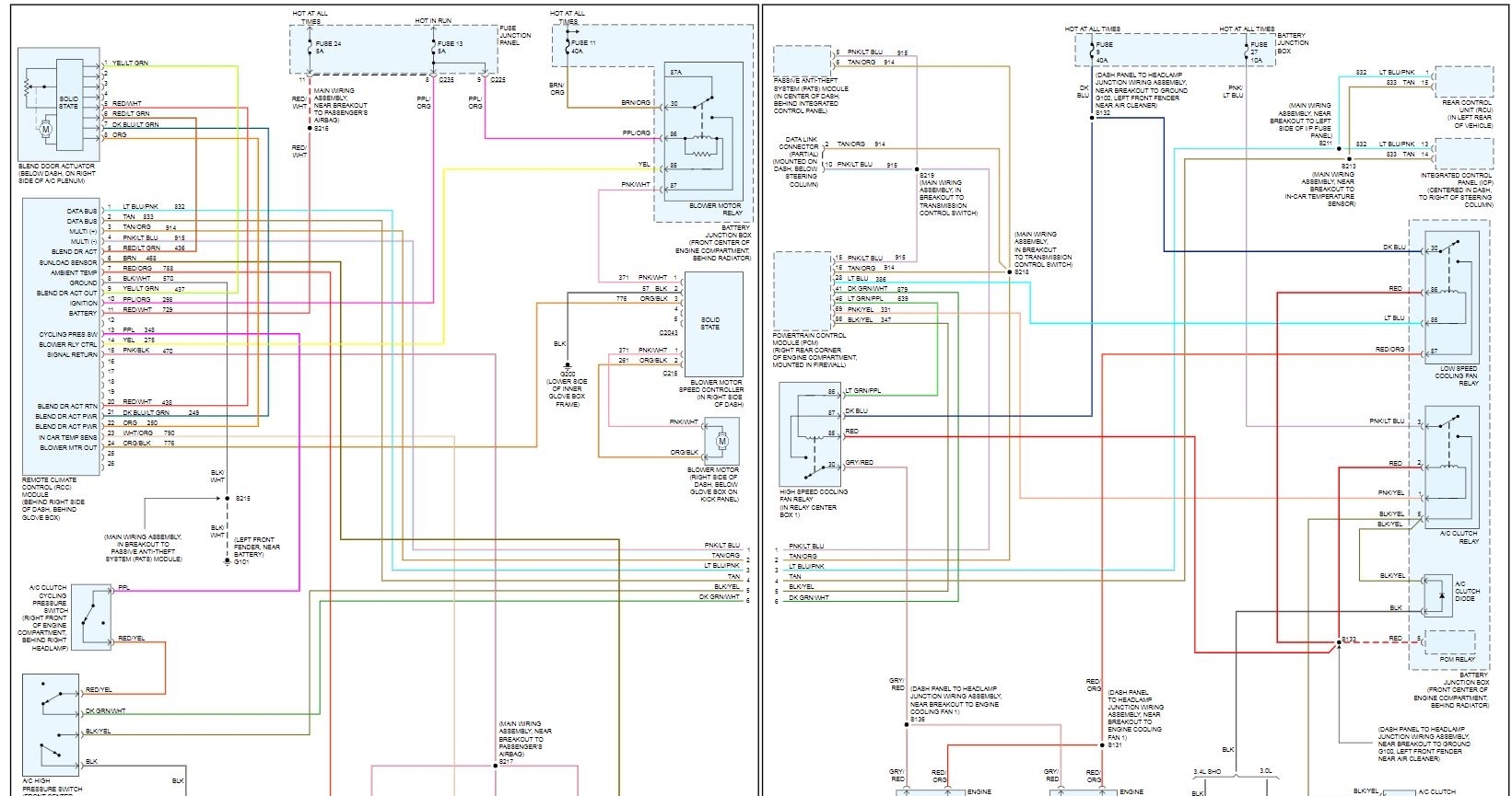

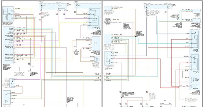

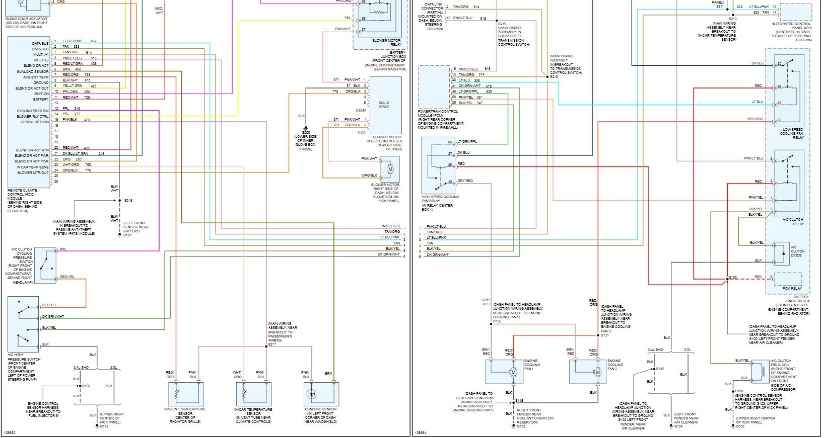

Here is a guide to help with the AC relay in diagrams below.
Check out the diagrams (Below). Please run this test and get back to us.

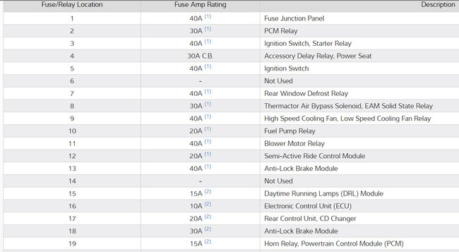

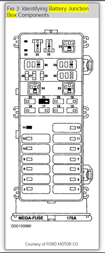

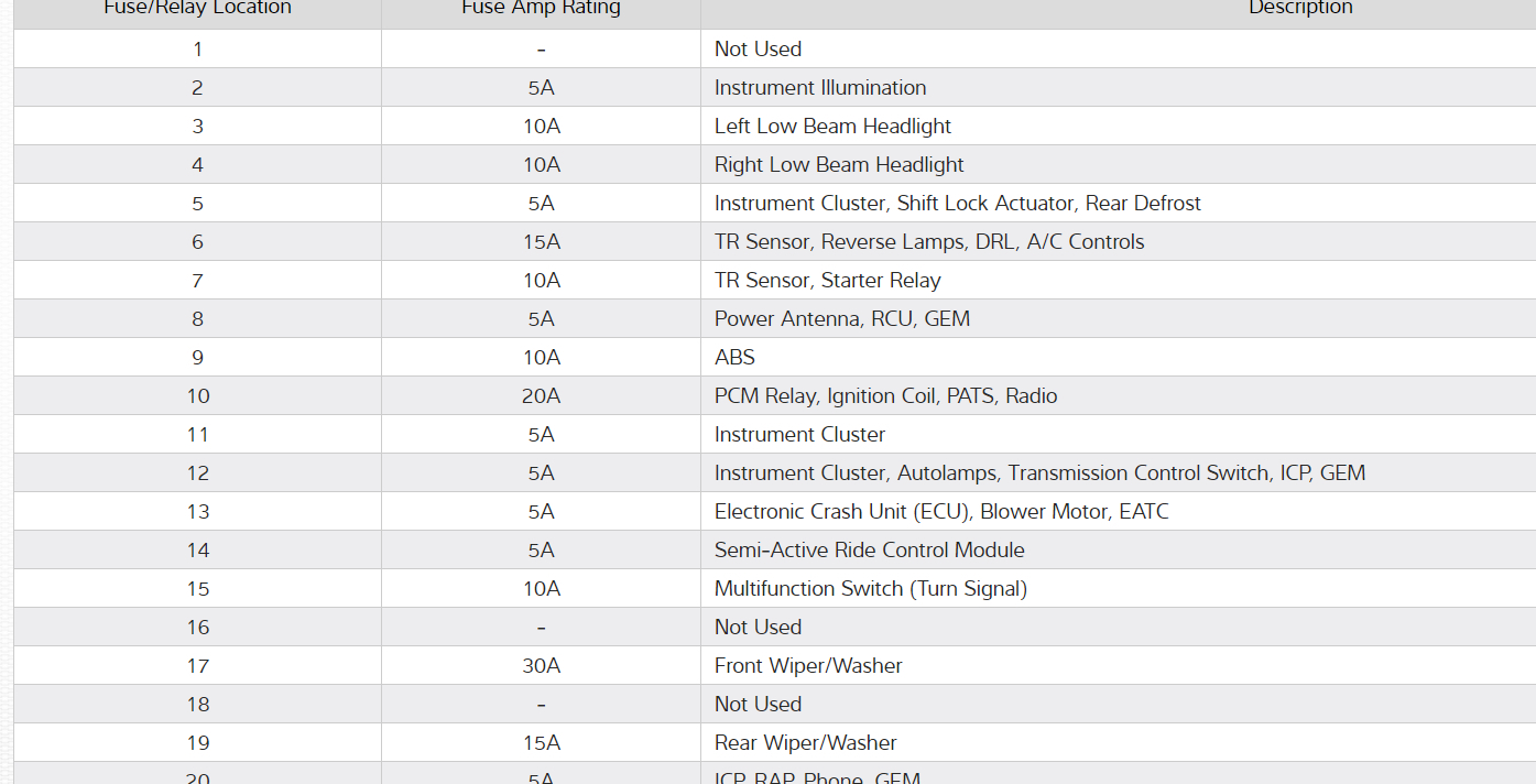

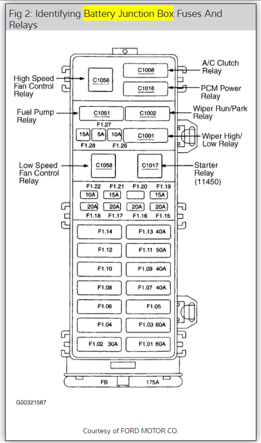

We have replaced the ac compressor, both switches on the ac lines, and can't get the compressor to come on. We direct wired the compressor to charge the system and it worked and cooled. We removed the direct wire. Don't have an owner manuel to help us locate the fuse or the ac relay. Will you help? Curtis
Wednesday, July 28th, 2021 AT 1:03 PM (Merged)
HMAC300
  • 48,601 POSTS

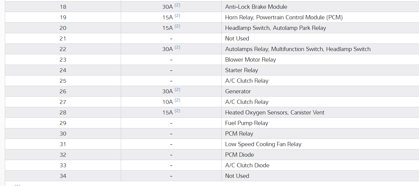

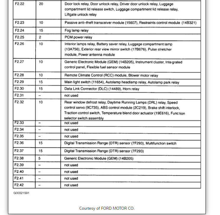

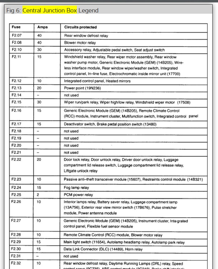

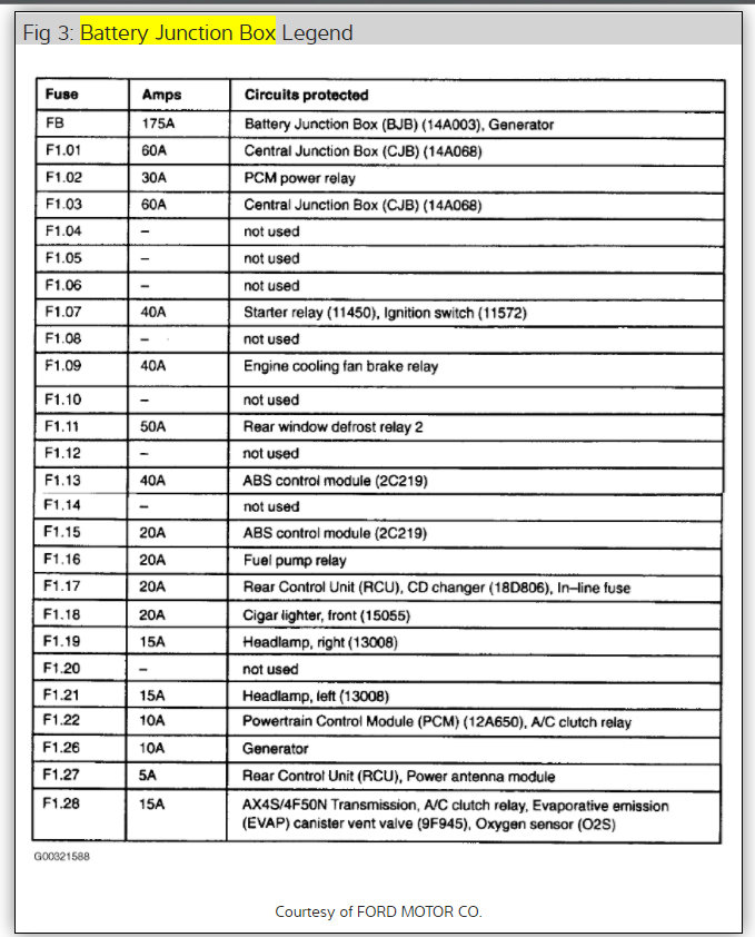

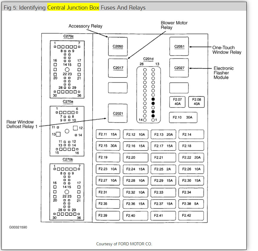

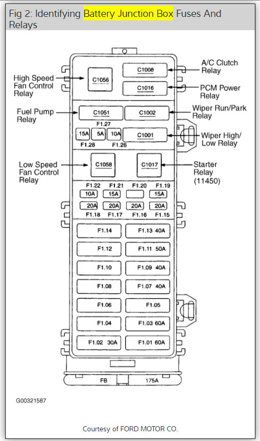

Battery junction box contains relay and fuse as well as diode for ac. Fuse 9 11 and 27. A/c cycling switch must get power as well. Check out the diagrams (Below). Please let us know what you find. We are interested to see what it is.

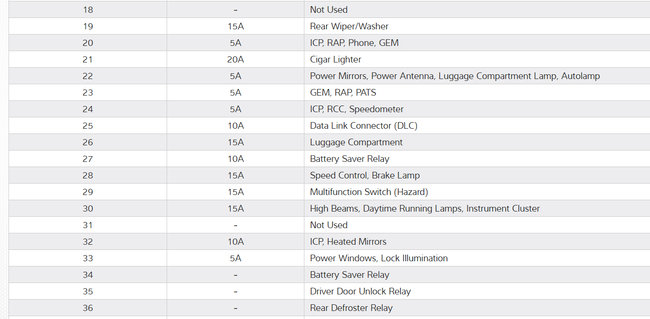

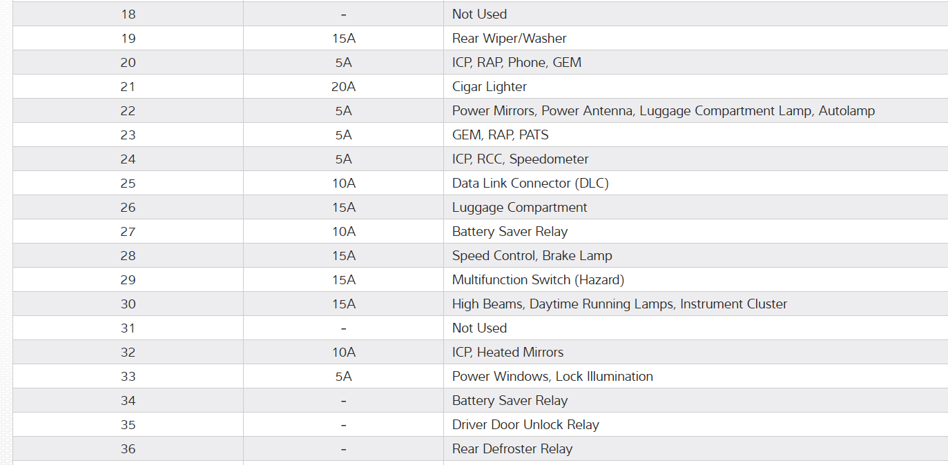

CURTISK1
In the fuse box located on the back side of the radiator support on the left side the # 9 and 11 fuse are good. Do not see a #29.
HMAC300
  • 48,601 POSTS
Yes its by the battery it may be 27
See the wiring diagrams attached below
