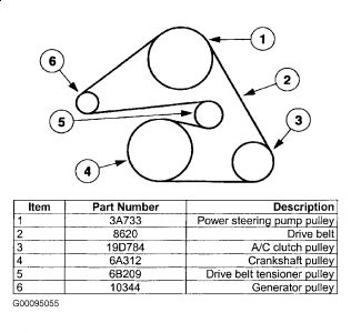

need to have a a/c compressor diagram of a 2004 ford taurus so I can get a isdea of the location of the a/c compressor, thank you

If you have the 24V DOHC VIN S
12V OHV VIN U

Thanks for the response, if I disconnect the ac compressor do you think it will stop the rattling of rocks in a tin can?

If the noise is inside the compressor, maybe. If it is the clutch that is making the racket, then no.
