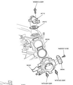

Yesterday I was driving from OH to NC and about halfway I stopped to get gas, and the car didnt want to brake. I had to force it to stop and whenever I started it back up it was revving itself up to 3500rpm, usually sits at 1000rpm. And I put it in park after a little bit and the car was driving itself, went into 2nd gear, then I just took over. I assume its the throttle, but I have no idea where it is or how to fix it.

Did the check engine light come on
and if so check for codes
if no codes check and suspect IAC valve
remove and clean as 1st step

Is it easy to remove and put back? And where would that be located?
Also, I dont know if it matters or not, but the roads were very salty, just wondering if thats the main problem with cleaning that valve.
Also, check engine light wasnt on
Sunday, January 3rd, 2010 AT 9:49 AM
BMRFIXIT
  • 19,053 POSTS
Easy to do
its on the throttle body
secured with two screws
https://www.2carpros.com/forum/automotive_pictures/99387_fan_15.jpg
Sunday, January 3rd, 2010 AT 9:57 AM

I didn't do anything with this yet, going to tomorrow, but do I need to clamp the eletric part off? I read somewhere else that there was coolant going through the TB, or do I not involve the TB at all?
Basically, what tools do I need to fix this?
Also, what solution should I use to clean it out with?
Sunday, January 3rd, 2010 AT 8:13 PM
BMRFIXIT
  • 19,053 POSTS
DO NOT remove the throttle, all you need to remove is the IAC valve on top (in the pic )
plug and two screws
Sunday, January 3rd, 2010 AT 8:21 PM

I cleaned the IAC Valve with TB cleaner, had some gunk in it, I started the car up and still idles around 2k rpm, but whenever I put it in drive its fine which I think is wierd.
But how long should I let the cleaner sit for? And do I wipe it off?
Also I didnt take the plug off, I dont kow where to take it off at and I didnt want to break it
