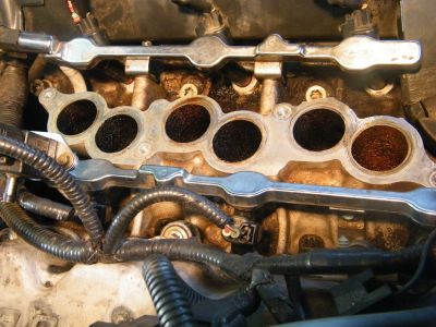

When I'm cruising in my car it often looses power and feels like it's missing. I took it to the Ford dealer and they checked it and said they found nothing except the throttle body and upper intake manifold had lots of carbon buildup. I decided to clean this myself. When I pulled everything I noticed something with the lower intake. The first 5 ports had black buildup inside and the 6th had rusty looking buildup inside. I'm wondering if I might have a hairline crack in the lower intake.
Here is a list of all the components that have been replaced: Plugs, wires, ignition coil, pcv valve, both upstream oxygen sensors, dpfe sensor, egr valve and egr vacuum control solenoid. Thanks for any help you can provide.

It sounds more like the MAF sensor needs to be replaced but to be sure this guide will help

I replaced all the manifold gaskets and the car is still doing the same thing so I did the MAF and that fixed it thank you.

When I'm cruising in my Taurus it often feels like it looses power and feels like it's missing. I took it to the Ford dealer and they checked it and said they found nothing except the throttle body and upper intake manifold had lots of carbon buildup. Another Ford dealer found something not quite right with cylinder 6. I decided to clean the intake and tb myself. When I pulled everything I noticed something with the lower intake. The first 5 ports had black buildup inside and the 6th had rusty looking buildup inside. I'm wondering if I might have a hairline crack in the lower intake.
Here is a list of all the components that have been replaced: Plugs, wires, ignition coil, pcv valve, both upstream oxygen sensors, dpfe sensor, egr valve and egr vacuum control solenoid. Here is a link to the photos of the lower intake. Thanks for any help you can provide.

Were there any codes in the computer?
Looks like coolant had been leaking in. This is the 3.0 pushrod motor I assume. Look at the gasket closely for any failures around that cyl.
