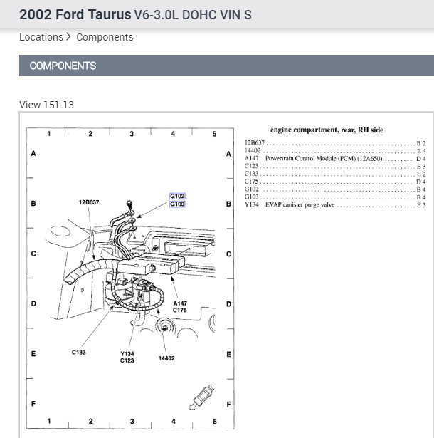

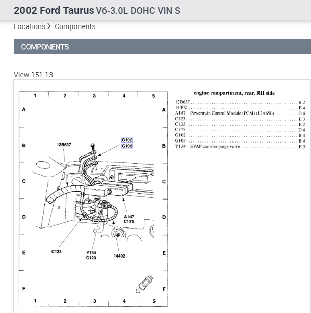

SBABYGIRL
  • 2002 FORD TAURUS
  • 211,233 MILES
It got into a wreck almost two years ago so it's been sitting in my yard since. I
recently have been driving it for the past week. I noticed when I first drove it a really bad gas smell. Then I started noticing it trying to jerk while going into gear on the highway. My foot would get warm through my shoe while accelerating. Two days ago I stopped driving it because it got to where it won't go past 20 mph or go past first gear. I checked the diagnostics and one code popped up for p1633. I have put on a new camshaft sensor, new fuel line, and new fuel filter. Could anyone tell me what could be wrong with my car?
Saturday, August 22nd, 2020 AT 9:53 AM (Merged)
DANNY L
  • 5,648 POSTS
Hello, I'm Danny.
I've attached two pictures below of what to have checked and the PCM location with description. Hope this helps and thanks for using 2CarPros.

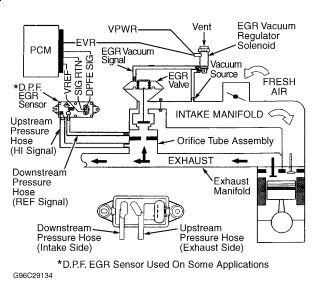

ANDWB24E
  • 2002 FORD TAURUS
2002 Ford Taurus
MY HOSE THAT CONNECTS TO THE EXAUST KEEPS POPPING OFF AND WHEN I DRIVE THE SPED WONT GO OVER 35 MILES. WHAT COULD I NEED?
BMRFIXIT
  • 19,053 POSTS
DPFE hose?
Need to be replaced
check for an exhaust restriction
