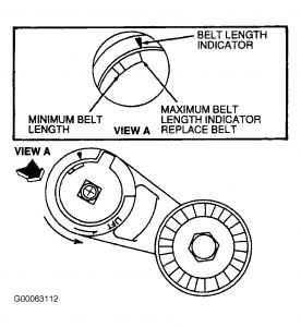

The motor started to squeal a bit back I replaced the belt the water pump and the idler pully it still squeaks really bad any answers for me
Thursday, January 15th, 2009 AT 6:50 PM
BMRFIXIT
  • 19,053 POSTS
Spray the belt does the squealing stop and or change
and if so get a different belt
check belt tensioner
https://www.2carpros.com/forum/automotive_pictures/99387_Graphic1_159.jpg
https://www.2carpros.com/forum/automotive_pictures/99387_Graphic2_79.jpg
https://www.2carpros.com/forum/automotive_pictures/99387_Graphic3_36.jpg
